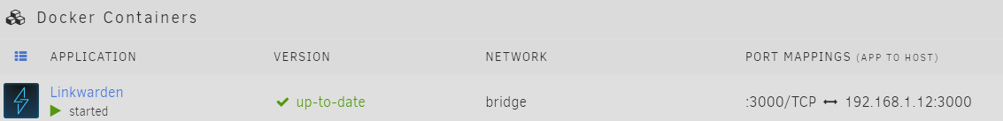

August 18, 20242 yr I'm having the same issue as other users here.. the IP isn't getting bound correctly. The port mapping section in the docker list is blank and the logs clearly show: url: http://localhost:3000 even though I've changed the container IP and the NEXTAUTH_URL address. Due to the mac-vlan issues on Unraid, I only use static IPs on containers, so unless the IP bindings can be fixed, I simply can't use this. Which is a shame.. I'd really like to migrate off Raindrop.
August 19, 20242 yr I got it working w/o any problem on Unraid. Maybe you can find some help in my configuration. First setup the Postgres DB, then configure Unraid Container with settings; Network Type: Bridge Console Shell Command: Shell WebUI: 4344 NEXTAUTH_SECRET: (default) NEXTAUTH_URL: http://192.168.1.20:4344/api/v1/auth DATABASE_URL: postgresql://[pg_user]:[pg_pass]@192.168.1.20:5432/linkwarden Data: (default) Afterwards I configured Cloudflaretunnel, no problems. Edited August 19, 20242 yr by hennio
