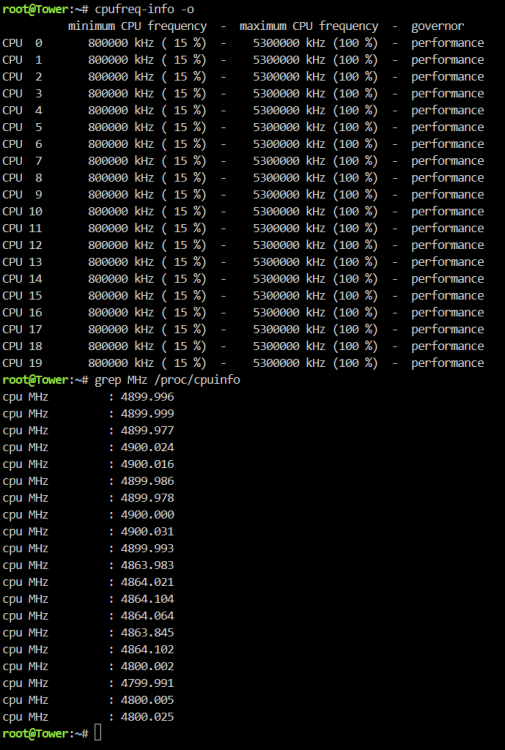

I started the Unraid Server in normal mode and disabled VMs and Dockers and stopped the Array.
I also started a stress test. It´s running since 17:35. So about 1 hour for now. Server is still running. CPU Temp 72 C and the cpu Mhz is @ 4899.996 Mhz
stress --cpu 20 --vm 125 --vm-bytes 1024M

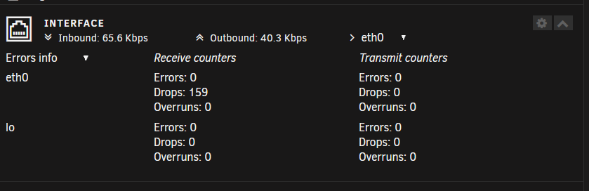

I can just see a lot of Network drops. Is that Normal?
Edited by UNRA1DUser
It can be, I wouldn't worry about that for now.

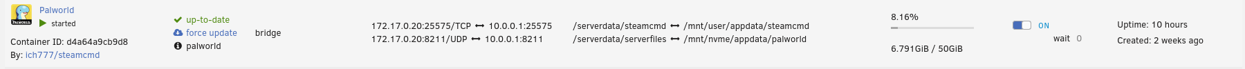

I can't reproduce this, my container is now running for about 10 hours and it's working fine, I restart it every 24 hours:
As you can see in the screenshot I'm running it with a 50GB cap and have no issues whatsoever.
