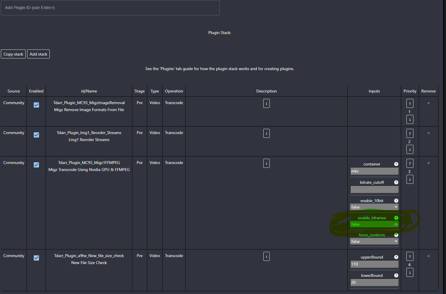

  21. Hi, I found out the bframes option was on because I had a RTX3060 before in my server, but replaced it for a P2000. The P2000 does not support frames. After setting it to false, I get transcoded files again!
