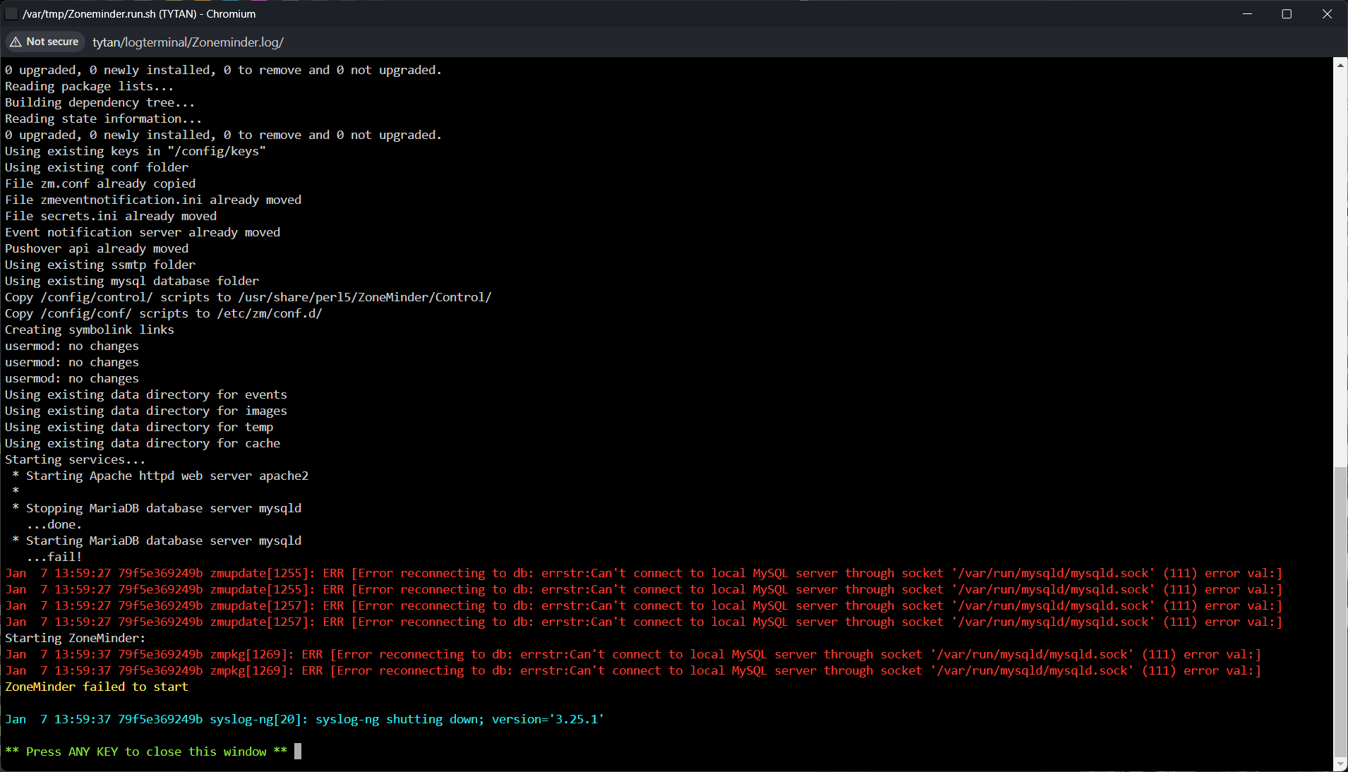

  4. So, it appears lots of tables in InnoDB got corrupted somehow. I found clues in /var/log/mysql/error.log I tried to force an InnoDB recovery but never got it to work. Instead I bypassed InnoDB by skipping it using "skip-innodb" and "default-storage-engine = myisam" under [mysqld] in my.cf and mysql finally starts, however, is seems ZoneMinder is reliant on InnoDB and wont start because of it. I guess it's possible to do a backup now since mysql is started, but I will instead just try and delete the whole thing and reinstall from scratch since my ZM install isn't that big. Edit: My issue is solved. I deleted /appdata/ZoneMinder/mysql in the docker image and redeployed and now everything starts fine.
