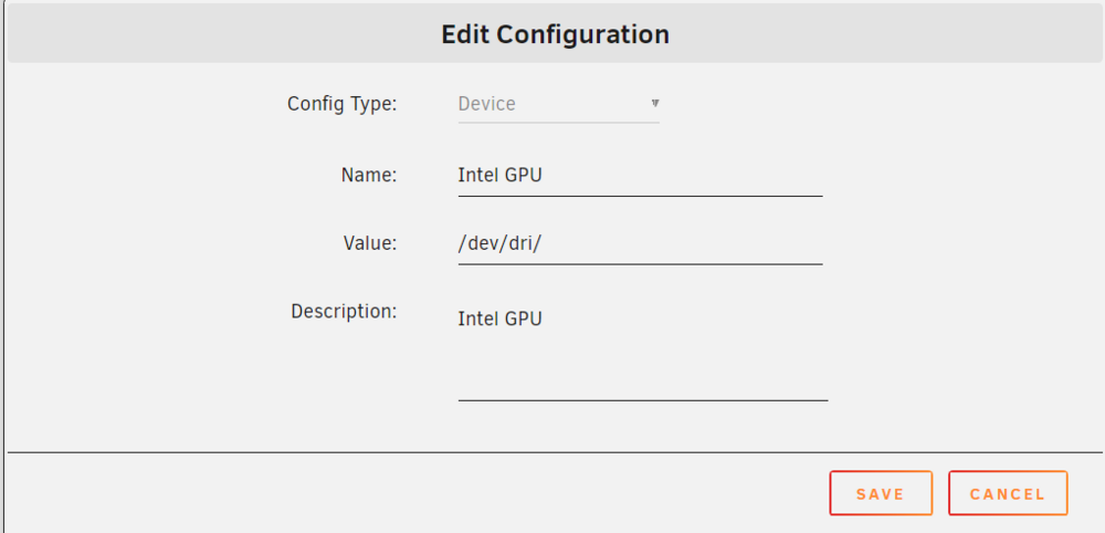

Hardware Acceleration: Intel hardware acceleration is enabled in the Zoneminder Container.
Follow these steps to enable Zoneminder to use it:
  • Edit the Zoneminder template.
    • Enable advanced view.
    • Add '--device /dev/dri:/dev/dri' to the 'Extra Parameters'.
    • Click Apply.
  • Go to each Camera->Source.
    • Enter 'vaapi' as the 'DecoderHWAccelName'.
    • Enter '/dev/dri/renderD128' as the 'DecoderHWAccelDevice'.

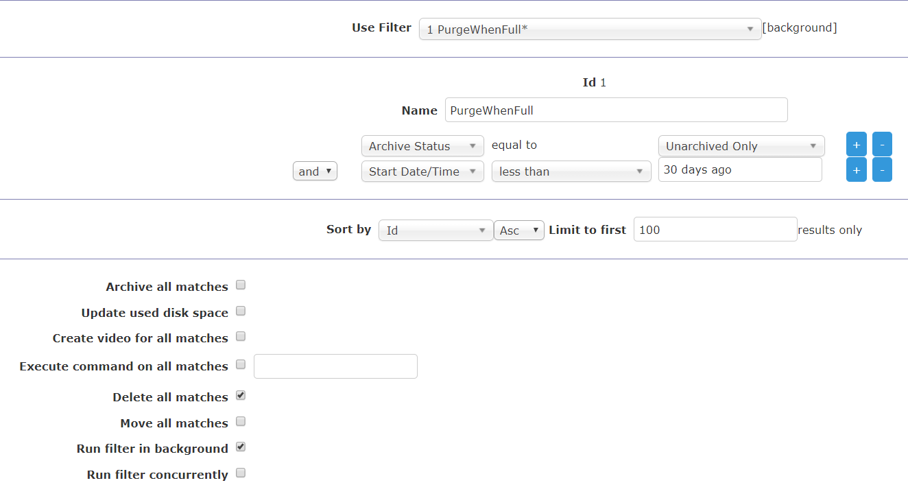

Note: The default purge 'Filter' is set for 50% of the disk where the Zoneminder data is stored.  On Unraid this is not a good way to manage the growth of the events.  I recommend setting up a purge filter based on the age of the events.  This is the way to set up a filter to purge events by age:
This filter purges events older than 30 days.  You can set the 'days ago' to a value that makes sense for you.

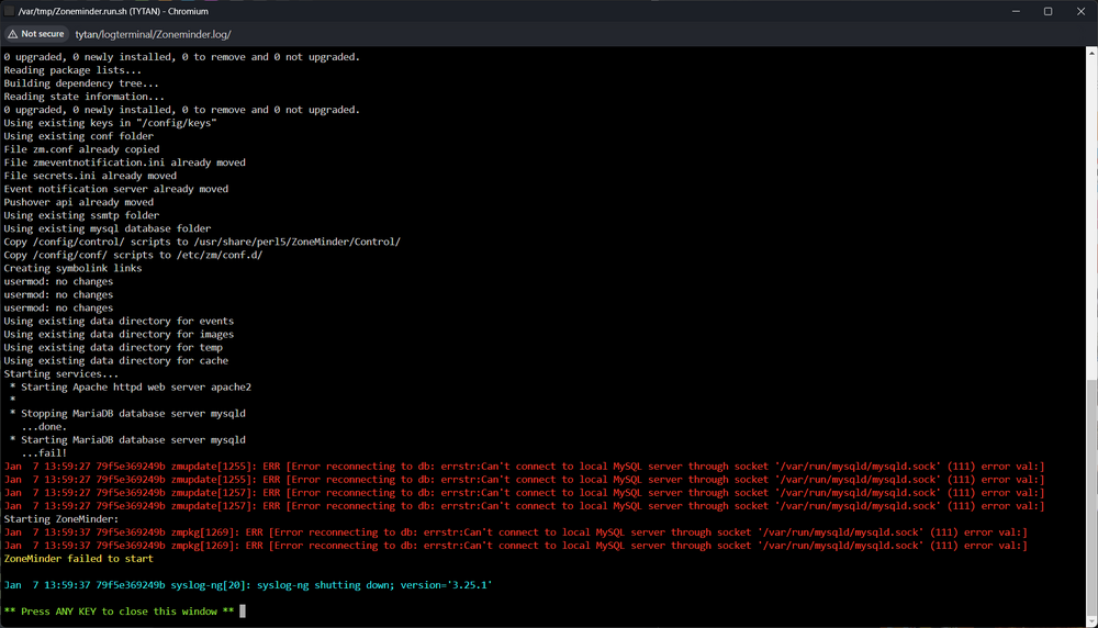

Troubleshooting when the container fails
If you have a situation where the container fails to start, you can set NO_START_ZM="1" as an environment variable - this will spin up the container but will not automatically start the MySql and Zoneminder processes. This way, you can get into a command line in the container (docker exec -it Zoneminder /bin/bash) and troubleshoot your issue by using the following commands to start MySql and Zoneminder and fix any errors/problems with them starting.
service mysql start
service zoneminder start
