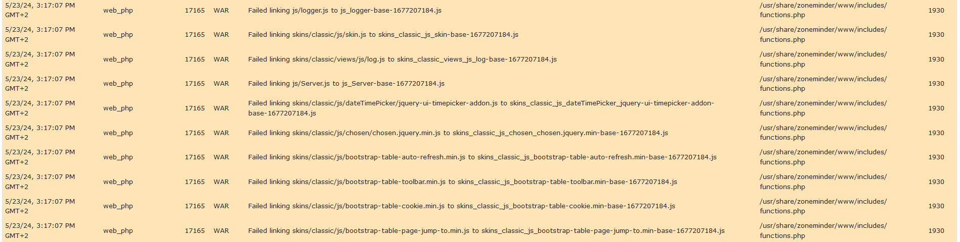

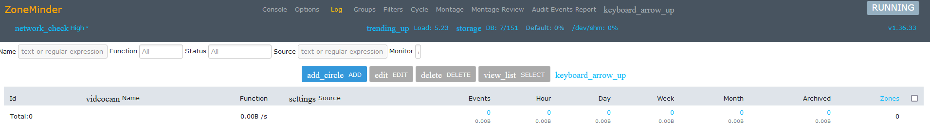

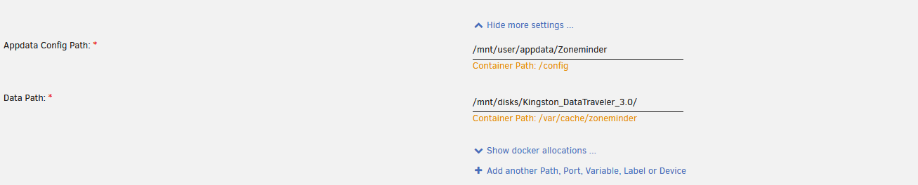

Sorry, i couldn't find the answer to my problem in this thread. Problably iam just overseeing something since iam relativlely new to unraid:
i installed Zoneminder. i chose an unassigned device as my data path (for testing its just a USB drive, which will later be replaced by something stable).
The "data folders" are created in the USB drive.
here is my problem: When i open the WEB GUI some symbols are not shown:
the logs in zoneminder look like this:
If i install Zoneminder in default settings, the symbols show normal.
What am i missing?
Thank you in advance!
regarding my question above:
i found this in the Zoneminder forum. i think this might be the solution, but since my linux knowledge is limited unfortunately, iam not not sure how to translate this to my setup

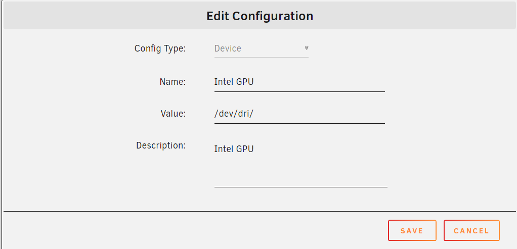

I got iGPU enabled, for intel/vaapi.  Personally I don't have much need for it, as I write only alarms via camera passthrough; encoding just puts more load on the server.  But if someone has a need for it, below may help you enable it.  Note when the docker image is updated your changes will be overwritten and you'll have to do this again so you may consider disabling auto updates for Zoneminder if you're going to use this.
This assumes you have all the i915 gpu bits in place on your host server (check with lsmod | grep i915 or confirm /dev/dri/renderD128 is there)
First, edit Docker->Zoneminder to add a device with value /dev/dri
Then open console for Zoneminder and run these commands (this is what worked for me and your mileage may vary):
apt install -y vainfo
apt install -y intel-media-va-driver-non-free
groupadd -g 110 render
usermod -a -G video www-data
usermod -a -G render www-data
check to see if it works with:
vainfo
Then configure your cameras in Zoneminder under Source:
DecoderHWAccelName : vaapi
DecoderHWAccelDevice : /dev/dri/renderD128
Then under Storage:
Video Writer: Encode
and pick your flavor of vaapi encoding.

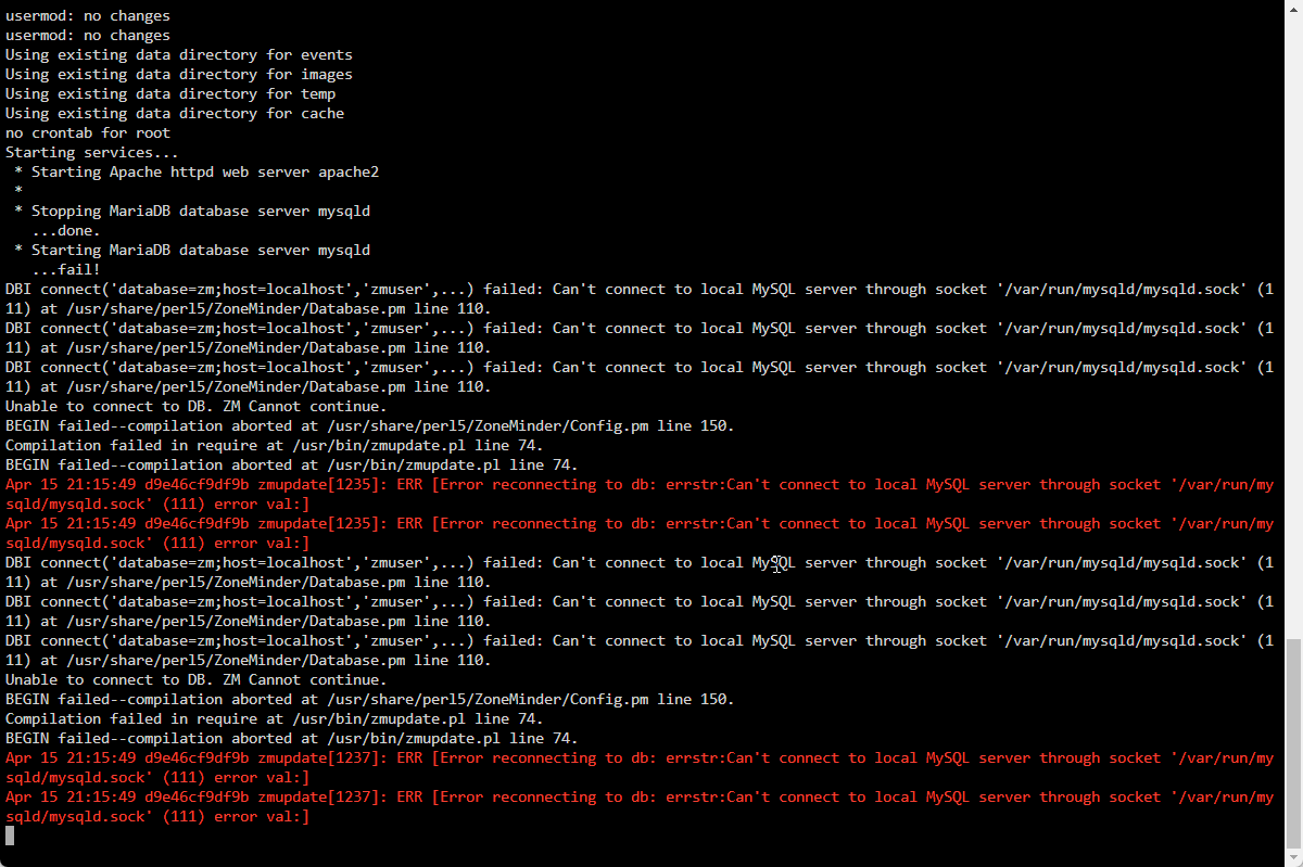

So i'm getting this, even after a force update.
Starting services...
 * Starting Apache httpd web server apache2
 * Stopping MariaDB database server mysqld
   ...done.
 * Starting MariaDB database server mysqld
   ...fail!
Nov 11 17:23:12 ec7cfa545f99 zmupdate[25080]: ERR [Error reconnecting to db: errstr:Can't connect to local MySQL server through socket '/var/run/mysqld/mysqld.sock' (2) error val:]
i was having problems before this but it brought down my unraid server, thankfully the server is fine now but the DB is corrupt. How can i tell if the DB is local or if its on my instance of MariaDB? I looked at the databases on my Maria install and dont see any db there that could be zoneminder.  I do have backups of the appdata folder.  Can i rebuild? Or worst case, can i export/save my settings for a reinstall?
Is there an option to add a variable to take advance of a GPU card for zoneminder container (similar to what Plex has ?)
Yes, add a Device:Screenshot 2024-12-12 121130.png
i have the same problem. deleted docker / image, but problem remains:
   ...done.
   ...fail!
DBI connect('database=zm;host=localhost','zmuser',...) failed: Can't connect to local MySQL server through socket '/var/run/mysqld/mysqld.sock' (111) at /usr/share/perl5/ZoneMinder/Database.pm line 110.
Unable to connect to DB. ZM Cannot continue.
BEGIN failed--compilation aborted at /usr/share/perl5/ZoneMinder/Config.pm line 150.
Compilation failed in require at /usr/bin/zmupdate.pl line 74.
BEGIN failed--compilation aborted at /usr/bin/zmupdate.pl line 74.
Dec 21 19:42:45 65425e020f89 zmupdate[12715]: ERR [Error reconnecting to db: errstr:Can't connect to local MySQL server through socket '/var/run/mysqld/mysqld.sock' (111) error val:]
Dec 21 19:42:45 65425e020f89 zmupdate[12716]: ERR [Error reconnecting to db: errstr:Can't connect to local MySQL server through socket '/var/run/mysqld/mysqld.sock' (111) error val:]
best regards
   ...done.
   ...fail!
best regards
Got the same problem over here. Tried force update and removing the container + image, no dice.
Edited by SolidFyre
For both of you mysql is failing to start for some reason. If you follow the instructions here and try and start mysql manually it should hopefully give you more info on why it isn't starting.
root@be13dde773f2:/# service mysql start
 * Starting MariaDB database server mysqld                                                                                                 [fail]
root@be13dde773f2:/# service zoneminder start
Starting ZoneMinder:
DBI connect('database=zm;host=localhost','zmuser',...) failed: Can't connect to local MySQL server through socket '/var/run/mysqld/mysqld.sock' (2) at /usr/share/perl5/ZoneMinder/Database.pm line 110.
