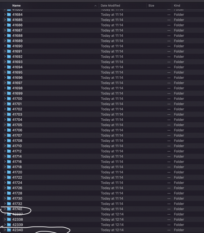

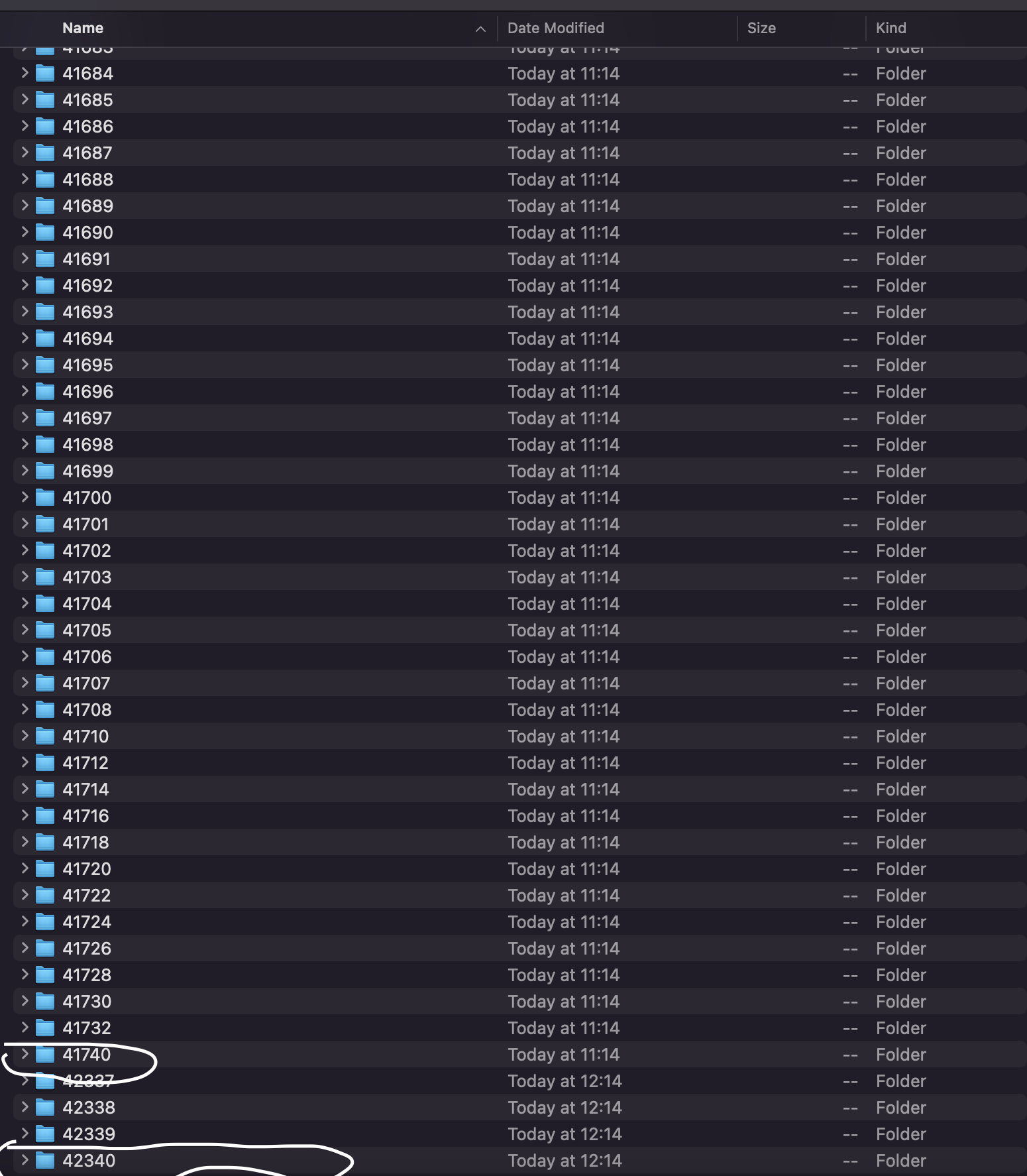

Someone know why zoneminder create several event directory when begin a new video all under 1MB with the timesize from 2 seconds to sometime 2 hours that is a still image with up to 2 seconds moving image at the end, only the marked directory from the below print screen have the one hour length as I set it, but sometime the video is only 15 minutes, other times is 2 hour, the rest have the same 2 seconds to 2 hour video for each hour under 1MB in size, sometime only artefacts, the directory for that date is full of such kind of event folders, at each good video 10-20 event directory's are under 1MB video.
I disabled detection on Mocord, I enable it and the same result, on other modes is more than a mess, no one can distinguish what is doing :)
The machine is an Intel 7700 with 16GB RAM, storing on a 3TB WD HDD total RAM usage about 31%, the setup is No encoding/pass thru, minimum buffer 3 maximum 20, with decoding for monitoring, cameras setup to output 10FPS's at 1080p h264, 8 cameras + one that is h265AI because has no h264 option pass thru as well.
This issue appeared in about last two updates, I used the same cameras in older versions and no issue like that encountered, only that last several releases after each update the database is corrupted and need a fresh reinstall.
The Unraid version is: 6.9.2 stable
