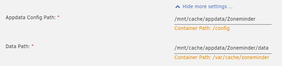

Partial-nubie here and I am a bit confused on the storage paths.  First off, my system is up and running but I need a bit of education.
My docker path:
But when I look in Storage under Options in the Zoneminder it has this (which does not exist -  leastwise according to krusader):
If I put the Docker data path "/mnt/user/Media/Zoneminder/" as the Default in Options I get errors:
So the system is working but I have no idea how.  Here is the actual paths (cache & shares) according to krusader:
So the question is: is the value in Options => Storage => Default correct or should it match the data path and what the hades is the path in the Default?

/var/cache/zoneminder/events is inside the docker and not visible to Unraid.
/mnt/user/Media/Zoneminder/events is in Unraid and not visible to the docker container.
They are mapped with these settings in the Zoneminder template:
This gives the Zoneminder container access to the Unraid folder.
Don't change the storage setting in Zonemnider.  As you found out it doesn't work because that path is not in the container.  Leave it at the default.

Good day,
Today installed Zoneminder docker, and ofcourse read the descriptions.
It says to select half my memory for SHM size, but i can't find the reason for this?
And in all honesty . . . since ill be sporting 128GB of memory soon, wouldn't 64GB of memory be a bit much?
2 hours ago, Caennanu said:
Good day,
That memory is not really used unless it is needed.  You could probably just set 16GB and be fine.
