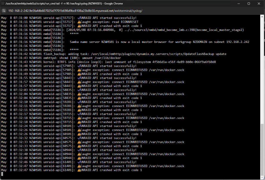

Docker Service failed to start. Caught exception: connect ECONNREFUSED /var/run/docker.sock
Also having this issue. Version 6.12.10 2024-04-03 I will add a diagnostics shortly(Just added) nzwhs01-diagnostics-20240508-0745.zip nzwhs01-diagnostics-20240508-1629.zip

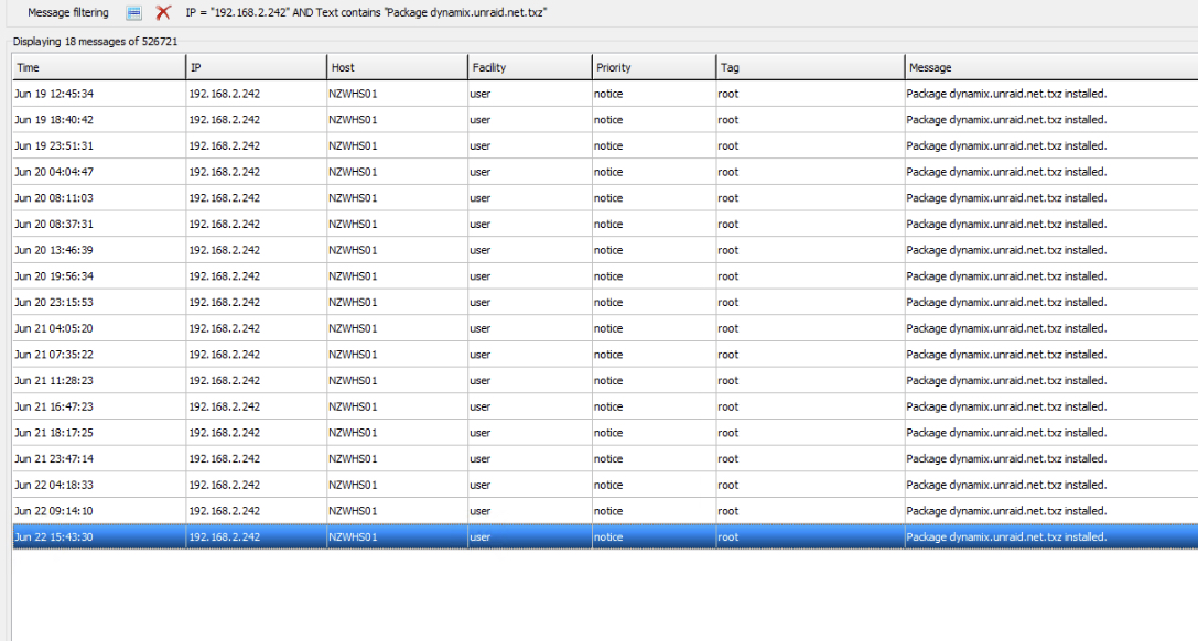

Upgraded from 6.11.5 to 6.12.0 and then had to revert back to 6.11.5 - Server crashes every 1-8 hours

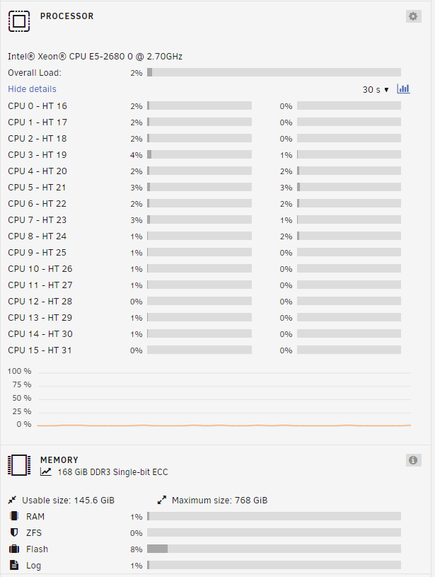

i cannot conclude much at this point. Someone is telling me that I am likely experiencing kernel panics and that I should be doing a memtest for 24 hours to see. I am not at that point yet because with 168GB of RAM, that memtest is pretty painful

Update! currently at 9h15minutes of uptime and server has not rebooted randomly. So there might be a plugin that is causing me grief in 6.12.1. Suggestions? Should I: a - stay in safe mode with plugins not running and turn on docker service which will then start up all my containers? or b - reboot to get out of safe mode, leave Docker service off, start enabling plugins (assuming I can even do that) 1 by one and wait on each plugin to see? or c - something else

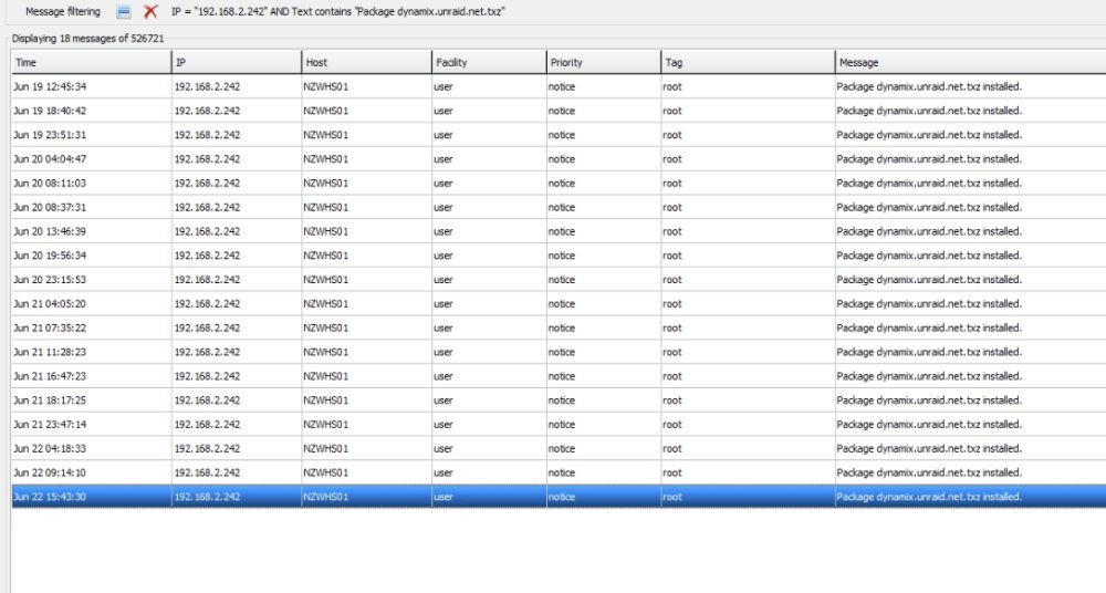

In my case, the most stability that I have is the following and going on 6 hours and 6 minutes of uptime: VM service off Docker service off Rebooted to safe mode(effectively ruling out all plugins), added passphrase for encrypted disks so file systems and disks mount Since I do not use the server shares in this way and I must have my containers and vm's running... this is not really a workaround for me. Waiting for guidance on what I should do next.... Like at this point is looks like maybe a bad plugin is causing the server to reset. Nothing obvious in the syslog. So not even sure if there is an option to increase logging to possibly catch the issue? my iLo4 board just sees the server reset... no power cut, nothing... no hardware errors... nothing...

Sharing some files in case someone sees something....syslog (3)nzwhs01-diagnostics-20230623-0931.zip No reboots left but since teh last reboot to safe mode was at around 8:45, the next unexpected reboot should be around 12pm-1pm (Around the 4 hour mark.

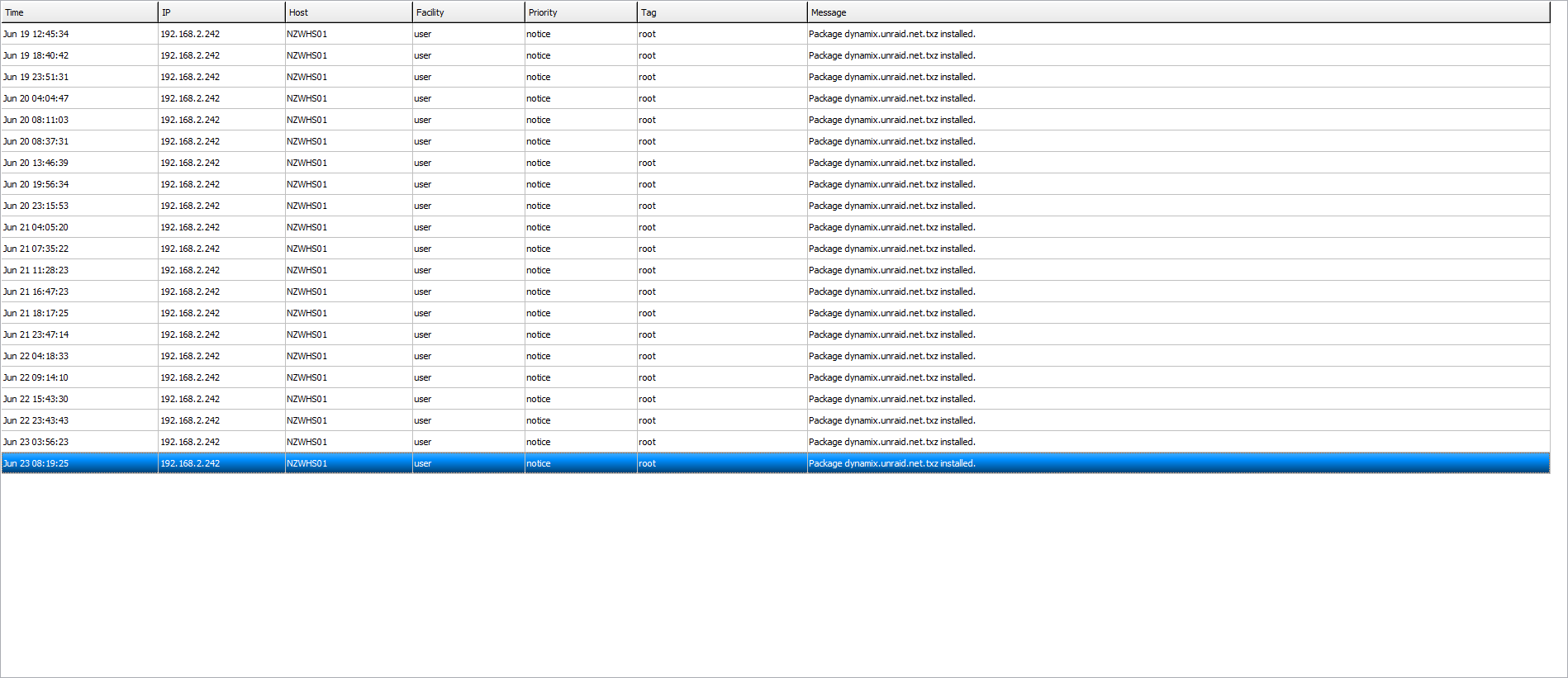

3 reboots later… I will now return n in safe mode to eliminate plugins. VM service off Docker Service off Safe Mode (to eliminate plugins) So effectively the only thing the server is doing is mounting the drives in the array.

I additionally turned off the VM service. Now it’s a wait and see. So both docker and VM service is turned off. Array is still running but basically doing nothing. Next will be safe mode to remove possibility of plugins causing the reboot. But I will wait to see if system reboots with both VM service and Docker service turned off before booting to safe mode.

So server rebooted two times overnight. usually around the 4 hour uptime mark. i then turned off docker service and the server rebooted at 915am and then again at 1545. no apparent reason...

Flipped back to macvlan and then stopped all containers and the docker service, ran the Unraid Update assistant... came back clean... then Updated to 6.12.1 without issues. restarted Docker Service and all the containers are up and running again... Waiting to see if I can pass 5 hours as such. If not, then before I goto bed, I will stop the docker service as suggested and see if I can get more than the 4-5 hours of uptime
