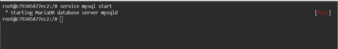

Type 'service mysql start' and troubleshoot the errors.  The ZM forum can lend a hand.
Edited by dlandon
I am having a real hard time with this.
I did service mysql start, it failed.
I posted the error messages, and searched them on the ZM forum but I make very little sense out of what folks are saying there.  Most of the issues were months ago, mine started with the update two days ago.
If anyone has any ideas of where to look for the answer, id appreciate it
The database fails to start, zoneminder fails to start.
Do I need to delete the folder and start over?
Would probably be best.  I'd say your database is corrupted.

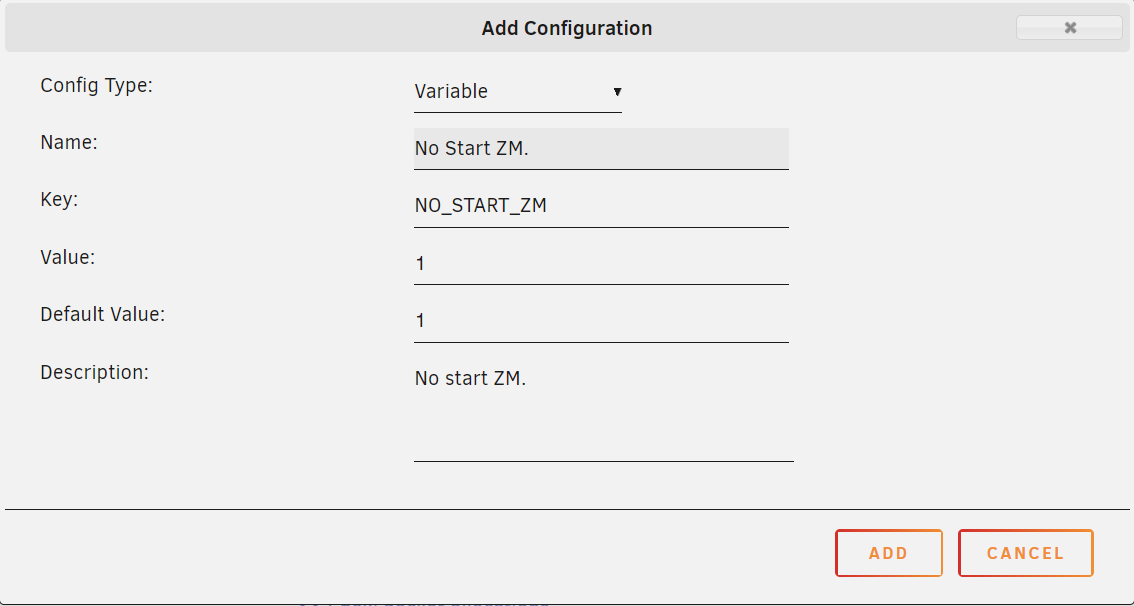

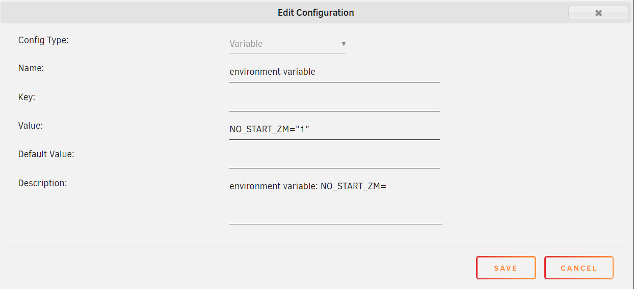

I tried also to redo everything from scratch so I renamed appdata folder as zoneminder_bk, deleted image and started over with new template.
I was expection that everything was ok now but at boot with NO cameras CPU is again 100% and in logs I found this
ERR [OPT_USE_AUTH is turned off. Tokens will be null]
over and over.
So I added NO_START_ZM="1"
and this is the brand new error causing cpu peak.
FAT [Failed db connection to ]
I really don't know what else I can do
Edited by Jokerigno
