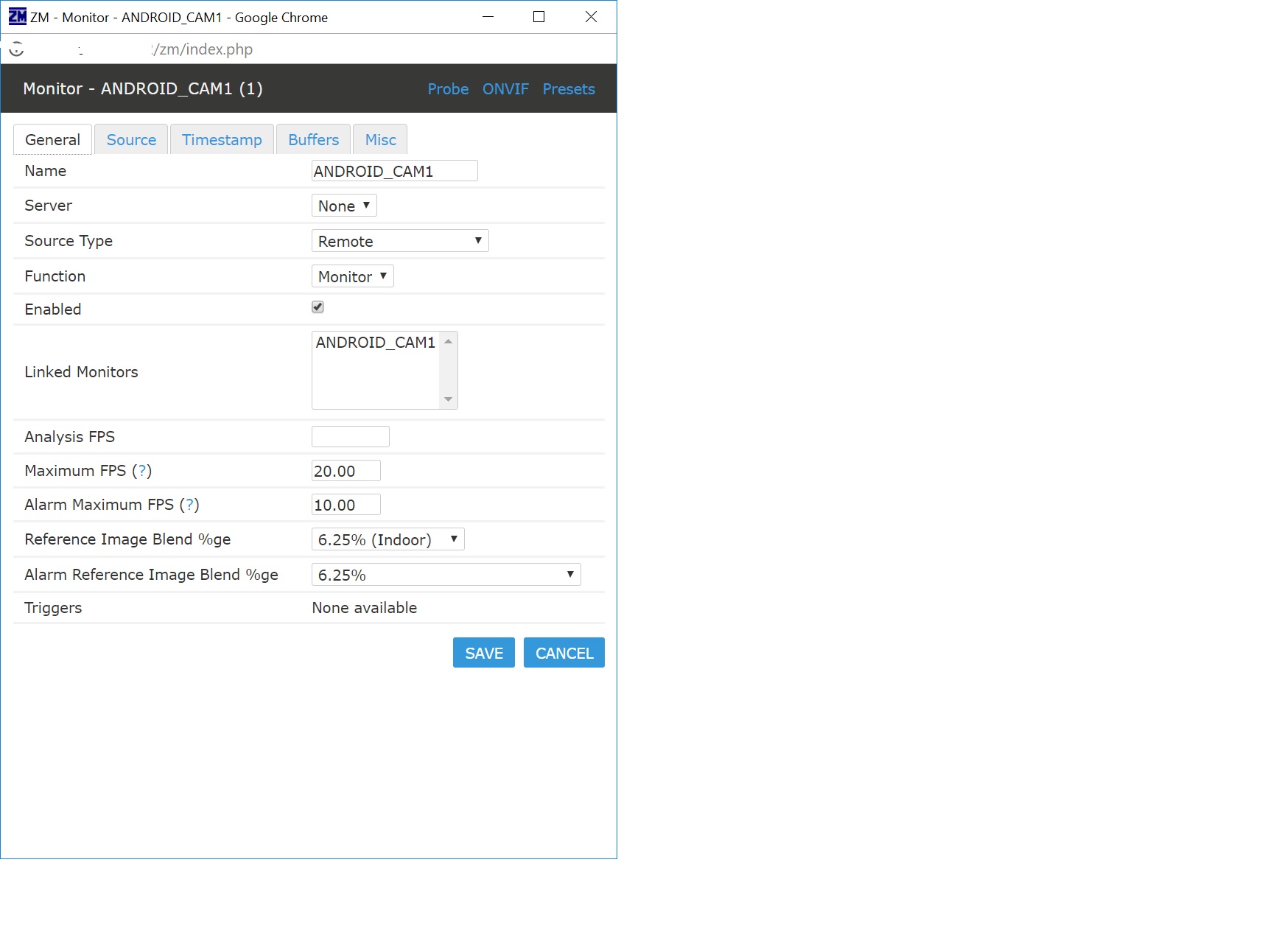

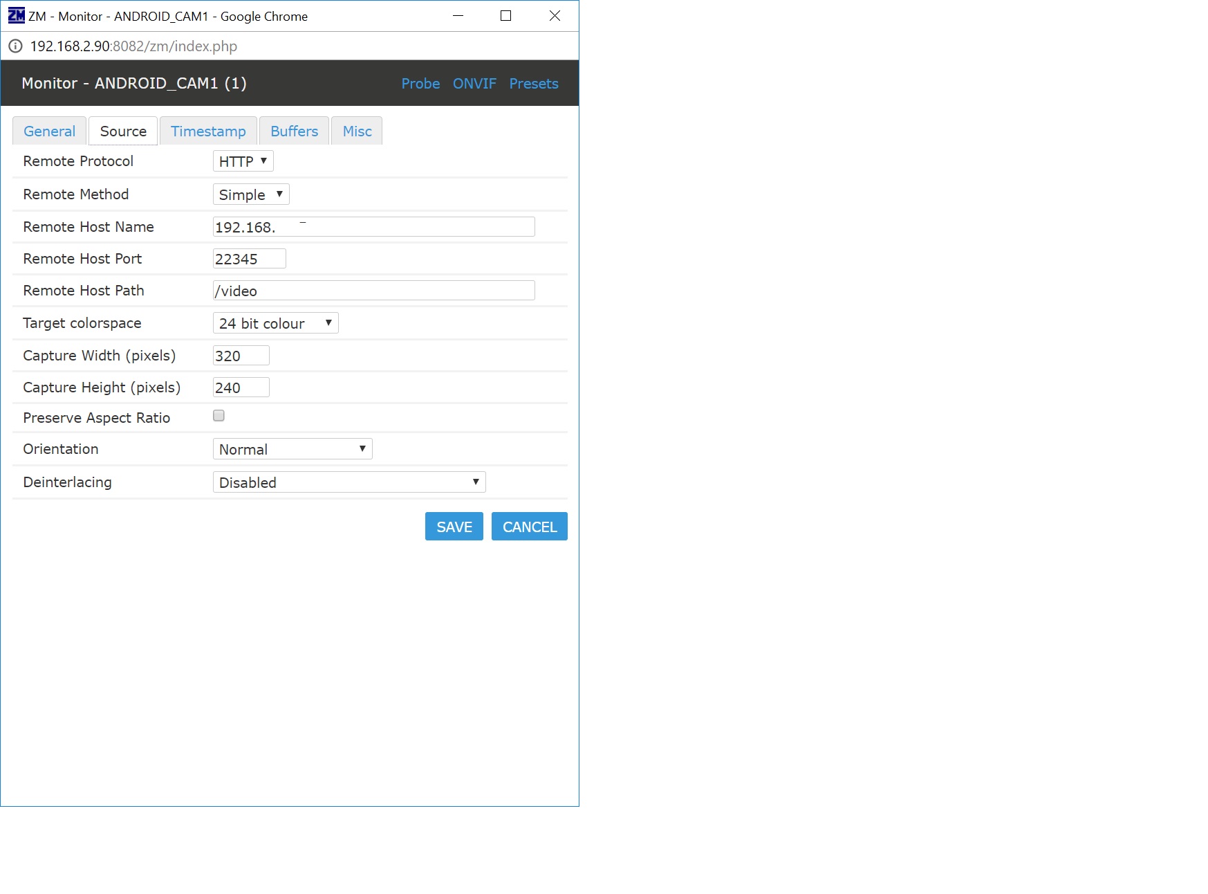

Hi guys, so i am using an old Android phone to test out ZM using IP Webcam app. For some reason i can not get a picture. I am seeing a ton of errors in the logs for m1. I am not sure what to do to correct this. Any help would be greatly appreciated? I have also included screen shots of the monitor config. Thanks! zm-log.html
