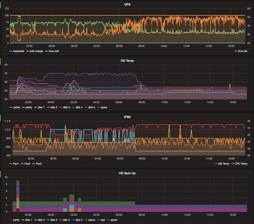

  6. Hi, I figured I wasn't clever enough to get the docker to do temperatures and wasn't really sure if it was possible to do it from the docker anyway, so I decided to write my very first PHP script! I managed to get sensible outputs for 'HD Temp' parsing the output of 'smartctl' for each of my disks, and luckily they still sense temperature without spinning up and when spun down. I used 'apcaccess' for UPS data so I can get the load on my UPS in watts (I have cable modem and router on the UPS as well as the server). I used 'hdparm' for spin status. And I used ipmi-sensors for fan speed and MB/CPU temp. Sending the data to influxdb via curl is quite straightforward. I use crontab to invoke the scripts which reside in my appdata folder. I have no idea if this is a sensible way of doing it and the scripts are very rough, but seems to work!

  8. Hi. Still working good here. Had a go at some basic dashboards but still learning. Can't see any metrics for temperature though. Both netdata and munin get the CPU temp ok via volume mapping. I presume need to add a plugin into the docker telegraf config folder? Or is it something basic in my setup? Missing lm sensors or something. I would also love to have hddtemp in the metrics too. Is that the same problem, need plugin? I can really see the potential of the telegraf/influxdb/grafana method though. Configurable to the nth degree! Sent from my iPhone using Tapatalk

  11. Last hour in the log is between 32 and 33 for HDD temp, but the readings pane has steadily deduced from 30 to 26 degrees. Incidentally, the temp polling time drop down doesn't do anything. I can't select it to change anything. Stuck at 3 min. It's just keeping the hd fan spinning higher than ideal when most drives except cache are spun down. Sent from my iPhone using Tapatalk
  12. Noted something weird. The fan control log shows a different hd temp to the readings tab and the footer value. E.g. Currently the readings tab has shown a HDD temp of 30 for the last 10 min or so, but the fan control log has varied between 32 and 33. Have spun up all drives too to make sure the data is refreshed. Any thoughts on the difference? Sent from my iPhone using Tapatalk
  13. Using both turnkey and docker versions of observium, I'm not getting the hard drive temps and share free metrics to show. I guess it's not seeing the mib? Any tips? Or another dashboard to try? Working great otherwise, although maybe the CPU and mb temps are the wrong way round? Mb temp follows the core temps more than CPU temp! Sent from my iPhone using Tapatalk
