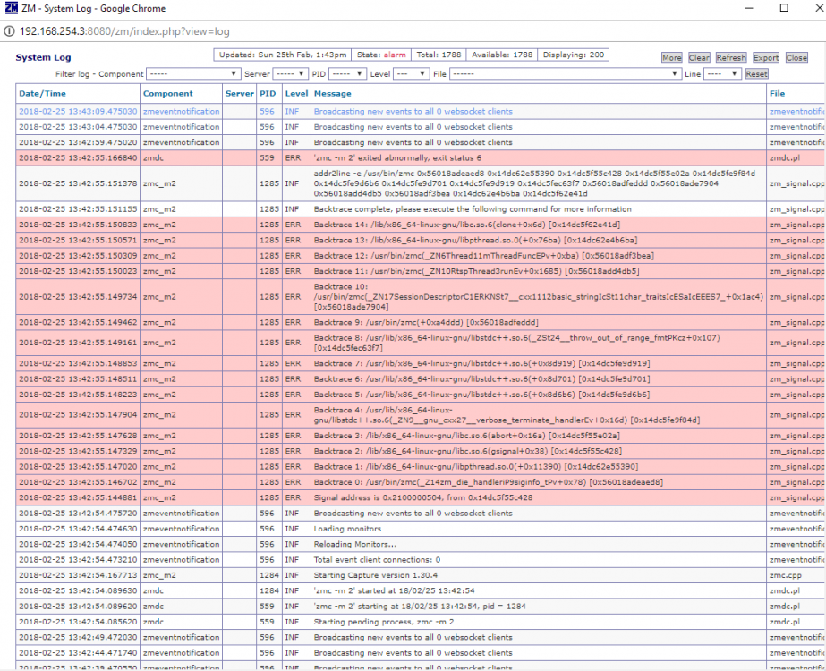

I just installed this and a bit of a newb with it but I cant seem to get it to run.
I keep getting this error when i add a RTSP source:
Memory map file '/dev/shm/zm.mmap.2' does not exist. zmc might not be running.
I can view the source in VLC and it plays fine so I dont think that is the issue:
rtsp://192.168.254.76:8554/unicast
Updated the settings and now i get these errors:
Edited by RAINMAN
image.thumb.png.8195ce545837d0ac75d021536760549f.pngimageproxy.php?img=&key=00b562fcac28e727
Looks like a memory issue.  I'd take this to the Zoneminder forum.  The link is in the first post.
