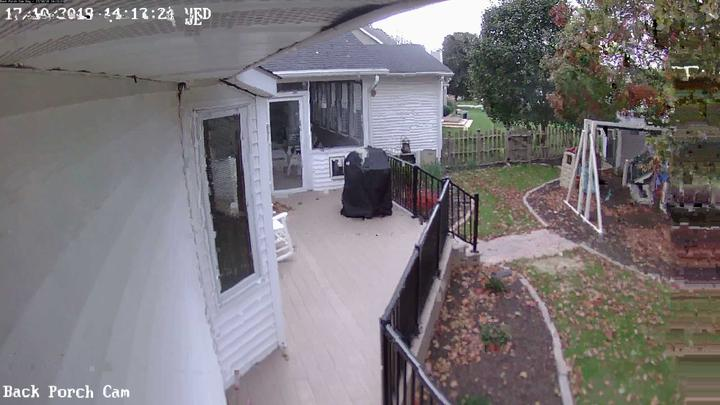

So i updated to the new 1.32.2 and now I am having issues with the images being blurry.  The update before the new layout i didn't have any problems with the blurry images.  Is there something that changed that is causing this?
Nothing in the docker should be causing this issue and I don't know of any issues with the latest version.
You might want to confirm your camera resolution is set correctly.

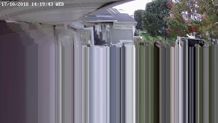

This is what I am seeing.  I restart the docker and it seems to fix it for awhile but then it eventually goes to this or sometimes worse.  This happens to all 4 of my cameras or sometimes just a portion of them.  I have already increased the SHMEM to 60%  (I have 32 GB on the system)
On the zoneminder console, you should try to keep /dev/shm under 70%.  I would run /dev/shm around 40 to 50% (This is the /dev/shm on the zoneminder console, not the SHMEM% setting in the docker xml).  You might be taking too much memory for zoneminder and not leaving enough for Unraid.  Try to cut it down.
This looks like a processor loading problem.  You may need to pin some CPUs to the zoneminder docker.
Ok i turned down the SHMEM% to 50% which was the default.   My /dev/shm percent is hovering around 18% which seems good enough.  I will try to pin some CPUs to zoneminder if I can figure it out.
Take the SHMEM% to 25.  Zoneminder does not need that much shared memory.  What version of Unraid are you on?  6.6 has a CPU pinning page so you can do it through the gui.
Ok i took the SHMEM% to 25 and pinned 2,6 and 3,7.  (Yes i am on 6.6)  My /dev/shm went up to 35% which makes sense since i lowered the SHMEM% but I am still seeing the same problem on my images.
Is there a way to go back to the old repository before 1.32?  I was just going to see if going back helped fix the issue.

What frame rate is set on your cameras?
