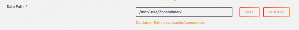

I am new to this stuff, and I had the exact same issue. But when I added the new share and connected the path to it... it worked. But I can not log into the Web UI.
I have it set to "http://[IP]:[PORT:80]/zm" So what would I enter as the url? I tried http://192.168.1.2:80/web/index.html, http://192.168.1.2:8080/web/index.html, and http://192.168.1.2:/80/zm
Left click on the Zoneminder docker icon and choose "WebUI" and you'll get to the UI.

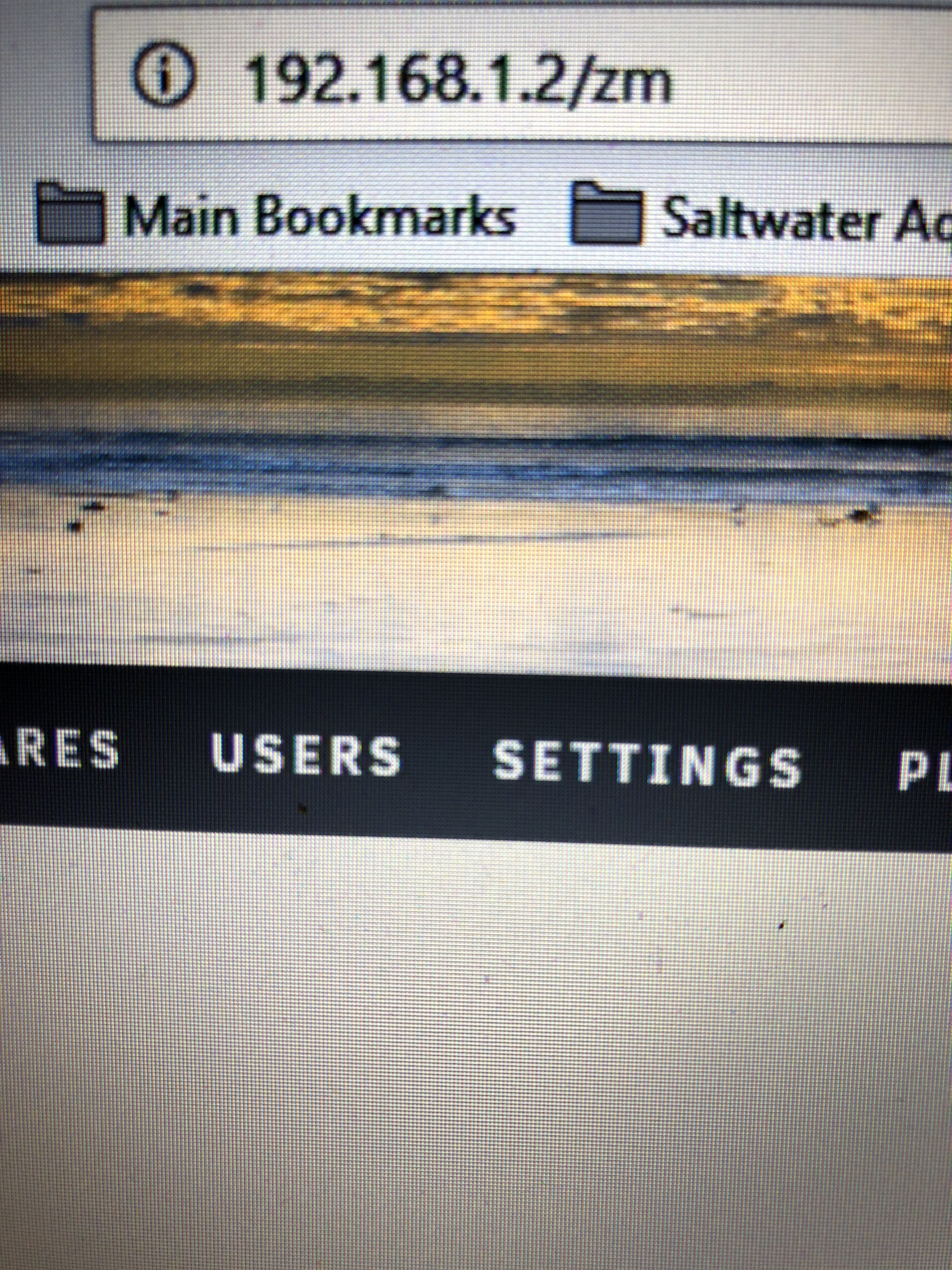

Sorry, I should have said I tried that first. When I do that it takes me to 192.168.1.2/zm
Did you set an ip address for Zoneminder or is that the Unraid server address?  Please remove the docker and the xml file and install zoneminder with all the defaults in the xml.  Don't make any changes until you get Zoneminder going.  The default port is 8080.
