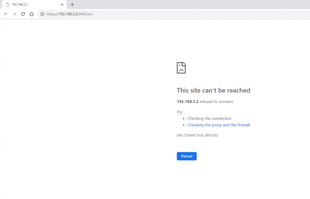

Show a screen shot when you try to access the Zoneminder WebUI.  Just telling me it doesn't work is of no value.

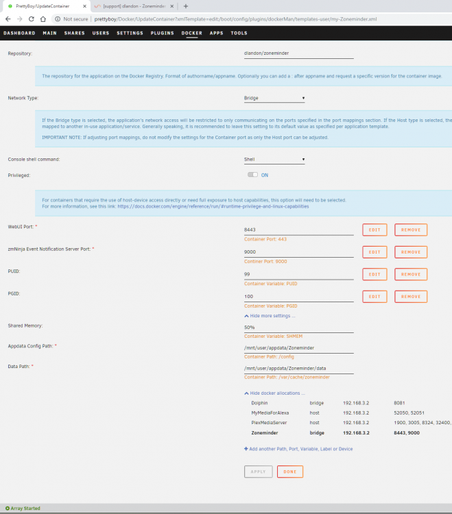

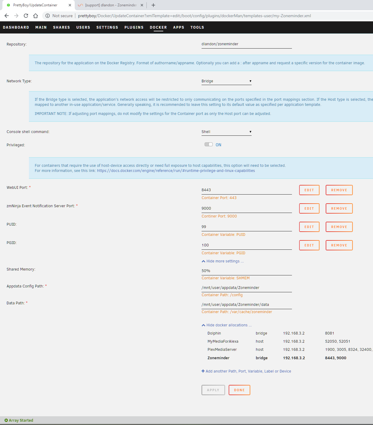

Part of the problem here is the template  You've got in it for the webUI link
https://[IP]:[PORT:8443]/zm
That line takes whatever container port 8443 is mapped to and changes it to the appropriate host port, or uses 8443 if the mapping doesn't exist
That's why even when buddy changed the port to instead be 443 it still went to 8443
Change the webUI link to instead be and it will follow the mappings correctly
https://[IP]:[PORT:443]/zm
@OrangeLoon you should make this change also in the template when you edit it (advanced view - webUI  *if you can't see it then you may also need to Settings - Docker, Enable Template Authoring Mode)
Edited by Squid

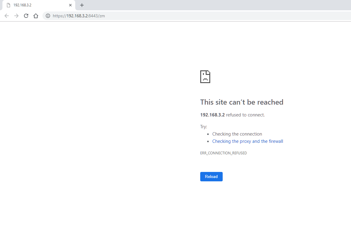

OK - Here is where I am:  I have made the modification above to the WebUI link as described above.  When I can click on it, it generates a "NET::ERR_CERT_AUTHORITY_INVALID" error which I can bypass.  Here are my settings:
You are getting that error because the certificate is self signed.  To get rid of that you will need a real certificate.

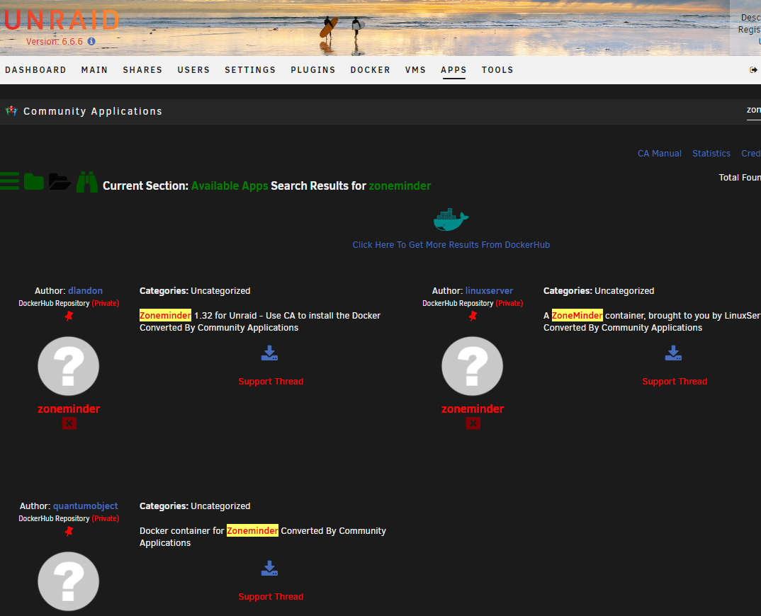

Whenever I search for Zoneminder in CA it only shows the private repos. I try installing it but never seems to work correctly. I would rather just install the Zoneminder preconfigured. Any ideas?
Edited by enriquezandrew92
I think you have "Enable additional search results from dockerHub?" set to yes.  Turn that off.
If you continue to have problems, post on the CA forum for help.
