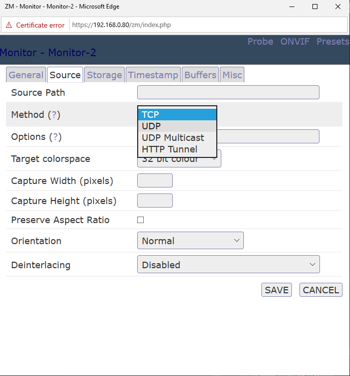

I have just installed this docker as I want to move away from yearly licences and a Windows VM to run Blue Iris.
I have viewed lots of guides and youtube videos to add my Hikvision Cameras but I do not have the rtsp method available from the pull down menu? How do I get around this?
Use TCP.
4 minutes ago, dlandon said:
Use TCP.
I have been trying TCP but with no joy, can you see any obvious errors in this line?
rtsp://admin:[email protected]:554/cam/realmonitor?channel=1&subtype=0
That might be right for your cameras,  Mine is rtsp://admin:[email protected].  Be sure you have the 'Source type' set to Ffmpeg.
Check and see if your camera is listed in the 'Presets'.
Look up on Google to see if you can find a Zoneminder setup for your model camera.  You will probably get better help on the Zoneminder forum.

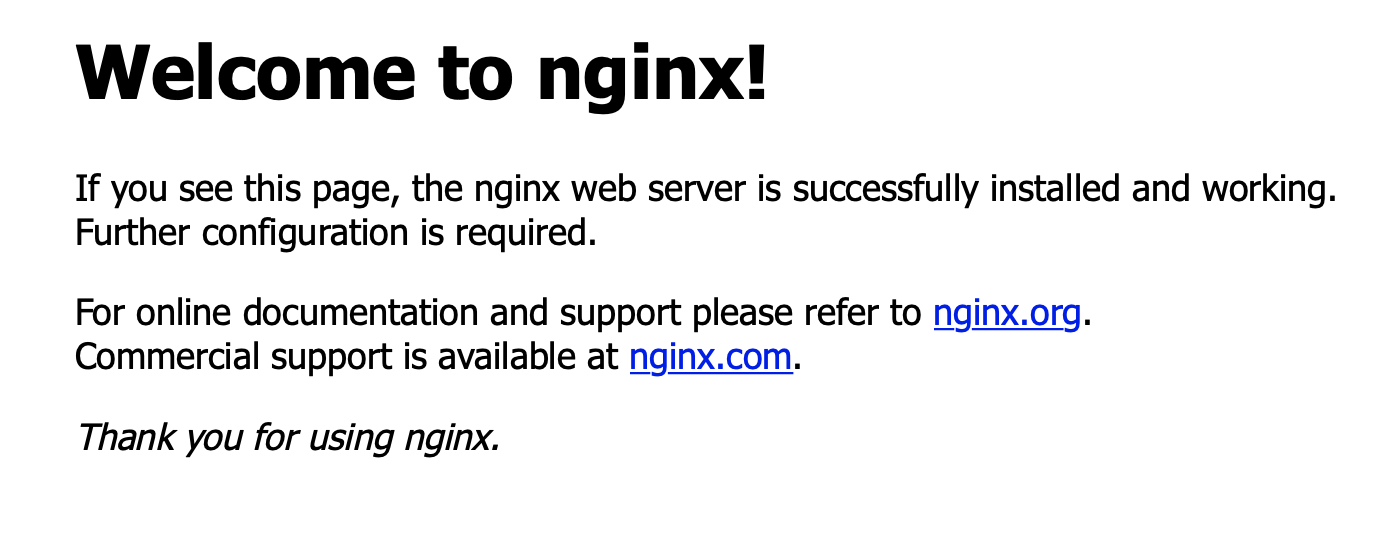

I have a couple issues going on right now with the latest version.  First, I setup a reverse proxy using letsencrypt.  I am able to login through Chrome and the zmninja ios app.  I cannot login through Firefox, Safari, or IE.  I setup my proxy.conf file according to my last post https://forums.unraid.net/?app=core&module=system&controller=content&do=find&content_class=forums_Topic&content_id=56632&content_commentid=724628.  I've attached the screenshot I get from Safari and IE, and Firefox say the connection was reset.
The other strange thing going on is I am was able to see my events in Chrome, and now I see a white screen with no controls.  This is a video I was able to see 2 days ago.  When I try to download the video using the video link it says not video found.  Then I click it again, and it shows my download options.  However, when I try to access the video there is no content.  Does anyone know how to fix this?
It looks like you have an issue with the proxy.

There may be an issue somewhere.  The thing I don't get is that I can see the events and feeds from zm ninja app, which uses my reverse proxy.  Also I can see the feeds through Chrome but not the events.  Every other browser shows that error.

After a bit more research, I figured out my issue.  Chrome seems to resolve the /zm folder.  Whereas other browsers don't.  So when I type zoneminder.mydomain.com in a browser other than Chrome I get the nginx page.  When I type zoneminder.mydomain.com/zm it works.  Is there any way to configure zoneminders so that when I type just zoneminder.mydomain.com it goes to the root folder?
I don't think so.  Ask on the Zoneminder forum.
