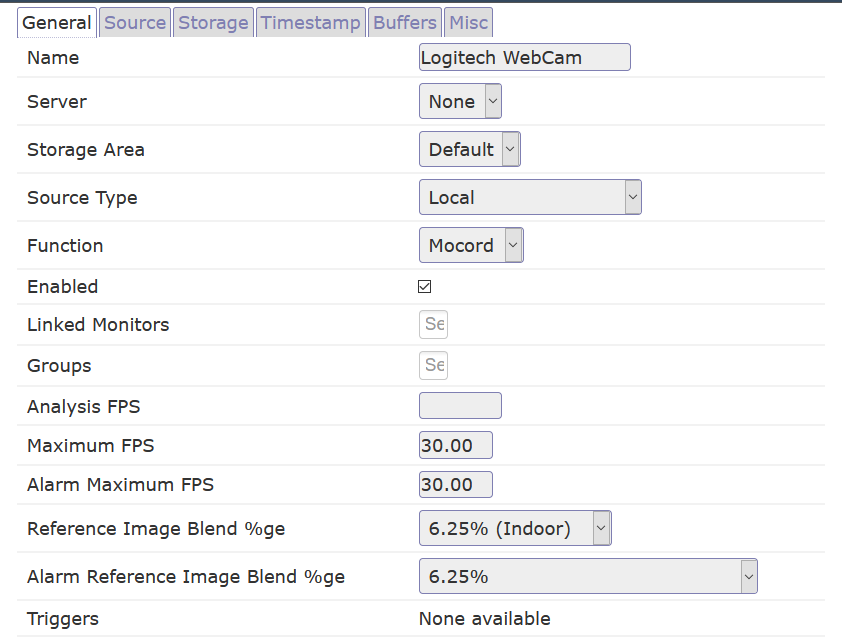

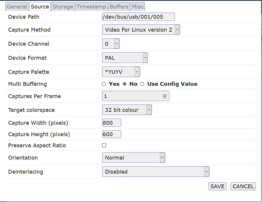

Hi all!
I'm at the moment trying to set up zoneminder to use a webcam to surveillance the room where my unraid server is located. But I can't get it to work, the logs keep giving me a permission denied error.
Any ideas, I can't seem to find an answer online..
Thanks!
6 hours ago, Archiardo said:
Hi all!
Thanks!
Camera credentials?

Camera credentials?
It appears to be a Logitech B910
I've included my set up parameters as well. Just note that it's normal to use usb 5 now, I've replugged it and unraid gave it another number.
