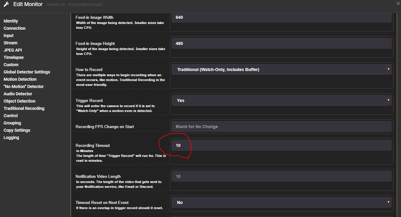

Has anyone else had trouble setting up motion? I thought I had it figured out, maybe something to do with time stamps where it wasn't making proper comparisons on frames? Was a a complete guess, but when I removed that timezone docker mapping, my watch-only monitor with trigger-record finally would trigger. Then I decided to shorten the 10 minute recording to 30 seconds. And now motion no longer triggers it. I even went as drastic as I could, set a specific done by my front door, only leveraged that zone, set indifference to 1, and then wildly swung the door. It would not trigger the event. Spent too many hours on this so I'll have to shelve it for a while. I may try to run the program natively rather than use the docker. Per usual, I'm sure this is user error, but there's typically less potential for user error outside of the docker realm. EDIT: The attached image seems to be the culprit. If I don't set this for 10, it won't trigger. When I place it on 1, it doesn't trigger. Any ideas?
[Support] spaceinvaderone - Shinobi Pro
Figured it out, that was silly. I had the "temp streams" mapped to the same location as the permanent recordings. I assume upon reset, the temp streams folder gets cleared which was ultimately clearing my recrodings folder. Now on to figuring out how to get recording on motion working.
