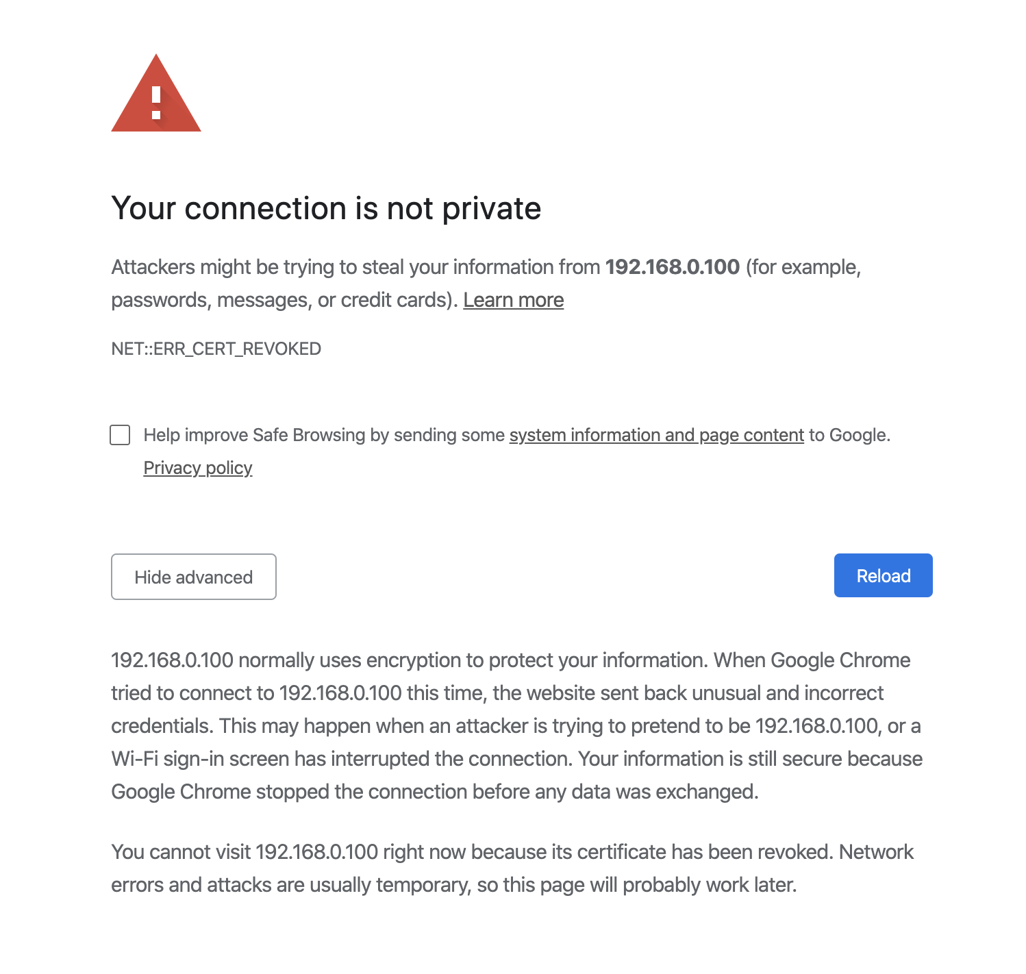

On 10/19/2019 at 5:53 PM, dlandon said:
Verify the 'ServerName' file in the appdata/zoneminder/keys/ folder contains 'localhost'.
I have the same issue and localhost is present in the ServerName file. I cannot get past it to even get going.
What problem are you having?
Chrome is throwing NET::ERR_CERT_REVOKED error when trying to access the zoneminder url.
