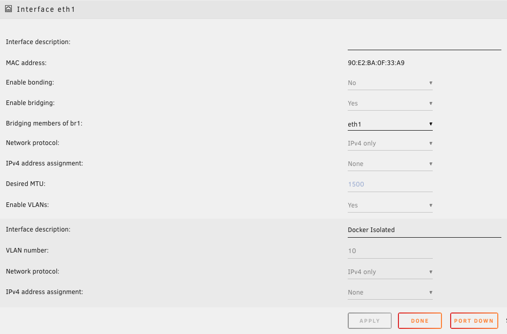

  7. How does one recreate the custom network? I think my 192.168.10.1/25 network br1.10 was automatically created when I created a bridge on eth1 with a specific VLAN. I tried using the UI to uncheck the docker network (restarted) and then recreate it, not sure if this is the right way (see screenshot) but it did not change anything.
