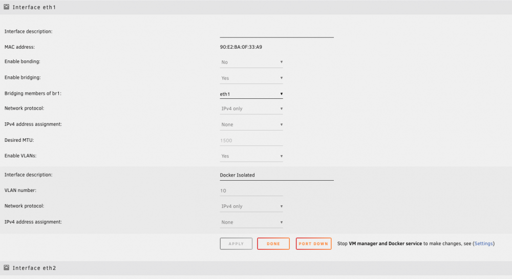

How does one recreate the custom network? I think my 192.168.10.1/25 network br1.10 was automatically created when I created a bridge on eth1 with a specific VLAN. I tried using the UI to uncheck the docker network (restarted) and then recreate it, not sure if this is the right way (see screenshot) but it did not change anything.

No they don't. Makes no sense to me. I did a normal downgrade via the UI, no dice. Then I actually took a backup of the USB before I started and overwrote the UNRAID USB and still the same. So confused

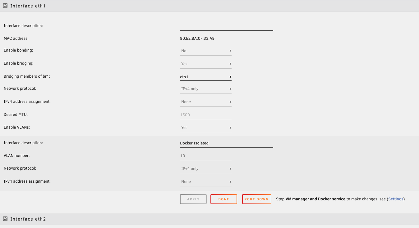

I'm currenlty using a second Intel Quad NIC to allocate separate VLANs to a couple of my dockers. Basically port 1 is untagged (host), and port 2 and 3 are configured as separate VLANs (attached image) and I use these bridges for certain dockers. I believe I did because I had problems with inter-docker networking with other dockers bridged (to the host) and to the same parent interface. Could I do away with this NIC and use the onboard Intel NIC on the motherboard and set up VLAN using a parent interface but will I have MacVLAN problems like inter-docker communication with the unRAID box and VLANs?
