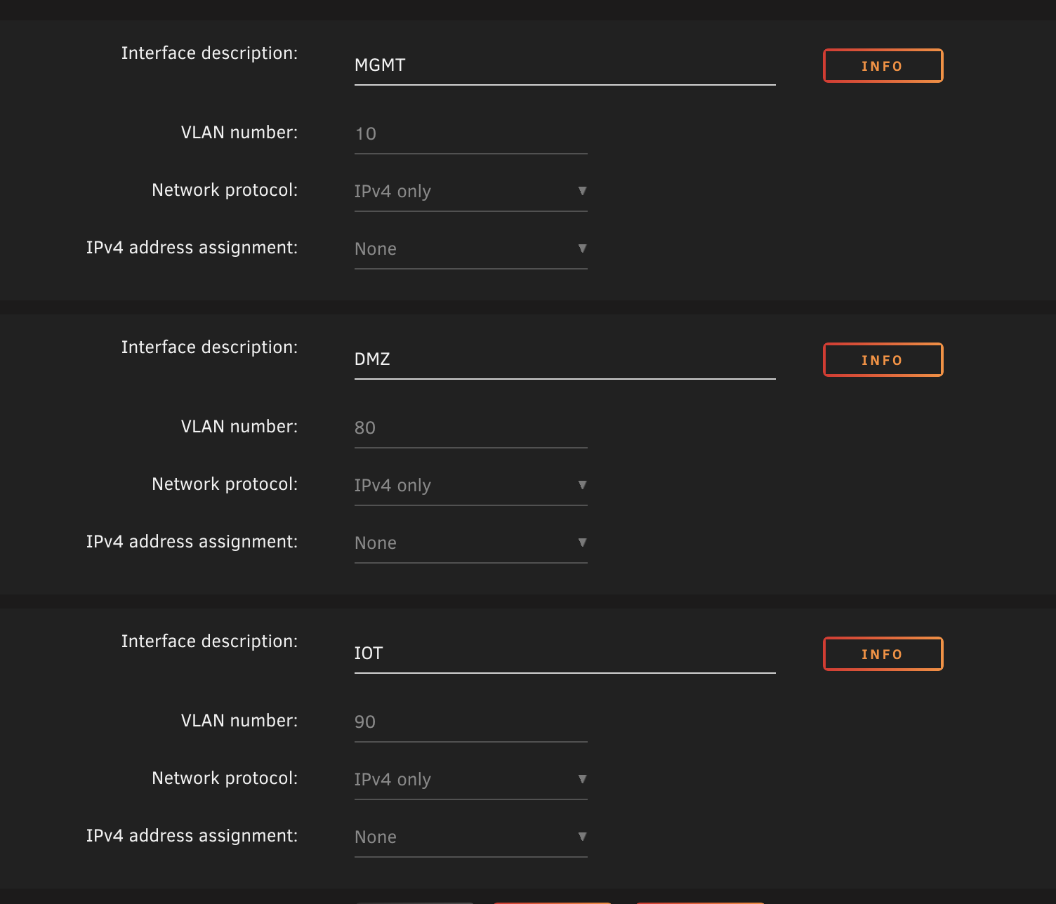

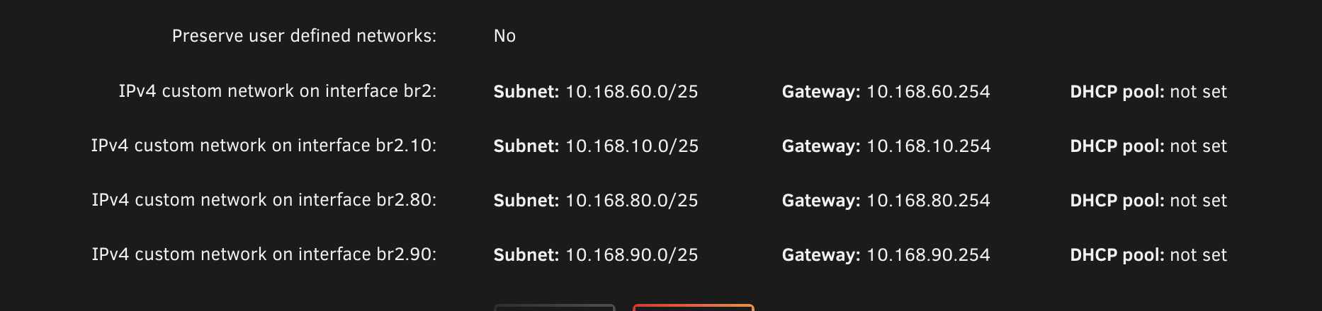

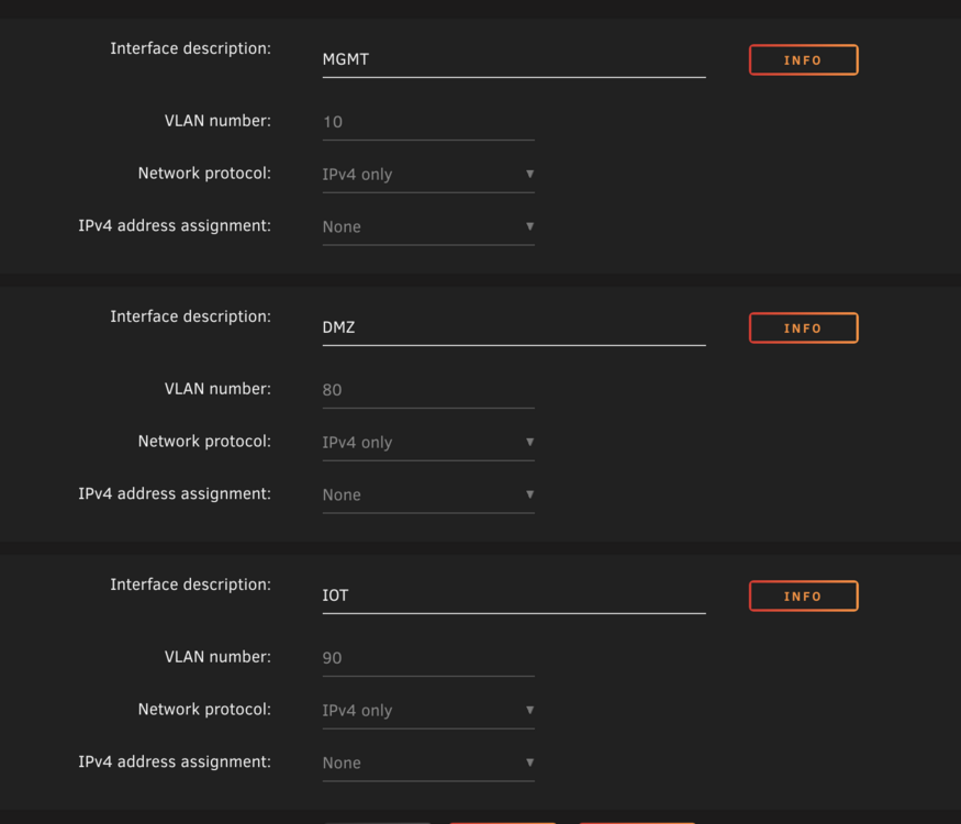

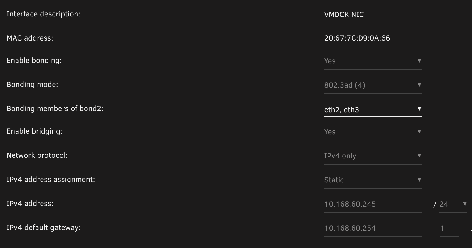

  10. That was the better solution….while both solutions work, simply removing the IP on the interface and defining the network and gateway in the docker settings.
  11. My expectation was that it would pick it up as well but it doesn’t… let me try removing the IP on the interface…. I don’t need an IP on it specifically. That would be a better fix.
  12. Yes exactly except in my case br2 is not editable
  13. This resolved the issue…. I find it odd that you cannot define the getaway in the UNRAID GUI. You can see that it is not defined but there is no capability to edit it.

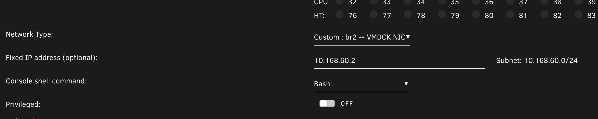

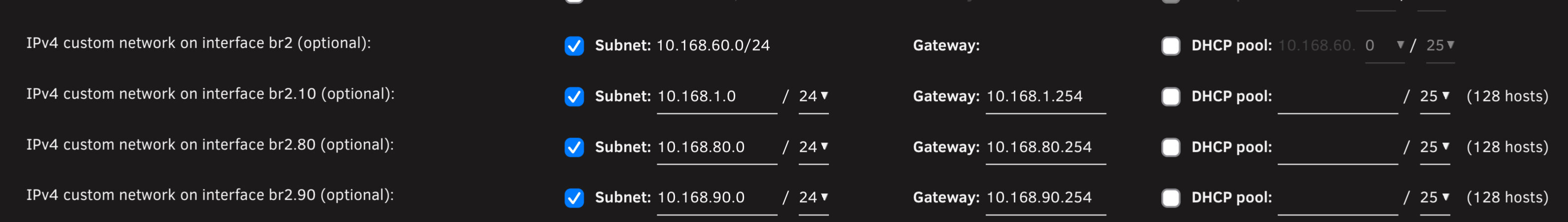

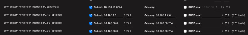

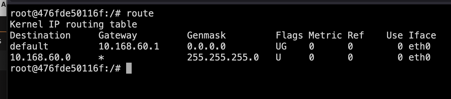

  14. I know by default that br0 is where docker is bridging... I'm using a custom config. I have 4 network interfaces.... configured into two 802.11ad bonds. bond0 and bond2. bond0 is the admin interface for unraid on a management vlan. bond2 is the interface that is a trunk interface for multiple vlans. Some dockers are on br2.80 br2 - is on vlan 60 the native vlan for the trunk. Additional vlans are: br2.10 br2.80 The bond2 interface is assigned an ip of 10.168.60.245/24 with a gateway of 10.168.60.254 I have several docker containers running on br2.80 and they are running fine. They show the proper gateway however the containers on vlan 60 should be showing the same host interface default gateway of 10.168.60.254 however they are getting a gateway of 10.168.60.1. The docker network doesn't seem to pickup the default gateway of that host interface but the sub interface is getting the gateway I have assigned. in the custom network just fine. There should be a simple way to assign a custom default gateway for a container. The output of 'docker network inspect br2': [ { "Name": "br2", "Id": "17ca4604ab87ae68e47df153062a8bbdb7e45466e5f95e1099a8d4efffb4714c", "Created": "2024-10-20T18:18:34.938423495-04:00", "Scope": "local", "Driver": "ipvlan", "EnableIPv6": false, "IPAM": { "Driver": "default", "Options": {}, "Config": [ { "Subnet": "10.168.60.0/24", "AuxiliaryAddresses": { "server": "10.168.60.245" } } ] }, "Internal": false, "Attachable": false, "Ingress": false, "ConfigFrom": { "Network": "" }, "ConfigOnly": false, "Containers": {}, "Options": { "parent": "br2" }, "Labels": {} } ] The output of 'docker network inspect br2.80': [ { "Name": "br2.80", "Id": "f22dcc51a4a813565fcc3385354c2c34e28a73f836151fe6ba25c62cc6ddb91a", "Created": "2024-10-20T18:18:35.256187663-04:00", "Scope": "local", "Driver": "ipvlan", "EnableIPv6": false, "IPAM": { "Driver": "default", "Options": {}, "Config": [ { "Subnet": "10.168.80.0/24", "Gateway": "10.168.80.254" } ] }, "Internal": false, "Attachable": false, "Ingress": false, "ConfigFrom": { "Network": "" }, "ConfigOnly": false, "Containers": { "7a7642e1c24a2409ef5aa31c8293c9c2b14c66bfae19c6247de32d1b3632bfdb": { "Name": "bhdelugevpn", "EndpointID": "a7db7f8ae3ae19cc49566e306ab334a400a4f5f15ea5fc2ef434b76a8ac4f417", "MacAddress": "", "IPv4Address": "10.168.80.1/24", "IPv6Address": "" }, "f51bea5753b086b0af16d303a6c1773715b1b8b0ef91a599749b1a510b88eb8c": { "Name": "plex", "EndpointID": "ebc4596d489b6242b007adb4f92ca75526046750300dfc26dc367b254269703f", "MacAddress": "", "IPv4Address": "10.168.80.10/24", "IPv6Address": "" } }, "Options": { "parent": "br2.80" }, "Labels": {} } ]
