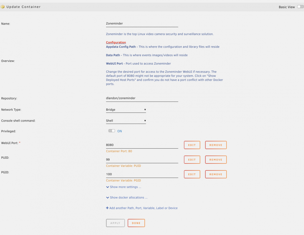

Hi All,
I'm having a problem getting into the webui of zoneminder, actually getting it working.  It has been working great all along until unraid 6.6.6 update.  I'm getting a site cannot be reached.  Well I noticed that my unassigned devices were unmounted after the unraid update.  So I mounted the disk thinking that would fix it.  No luck with that.  I still can't access it.  Any idea what can be going on? I've attached my configuration.
4 hours ago, Mlatx said:
Hi All,
It's not a 6.6.6 issue.  The Zoneminder docker has been changed to only allow https: access.  Your template is set up for http: access that Zoneminder no longer allows.  Go to CA and find Zoneminder.  Then use the default template to setup Zoneminder.  Go to the Dockers and left click the Zoneminder icon and choose WebUI.  You can the access Zoneminder.
That's good to know.  So would I have to reconfigure zoneminder and all of the settings?  Or if I just download the new zm template from CA it will pickup the existing settings from appdata?
Yes.  It just configures the Docker, not Zoneminder.
