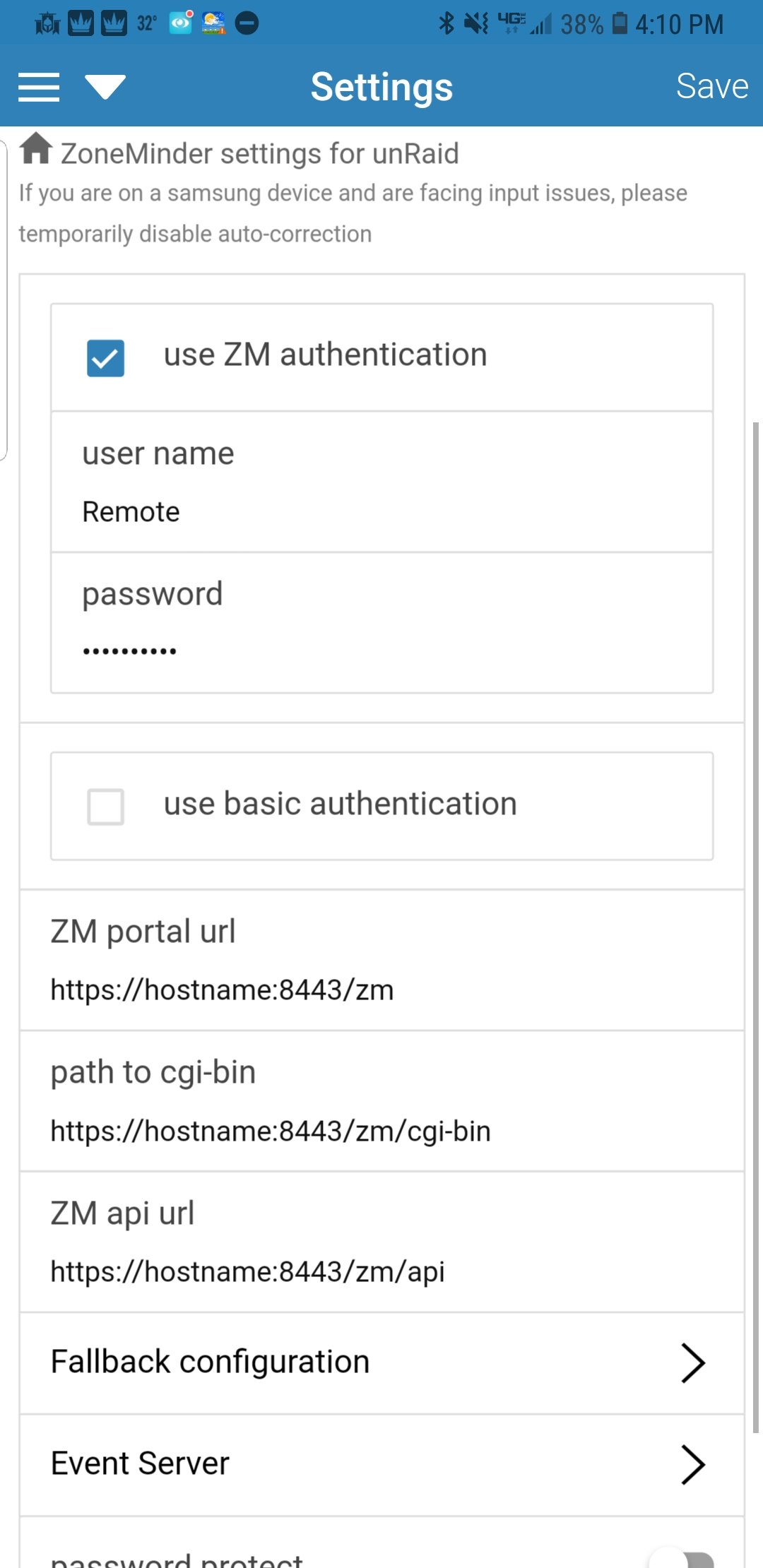

Thanks for all the support you've been providing to all of us.  ZM isn't the easiest thing to get running and you've done a great job with the Docker.
I have it running and am now trying to get zmNinja and notifications working with it.  I just want to make sure I'm allowing access the correct way and not opening up too many security holes.
I have a static IP assigned to the docker as recommended previously.  It turns out that dockers can not access other docker IPs so I am unable to get OpenVPN to allow me to access ZM through VPN.  It appears I have to open ports in my router and forward them to the ZM IP.  I have 80, 8080, 8443 and 9000 going to the ZM IP.  Is this safe and is this the preferred way to allow zmNinja to access the server from outside my lan?
I can use most of zmNinja but have not gotten notifications to work yet.  I want to make sure I have the connections correct before trying to troubleshoot further.
The only ports I would open are 8443 (8443 external mapped to internal 443 when you have a static IP) and 9000.  Access ZM using https:// through port 8443 external, and the 9000 port is for the events notification.
Be sure to enable the event notifications (OPT_USE_EVENTNOTIFICATION) in the options.
As soon as I close 80 and 8080, zmNinja can not connect and gives a "Zoneminder Authentication error".  It also can not be reached in a browser at https://hostname:8443   This may have something to do with SSL cert since I have not set anything up for that.  The first post says the cert is automatically generated but I do not know how to test it.
hostname in settings is a resolvable dns hostname that works with port 80 open if I user http://hostname/zm , just changed it for posting.  Is this not the correct way to set this up for ssl?
That is correct.  Check your port forwarding.
