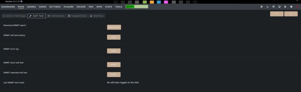

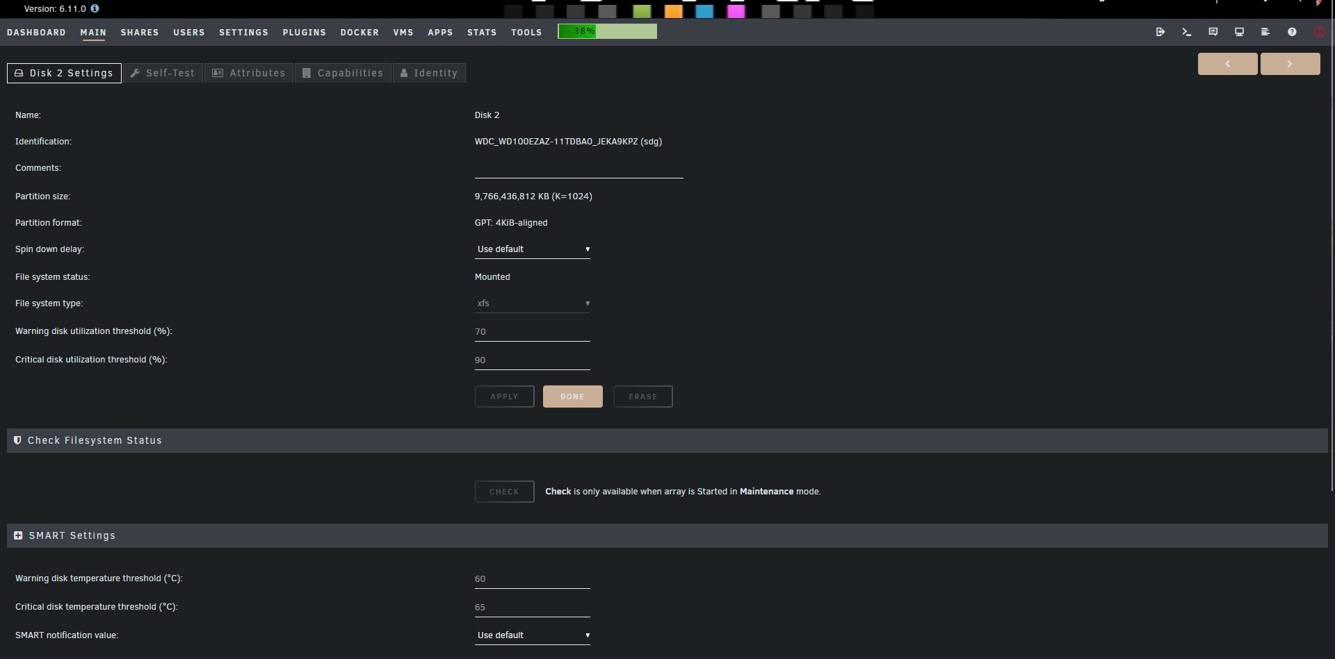

Hello,

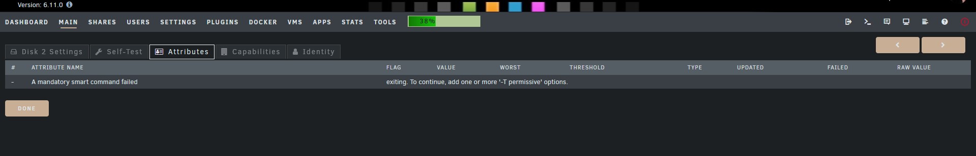

I am having problems with one of my drives and is looking for some moral support...
I got about 50 read errors and thought it was a good idea to run a Smart Self Test.
First Short Self Test went fine, no errors, then I did an extended test because this drive has been having temper tantrums before.
After about 5 min it got 1074 read errors and the drive was automatically Disabled.
Now it's frozen.

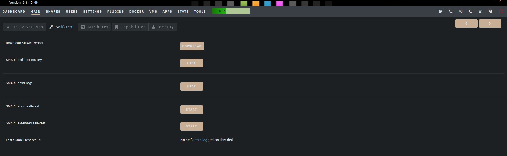

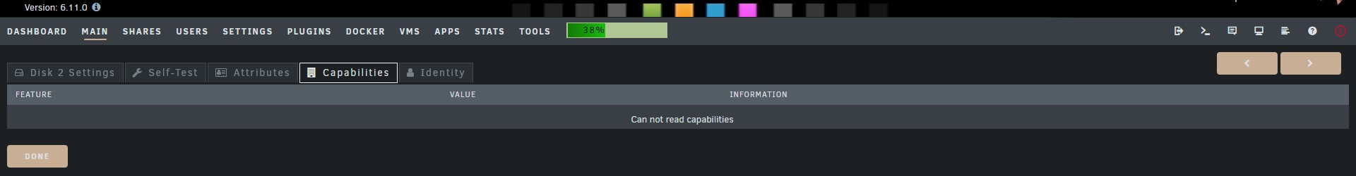

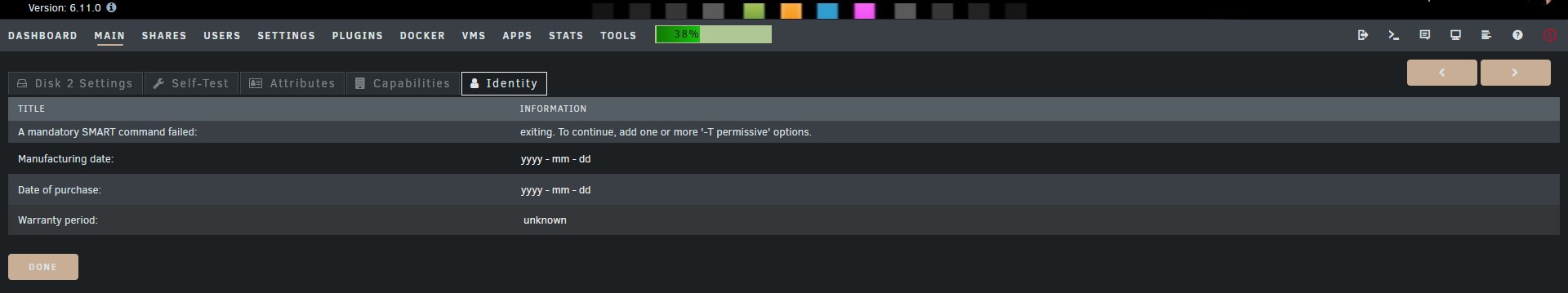

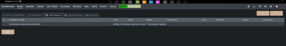

In the Self Test tab "latest smart test" is just spinning/loading. When I try to download the logs I get a blank file, so I cannot really provide you guys with logs.
History and Smart Error Log buttons show nothing either. The other tabs show no information.
Nothing happens when I try to Spin Down the drive.
Not sure what to do now, what would be my next step here? Should I consider the drive done?
I am currently looking online to find a new drive.

No SMART report for disk2. Emulated disk2 mounts and is half full.
Shutdown, check connections, both ends, SATA and power, including splitters.
Reboot and post new diagnostics.
