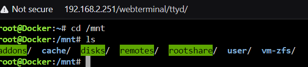

I only know of a few way to get the /mnt/appdata

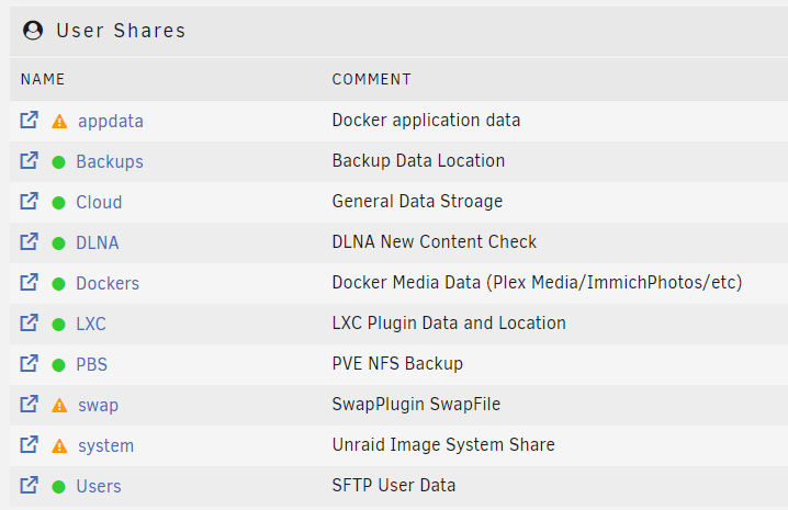

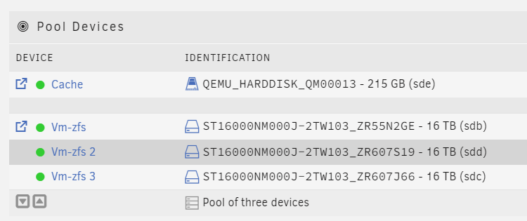

What I really need is some answers or a picture of your main, a picture of your shares, a picture of the settings for appdata and a picture of your docker advance default appdata path...
as example. I run zfs. My Main is this collection of disk...
If I called the zfs pool appdata I would have a pool disk mount located at /mnt
Default unraid setups a appdata share.
as by default unraid ships with a cache pool for a single disk and this is setup to be the location for the appdata folder.
as you can see I also have a made a docker share.

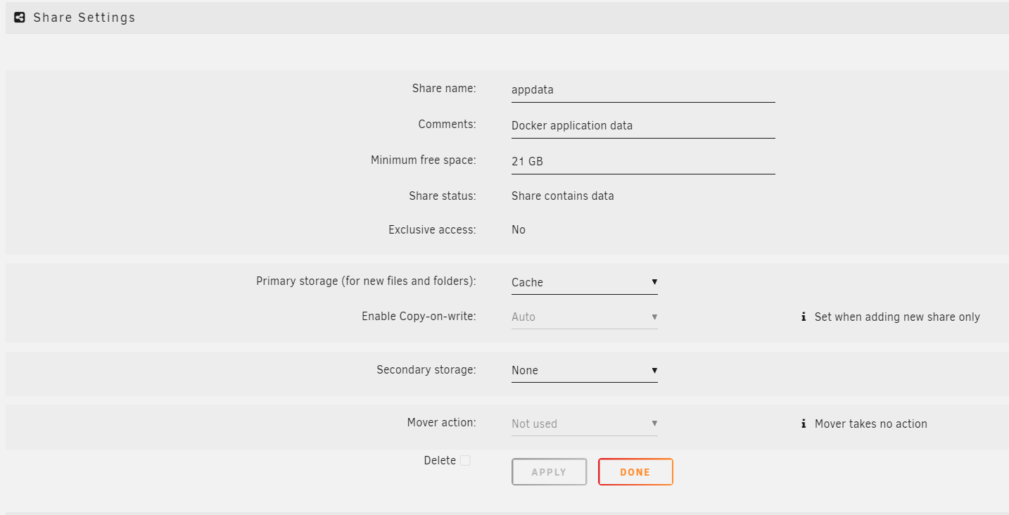

with the share settings I'm more looking at the Primary storage and secondary storage.
As this will dictate how new files when created are placed on xyz disk. It should be set to one location so mover doesn't separate files.

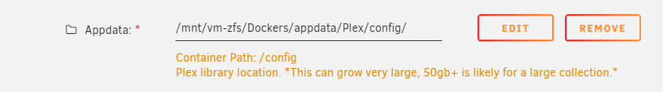

BUT In truth it doesn't matter as long as you tell the docker the folder paths...
example plex:
in the docker template at the top right:
there will be a show more settings. as some docker need settings but usually they are not touched. Most docker ship with a config folder of some sort. this is usually mapped to the unraid appdata folder location.
the will be named appdata but you can set the docekr path to any location on unraid.

Double check folder file location and set a folder you want to use and tell unraid primary storage to be that one location.
