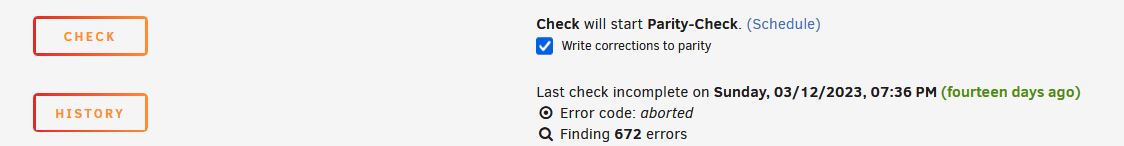

  5. Should I perform another parity check? If yes, should I check/uncheck the box?
  6. Is there a way to find out which drive/folder/files were affected by the parity error?

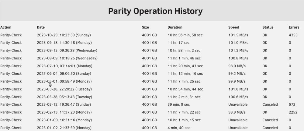

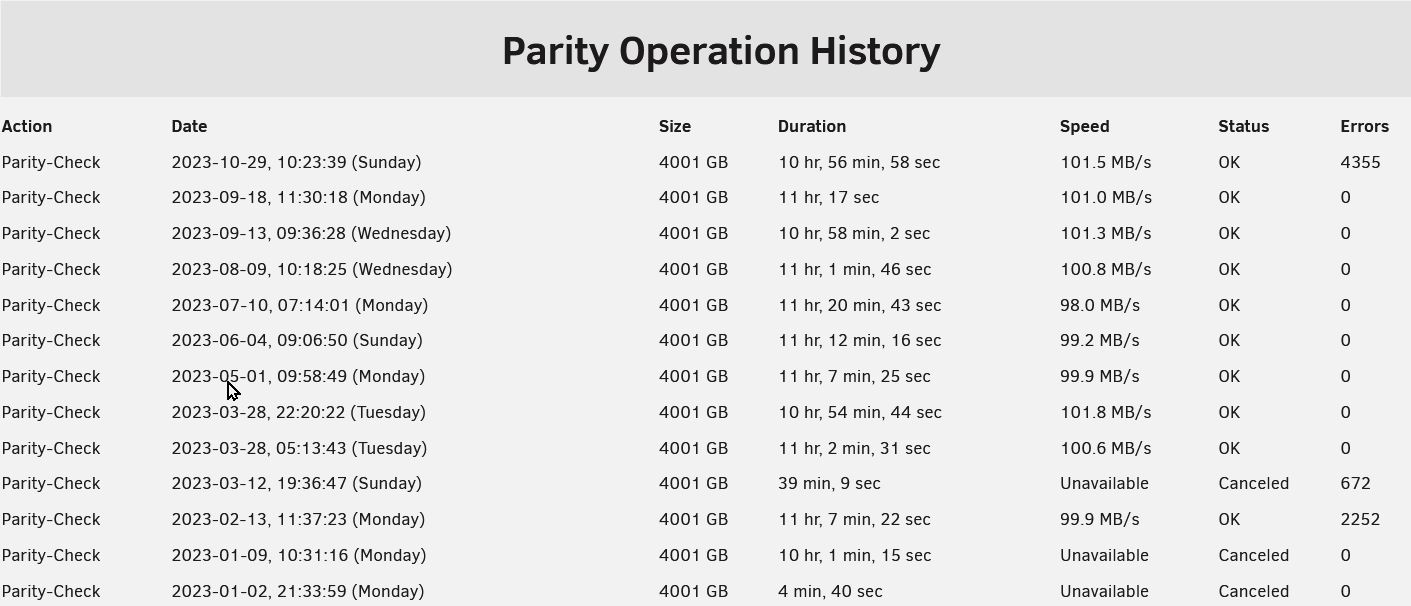

  8. The same issue is happening again that happen 7 months ago. I've been making sure there's clean shutdowns by clicking the spin-down button first, waiting for all the disks to show that they've spin-down, and then clicking the shutdown button. I still get all of a sudden 4355 errors on a parity check. The only that has changed since the last parity check on 9/18/23, is that after that parity check, I upgraded from 6.10.3 to 6.12.4. So this is the first Parity check I've done after upgrading OS. What do you suggest I do for troubleshooting? FYI, I don't use VM's. I just use unraid for plex. I don't leave the server up 24x7, I only turn it on to backup my PC, add movies to plex, and watch movies on plex. My disks have power on hours ranging from 2 to 6 months, but load cycles vary from 611, to 25000. tower-diagnostics-20231029-1102.zip

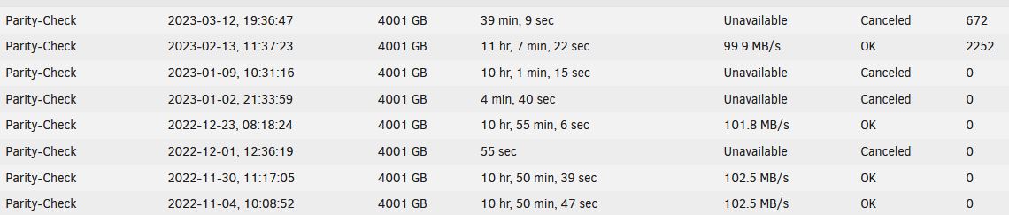

  14. For the past month, I'm seeing thousands of errors reported when I click on the parity check button. Some history... The IO CREST Internal 5 Port Non-Raid SATA III 6GB/SJMB585 SI-PEX40139 is installed but no cables are plugged into it. ( stopped using it before 12/1/22 because I was still getting UDMA CRC errors pointing to bad cables, which were all replaced, and I never bothered removing it from the PCIE slot) I instead use the JEYI NVMe M.2 to 5 Sata Adapter, Internal 5 Port Non-RAID SATA III 6GB/s plugged into GLOTRENDS M.2 PCIe X1 Adapter that was installed before 12/1/22 and it fixed the UDMA CRC errors I was seeing with the io crest card above. I even did a complete (100%) parity check 12/23/22 and there were 0 errors. On 1/2/23, parity check had started, but I cancelled it after 4 minutes. On 1/9/23, ran another parity check for 10 hours (about 90% done), but I also cancelled it accidentally (due to shut down without knowing a parity check was running). Still 0 errors. On 2/12/23 ran a full parity check, got 2252 errors, that I did not noticed was showing in the parity check history. On 3/12/23, noticed the 2252 errors on the history (never ever had this happen before in the past years), and started a parity check again. Within 39 min, 672 errors were showing and I cancelled it. I only use the server about once or twice a week for a couple hours. So the smart power on total is about 7 months >>9Power on hours0x0012100100000Old ageAlwaysNever5159 (7m, 2d, 23h) I recently upgraded unraid from 6.9.2 to 6.10.3, and there errors might have started happening after? If there's some log that has that date of upgrade, it would be good to know if there's any correlation. Yes, I know correlation is not causation, lol. I have attached tower diagnostics. Questions: 1. Does running further parity checks with the write corrections to parity, cause my currently stored data files to corrupt more or is this only affecting parity data stored for recovery? I.E. should I not do this until a cause is found? 2. Are the errors happening on the actual drives, or is something else failing? 3. Should I not be adding anymore files to these hard drives? 3. Suggestion for troubleshooting this? tower-diagnostics-20230326-1515.zip
