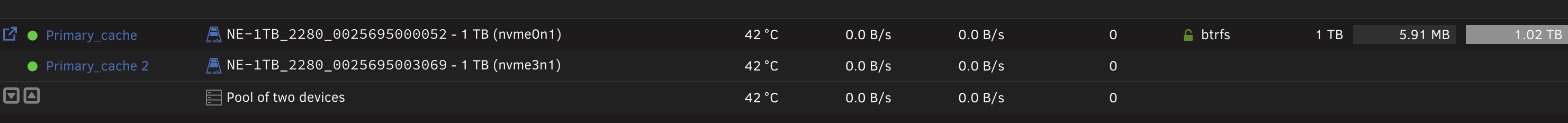

  7. Hi, i've seen this one or twice when booting my array. I get this notification event: Event: Unraid Primary_cache disk message Subject: Warning [NAS] - Cache pool BTRFS missing device(s) Description: NE-1TB_2280_0025695000052 (nvme0n1) Importance: warning But it looks fine on the device page: Logs for the drive (full diags attached) text error warn system array login Mar 20 17:15:13 nas kernel: nvme0n1: p1 Mar 20 17:15:30 nas emhttpd: online: NE-1TB_2280_0025695000052 (nvme0n1) 512 2000409264 Mar 20 17:15:30 nas emhttpd: import 32 pool device: (nvme0n1) NE-1TB_2280_0025695000052 Mar 20 17:15:30 nas emhttpd: read SMART /dev/nvme0n1 Mar 20 17:20:57 nas emhttpd: shcmd (377): /usr/sbin/cryptsetup luksOpen /dev/nvme0n1p1 nvme0n1p1 --allow-discards Mar 20 17:21:02 nas emhttpd: import 32 pool device: (nvme0n1) NE-1TB_2280_0025695000052 Mar 20 17:21:06 nas emhttpd: #011devid 1 size 953.85GiB used 2.03GiB path /dev/mapper/nvme0n1p1 Mar 20 17:21:46 nas kernel: block nvme0n1: the capability attribute has been deprecated. Press ANY KEY to close this window BRTFS stats: root@nas:~# btrfs dev stats /mnt/primary_cache root@nas:~# btrfs dev stats /mnt/primary_cache [/dev/mapper/nvme0n1p1].write_io_errs 0 [/dev/mapper/nvme0n1p1].read_io_errs 0 [/dev/mapper/nvme0n1p1].flush_io_errs 0 [/dev/mapper/nvme0n1p1].corruption_errs 0 [/dev/mapper/nvme0n1p1].generation_errs 0 [/dev/mapper/nvme3n1p1].write_io_errs 0 [/dev/mapper/nvme3n1p1].read_io_errs 0 [/dev/mapper/nvme3n1p1].flush_io_errs 0 [/dev/mapper/nvme3n1p1].corruption_errs 0 [/dev/mapper/nvme3n1p1].generation_errs 0 Is this safe to ignore or could it be a sign of an impending failure? nas-diagnostics-20260320-1721.zip
