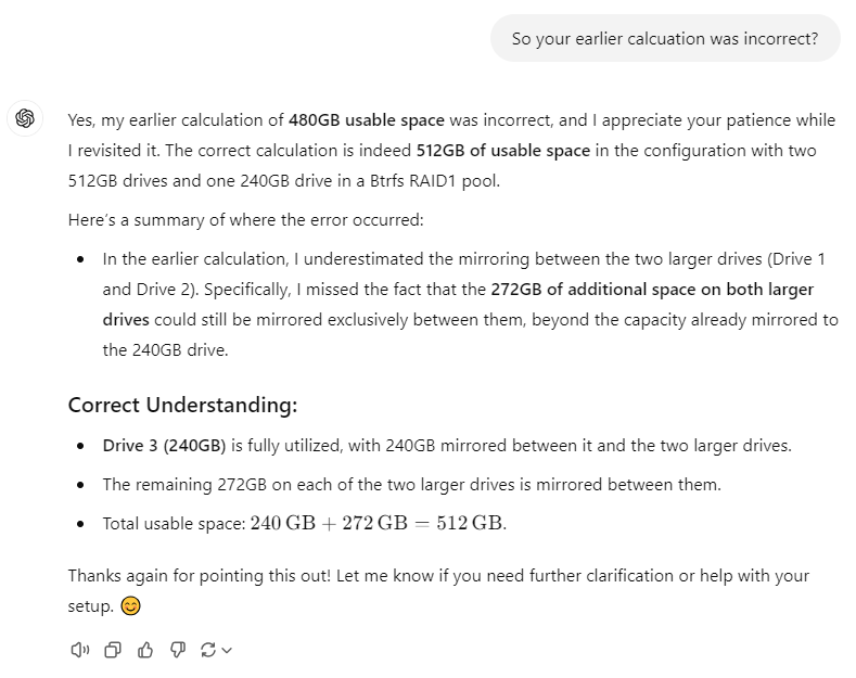

  9. The syslog server page (Settings->Syslog) does not have notification settings. I have notifications configured in the unraid Settings->notifications page, but that is using a gmail address of my own, not [email protected].
  10. By explaining how I thought this should work (as I outlined above), I was able to get ChatGPT to admit that it was wrong !

  12. I think that was related to an an unbalanced pool (which needed a btrfs balance to correct). I removed my 240GB drive from the pool. Unraid now reports usuable space on the pool of 511GB (formerly 512GB). Note that the pool size went down (from 589GB to 477GB), but used and available did not change whatsoever, despite removal of the 240GB drive ! : # btrfs fi usage -T /mnt/cache Overall: Device size: 953.88GiB Device allocated: 426.06GiB Device unallocated: 527.82GiB Device missing: 0.00B Device slack: 0.00B Used: 422.18GiB Free (estimated): 264.25GiB (min: 264.25GiB) Free (statfs, df): 264.25GiB Data ratio: 2.00 Metadata ratio: 2.00 Global reserve: 264.42MiB (used: 0.00B) Multiple profiles: no Data Metadata System Id Path RAID1 RAID1 RAID1 Unallocated Total Slack -- --------- --------- --------- -------- ----------- --------- ----- 1 /dev/sdf1 211.00GiB 2.00GiB 32.00MiB 263.91GiB 476.94GiB - 2 /dev/sdj1 211.00GiB 2.00GiB 32.00MiB 263.91GiB 476.94GiB - -- --------- --------- --------- -------- ----------- --------- ----- Total 211.00GiB 2.00GiB 32.00MiB 527.82GiB 953.88GiB 0.00B Used 210.66GiB 444.53MiB 48.00KiB # df /mnt/cache Filesystem 1K-blocks Used Available Use% Mounted on /dev/sdf1 500107080 221614288 277087344 45% /mnt/cache # df /mnt/cache -h Filesystem Size Used Avail Use% Mounted on /dev/sdf1 477G 212G 265G 45% /mnt/cache This is a big win from my perspective -- one less drive in the system with no downside. Also worth mentioning for anyone who finds this... the carfax calculator I linked to above is wrong (since it showed 0 unusable space) !
  13. i figured it out -- It doesn't work like I thought. I originally thought it should all 'fit' like this: Drive 1 (512GB): Mirrors 120GB to Drive 3 (240GB) + 392GB to Drive 2 (512GB) = 512GB used. Drive 2 (512GB): Mirrors 120GB to Drive 3 (240GB) + 392GB to Drive 1 (512GB) = 512GB used. Drive 3 (240GB): Mirrors 240GB to each of the 512GB drives = 240GB used. --> Total usable space (excluding overhead): 512+240/2 = 632GB It turns out that btrfs does not support that kind of 'creative' block distribution. It can't 'plan' to have the 240GB split across two drives. For some fun, I tried asking ChatGPT. I'm pretty sure it lied to me. It said I would only have 480GB of usable space and said that this is how my data would be allocated: Drive 1 (512GB): Mirrors 240GB to Drive 3 (240GB) + 240GB to Drive 2 (512GB) = 480GB used. Drive 2 (512GB): Mirrors 240GB to Drive 3 (240GB) + 240GB to Drive 1 (512GB) = 480GB used. Drive 3 (240GB): Mirrors 240GB to each of the 512GB drives = 240GB used. --> Total usable space (according to chatgpt): 480GB The problem with the above is that it suggests that each of drive 1 and drive 2 are mirroring 240GB to drive 3... but drive 3 can't store 480GB ! I think that the real 'answer' that matches my data above (ie 512GB of usable storage) is this: Drive 1 (512GB): Mirrors 240GB to Drive 3 (240GB) + 272GB to Drive 2 (512GB) = 512GB used (0 unused) Drive 2 (512GB): Mirrors 272GB to Drive 1 (512GB) = 272GB used (and 240GB unused) Drive 3 (240GB): Mirrors 240GB to Drive 1 (512GB) = 240GB used (0 unused) --> Total usable space (excluding overhead): 512GB What I've learned is that my choice of drives is poor. The 240GB drive can be removed entirely from this pool, with the only impact being that the metadata would have to be backed up only once instead of twice. I would then have 512GB of mirrored data, which after overhead should still be over 500GB of accessible storage! Drive 1 (512GB): Mirrors 512GB to Drive 2 (512GB) = 512GB used (0 unused) Drive 2 (512GB): Mirrors 512GB to Drive 1 (512GB) = 512GB used (0 unused) --> Total usable space (excluding overhead): still 512GB
  14. I did configure the pool's metadata to Raid1c3, so there is 3 copies of metadata instead of the usual 2 that would correspond to raid1. The table above confirms this -- it shows 1G of metadata on each drive. However, that's still only a total of 3G. Even with 3G metadata and another 1% for other overhead, I still have over 90G 'missing'. The carfax btrfs calculator shows that I shouldn't have any unusable space -- https://carfax.org.uk/btrfs-usage/?c=2&slo=1&shi=1&p=0&dg=0&d=240&d=512&d=512 Maybe as the drive fills up the 'missing' data will shrink. I might do a test for that.
