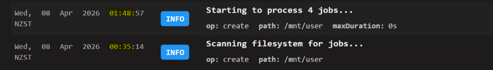

any way to limit which shares it searches for _par2cron? takes way too long to search through 15 drives that it shouldnt be searching.

By the way, what @paulio23 mentioned is a bit of a problem for me too. I added markers to 4 movies for testing. After manually kicking off the Create task, it took over an hour for it to get going.
Thanks for the responses, that definitely feels like it's too long. I'll look into it, how many disks and TBs do you have? Ideally if you know/could check how many files your /mnt/user contains, I could tell if it's a bug or really that slow because of the amount of files. Also, was the indexing always this slow or it got massively worse with this week's update?
I suspect it's the sheer number of small files and folders, but they all sit outside of the of folder I'm actually interested in running this on. If there is a way of limiting the plugin to specific paths, that would be great.
This setup consists of 24 x 12TB SAS drives + 6 SSDs for cache. Overall speed is quite good.

As you can see the difference in duration there is rather significant.
I honestly don't know how slow it was prior to the glob updates. I don't recall it being particularly slow or snappy. Most of my tests were done on a different machine.
Edited by Karools
Was this during a parity check or something that could impact I/O?
Because I cannot replicate this, a similar setup with 4 million files completes in less than 10 minutes here.
I'm optimising hot paths some more, but I cannot figure out what would cause a one hour filesystem scan.
Unless it's something in your environment that's severely bottle-necking I/O, but your find is much faster...
Anything unusual come to mind about your environment or setup as a whole?
I'll look into allowing choice of path or shares... but still the one hour seems way out of proportion here.
Nope, no parity check or anything too IO intensive.
I had to replace a drive over the weekend, which is actually what prompted me to go looking into the integrity plugin - and ultimately lead me to your fine par2 implementation.
