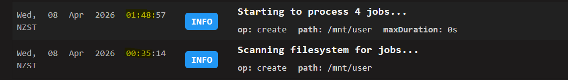

  6. Firstly, the curly bracket issue is indeed fixed now with v0.2.2 - thank you very much. It's working perfectly. And the nested idea sounds great, it would certainly be of use to people who use *arrs for automation, at least for Movies. For current/ongoing Series not as much, for obvious reasons.. but there are ways to work around that 🤔 By the way, what @paulio23 mentioned is a bit of a problem for me too. I added markers to 4 movies for testing. After manually kicking off the Create task, it took over an hour for it to get going.
