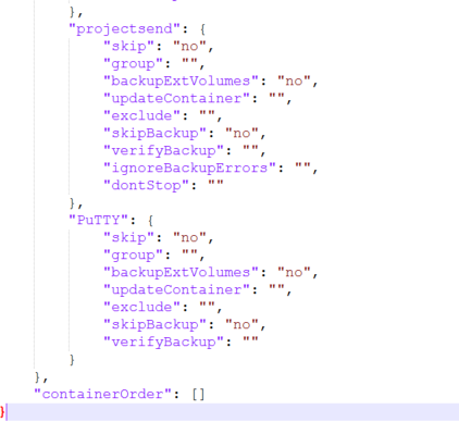

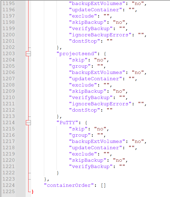

Also noticed my config.json doesn't have any containers listed after" PuTTY" and coincidentally when I try to change anything, as in skip the container yes or no, for containers BELOW PuTTY in the list is what making setting changes to doesn't save.

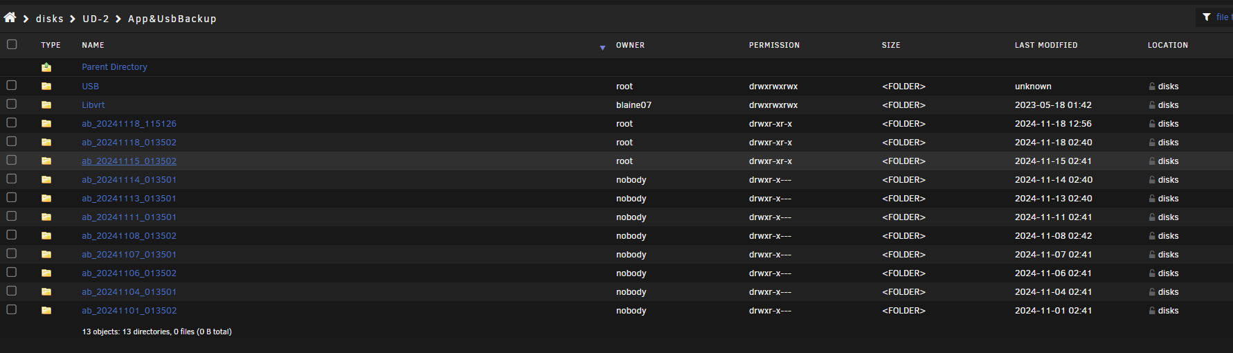

Around time it quit working it changed the user that is creating the back up folders, too?
EDIT again: is there a limit on number of lines that can be contained in this config.json file? I do admittedly have a ton of containers. I dunno, so weird that creator of folder recently changed and config file only goes to "PuTTY" and no containers below the "P" are listed in the config.json.
Edited by blaine07

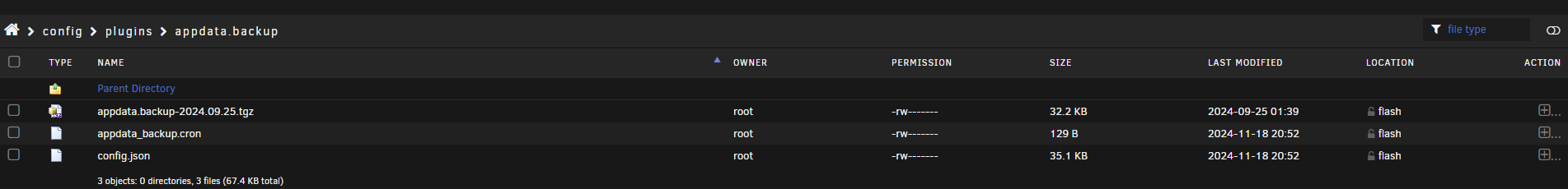

Everytime I try to run a backup and it locks up I am having to manually reboot server; it's been rebooted many times.
Permissions attached.
What other ideas might you? Not sure why backup folder suddenly creating as a different user, either? On global log I glanced but didn't see anything telling.
EDIT: config.json has this many lines; if it matters:
Edited by blaine07
If I delete a container above "PuTTY" in the list it DOES add for example "Quickshare" container to config.json below "PuTTY" and save file successfully.
We've reached some sort of container or code line limit in the config.json; has to be somehow.
Not in the json. This can be huge without issues.

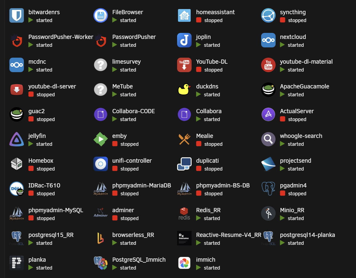

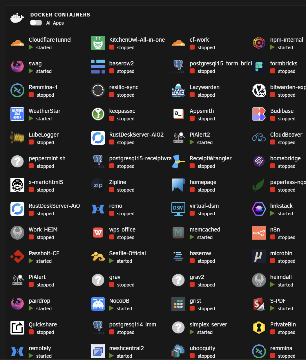

maybe a limit for the web form? How many containers do you have?

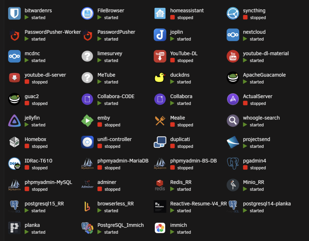

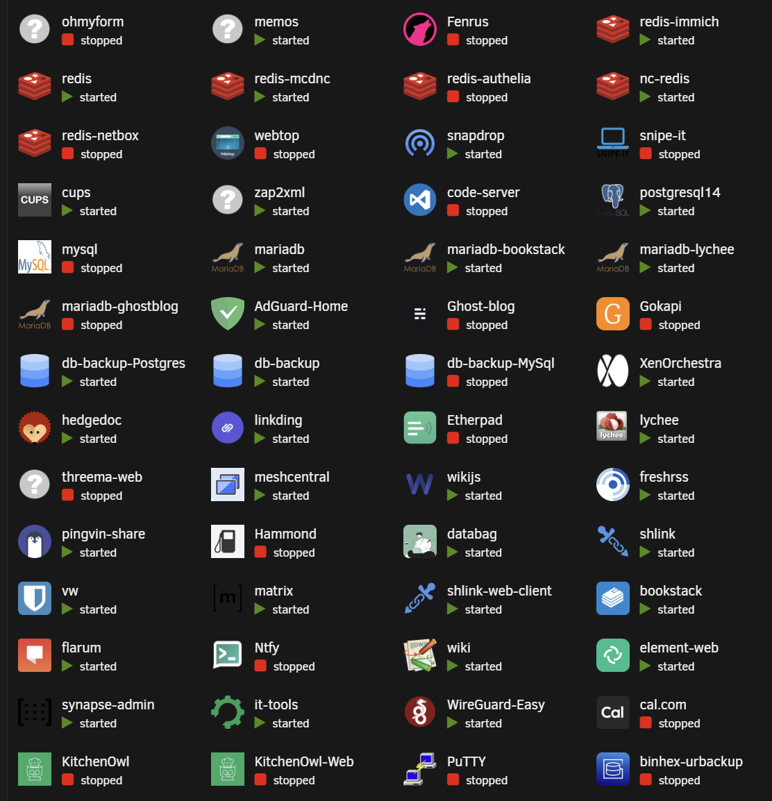

Is there a easy way to get a number?

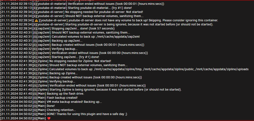

I was finally able to successfully get a backup to complete last night; Debug ID: 224a8953-127f-4f2c-b9d3-2086d3b969f5
I oddly noticed the hangup in mine seemed to be:
Zipline was last container to back up but the flash drive took OVER 2 hours to back up? That's never been the case before... Yeah, I definitely dont think all the the config.json is being respected; in my case past the ~1500 lines or whatever - whether it's receiving it all back to save I have no idea of lol

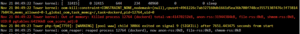

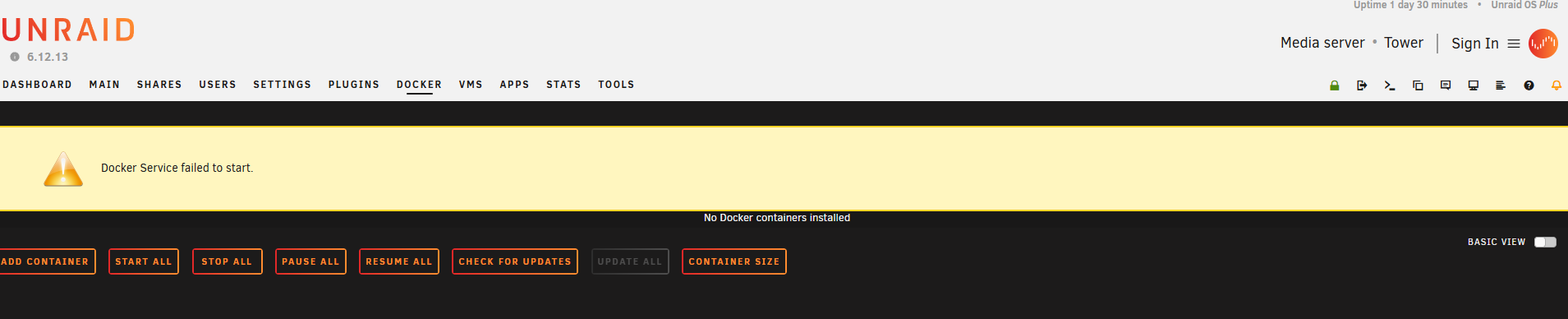

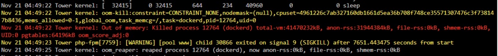

Oh, found another issue; so server will have to be restarted; not sure why docker service would've ever stopped?:
Only thing in Unraid log I see maybe helpful:
Edited by blaine07
