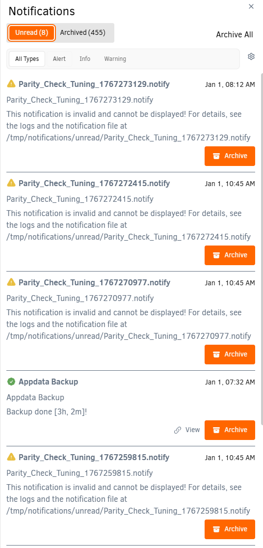

  2. FYI, still seeing these notifications for the following events (so far) with nothing going on in the syslog around the same timestamps:
  3. thank you for the update! I am still seeing the same invalid notifications. Hopefully the following is helpful in some manner! the notifications: from the log at the same time as the 8:12am notification, none of the others seem to correlate with anything in the log:
