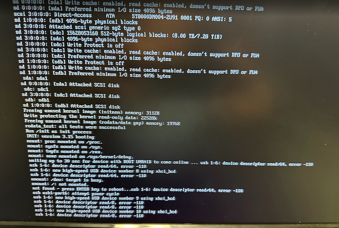

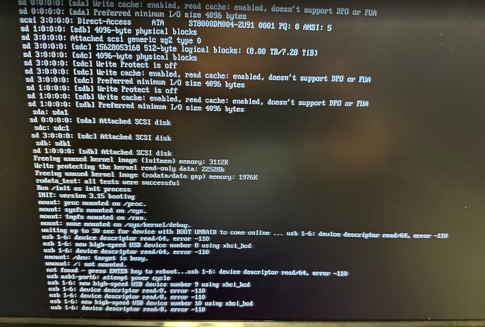

  2. I tried a fresh 7.2.2 install on the old USB and a different USB but I still got the same error. I tried the front USB port and still got the error. I removed all other USB devices, except the keyboard and got the error. I tried one of the rear USB ports and it booted. So it looks like there may be an issue with some of the USB ports on my motherboard. I restored my Nov 2025 backup and got up and running. That was in OS 6.12.4. I am now upgrading to 7.0.1. I will try the original USB port again later on to see if I still get the error or whether it was something sporadic. Very strange.
  3. How do I backup the current flash drive since I can't boot into the Unraid OS? I have a backup that is from Nov 2025, and I haven't changed much on the system since then. So I am happy to restore this. Should I try to recreate a boot flash drive on the existing USB drive using the USB tool to create a 7.2 boot disk? Then copy over the /config file from the backup zip file? Is that essentially the same as restoring a full backup? Or even just try restoring the Nov 2025 backup? How do I tell what version my backup ZIP drive is? I think it is 7.2.2 but I am not 100% sure. This backup is from Nov 28, 2025 which is one week after 7.2.2 was released. I presume this would be in one of the files in the backup? which one?
  4. Overnight I had a power outage. My system has a UPS so this shouldn't cause problems, but I don't know how long the outage lasted. My system was unresponsive. I tried powering off and back on and got error 110. I tried shutting the power for 10 minutes but it still won't boot up. The system keeps trying to find a boot drive but I keep getting this error -110. The system has run fine for several years. The boot drive is a Samsung flash drive that is attached to the USB header on the motherboard. I have not touched anything to do with the boot drive in a long time. I believe the system is running Unraid 7.2.2 I Googled and there doesn't seem to be much on this topic. I am guess that the issue is that my flash drive is not working.
