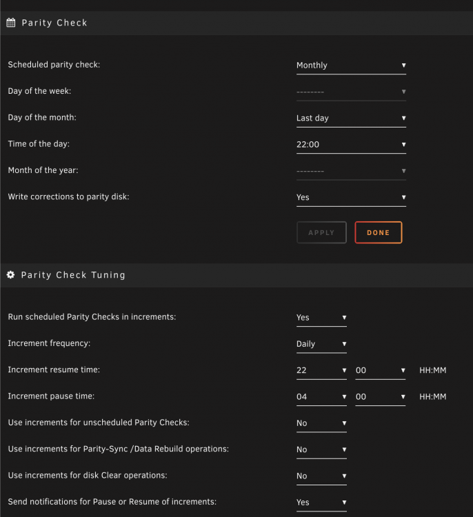

Hi there. Thanks for your time creating this plugin, I'm excited to try it out. My current parity checks only take about 10 hours, but I'm looking at upgrading to some bigger drives this fall, so this plugin should come in handy.
Based on my settings in my screenshot, I'm expecting the parity check to start Sept 30th (last day of the month) at 10pm, then pause at 4am on Oct 1st, then resume Oct 1st at 10pm, and repeat until finished. Does that look right?
Yes - you should get the behaviour you want.   In this case the check should finish during the second increment if there are no problems.   With bigger drives you would get more increments as the total execution time increases.
