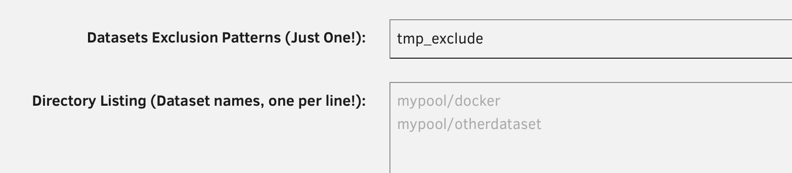

[PLUGIN] ZFS Master
I went back and did an AI search on the issue, and it seems the issue for me was that i had to just put some dummy data into the exclude folders setting. Even though there was nothing in there. It’s seems to be all back now.
