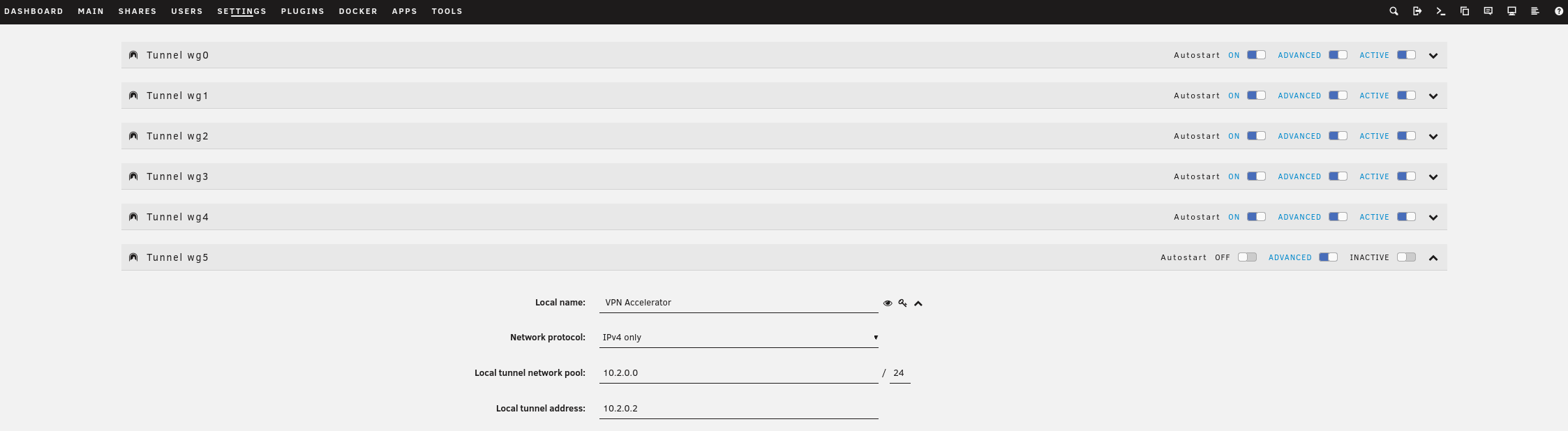

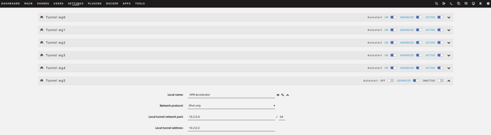

Hello, With spaceinvador's i added a wire-guard Tunnel wg0 and with BitTorrent, for the most part it is working now i do get a WAN ip from from the eindpoint of de VPN. But when connecting with gui with tailscale ip i can't connected to the docker that has the wg0 network. Adding "ip route add 100.64.0.0/10 dev tailscale1" will only allow communication out to the fairphone right? So is ip route add 100.0.0.0/10 dev tailscale1" not the way to go? So that all devices can connect to the dockers? I do have the following tailscale devices: fairphone 100.64.x.x. Framework 100.94.x.x Proxmox 100.78.X.x UbuntuVM 100.97.x.X I saw the post of @vw-kombi put was wondering if adding "ip route add 100.64.0.0/10 dev tailscale1" is always the IP to addd. Because my tailscale ip is 100.81.x.x , Do i need to change the command to "ip route add 100.81.0.0/10 dev tailscale1" ? Is there a setting in the tailscale plugin or Wireguard network settings that allows this? When i want to run other docker containers on wg1 or wg2, ect will this also work? https://forums.unraid.net/topic/195755-using-wireguard-on-some-containers-to-access-vpn-this-stops-tailscale-from-accessing-the-container/#comment-1596813 Thanks in advance.
Importing Wireguard config
Hello, Just checking out if this is a future of a bug, but when i import a Wireguard config. The Local tunnel network pool stayś the same after every new wg0,wg1,wg2,wg3, ect. This is causing the issue that the handshake works but there is no network for the docker for example. Is this part of the issue with 7.2.2.?

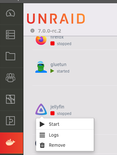

LibreWolf. I do have issue's with not reading a log file or the terminal because u am unable to scroll down, Did a quick screen record of the issue. Than i have to zoom in/out to see the outcome Screencast From 2026-01-20 19-34-01.mp4

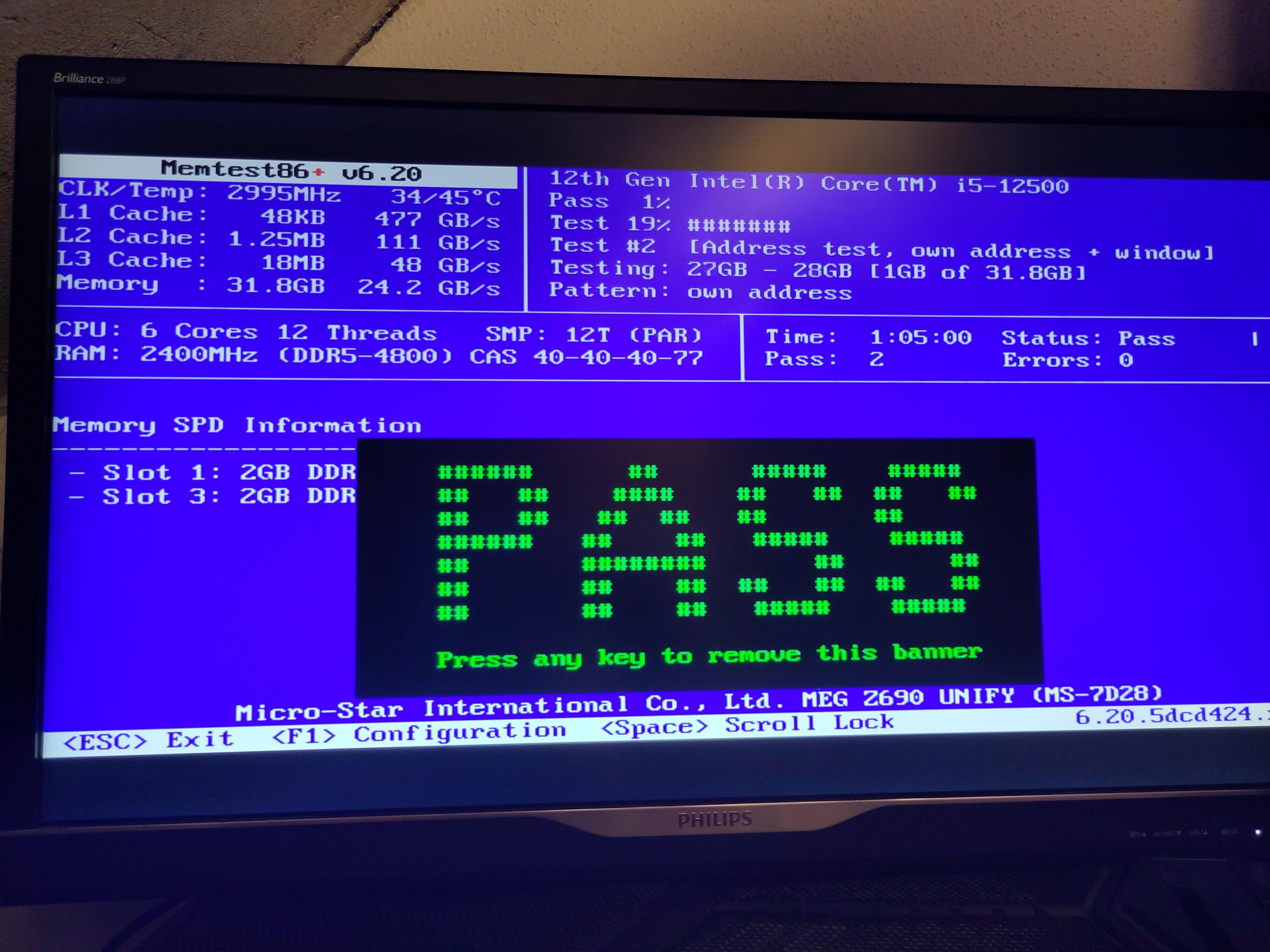

Yes, This is only with the settings as mention above 1. Recreate it using the USB tool 2. Restored "super.dat and the pools folder for the assignments and disk.cfg" 3. I also did a second memory check with same results. But i can run the parity without any issue's until i install or start the community plugin together with a running parity. So i am wondering if the community plugin is using some "corrupt" file on the disk that could get it to crash. May-by if i can replace/delete that file it would solve the issue? At this moment i deleted the community plugin again en restarted the server and parity, It's now running the parity check. I will let the server run like this. With only the parity started and without the community plugin to see what will happen. I did a new diag with the current setup for you(?), Thanks. tower-diagnostics-20250212-1905.zip

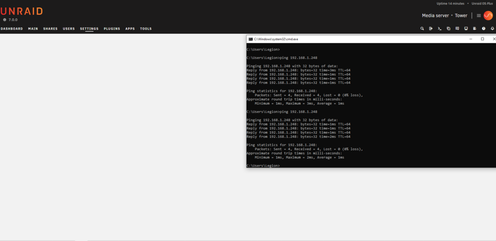

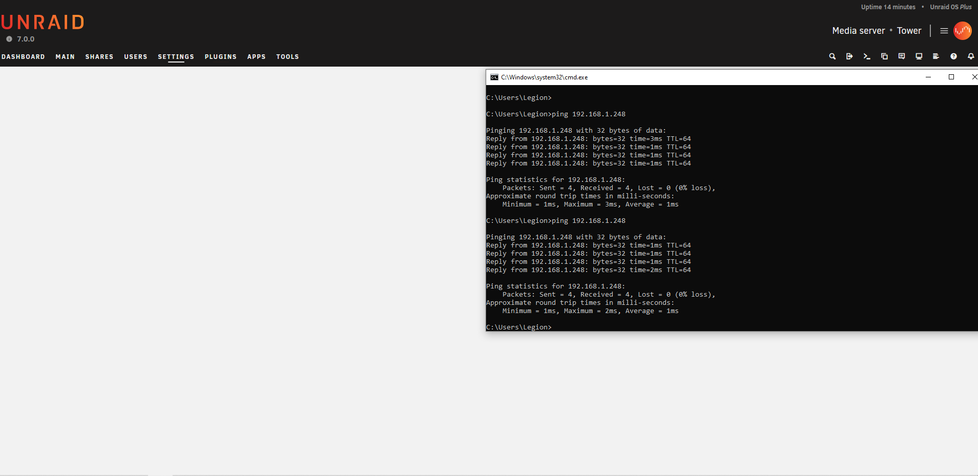

Hi, I tested it with Firefox, Edge en Librewolf. In normal mode & private mode. On my other notebook it's the same issue. The strange thing is that it just started when installing the "Community plugin" in combination with a running Array. "Community plugin" with the array offline doesn't give a problem in de browser. But when i click to start array after a few sec. i get the screens like above.
Cache drive unmounted.

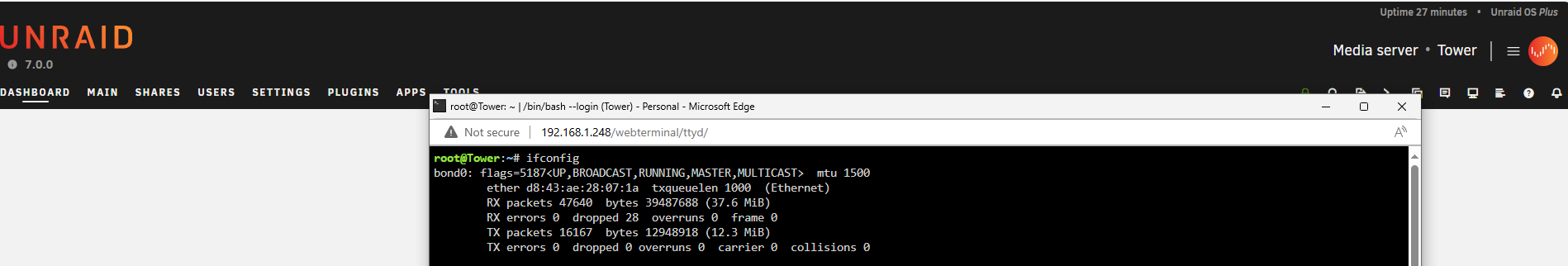

Hi Jorge, I still have the same problems so i decided to do replace the USB key with you steps. 1. Recreate it using the USB tool 2. Restored "super.dat and the pools folder for the assignments and disk.cfg" I booted the system and manually started the array without any problem. But when i install the "Community plugin" the systems start showing blank screens everywhere. Like in the screenshot i am able to ping the server but the webpage is unusable. I am able to use the terminal for example Ifconfig. But clicking on the log button doesn't do anything. Do you have any suggestions for this issue? Thanks

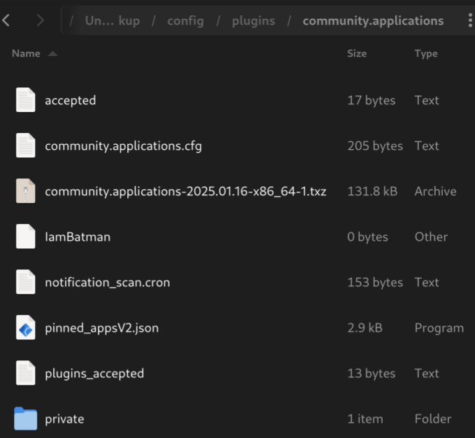

Hi Jorge, I made a back-up of the 3 plugin folders (Plugin, Plugin - error and plugin removed) then i emptied them and did a reboot. Seems that the system is running good now. I reinstalled the com. plugin. I do notice that my dockers are missing some functions. Do you now the solution to this? I found out that when i re-added the files from template-user the option is back. Do i have to put other files back, I emptied all files in (Plugin, Plugin - error and plugin removed) Also i found Batman?.. This file is not pressed in the new installed com.plugin THnaks
