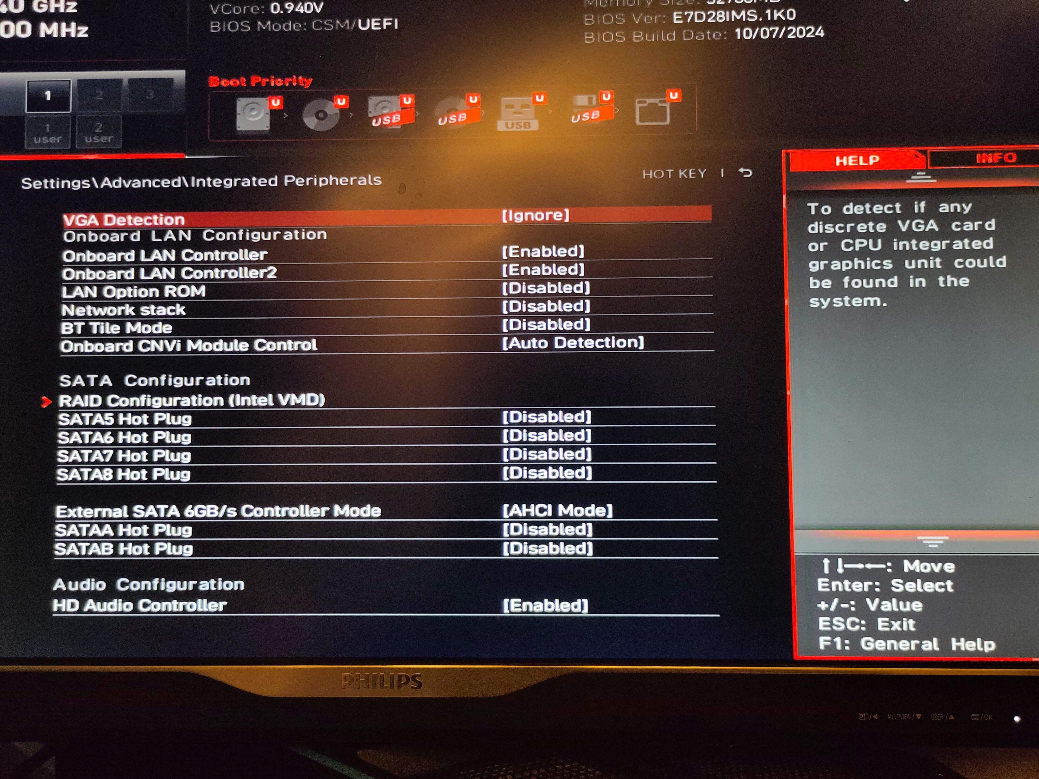

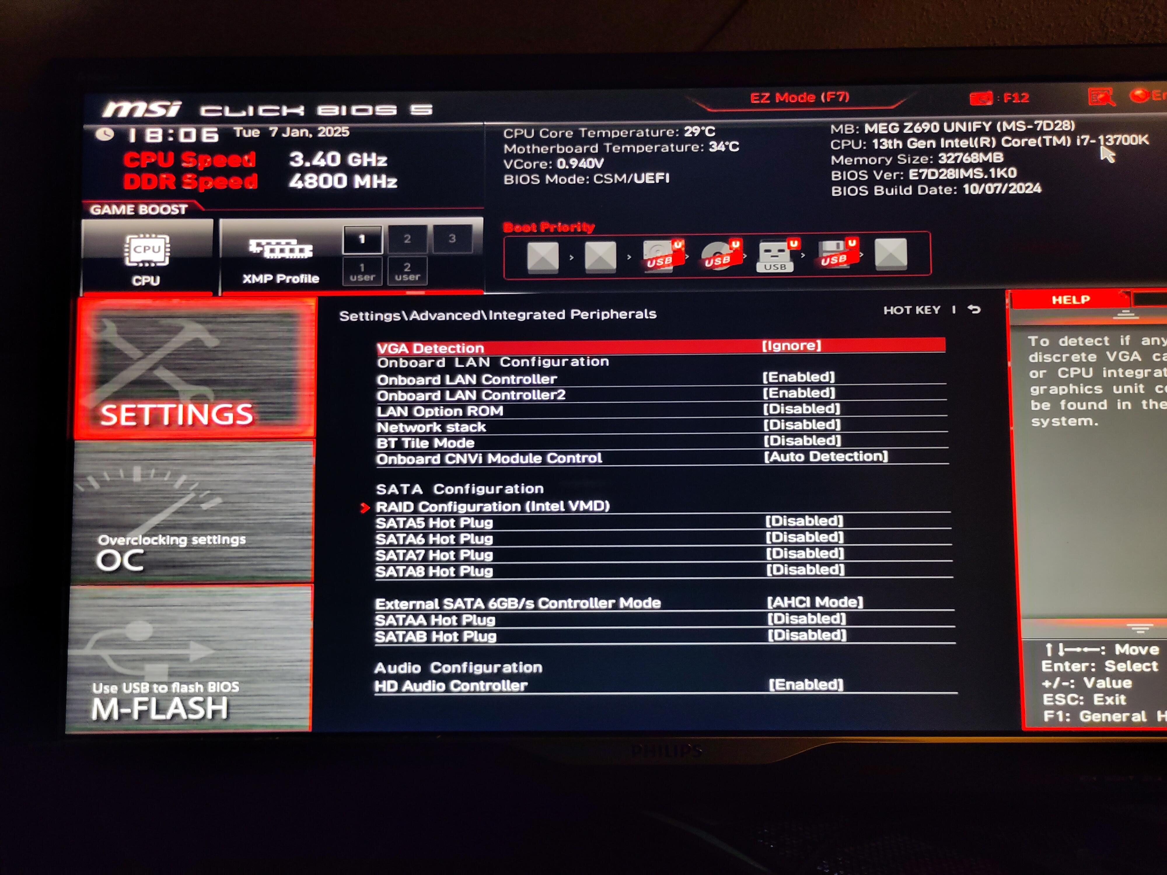

  23. Hello, I got into problems after i wanted to open the webpage of unraid and clicked selected the *http://192.168.1.248:9980/webGui/include/Boot.php" link from my browser history without looking to the exact link, My server did than a shutdown and thatś when the problems started. I got the message as seen on the image "Kernel Panic", After a reboot(reset). The Cache drive is dismounted as seen in the image also there is the message "Unclean shutdown Detected". What is now the best way to proceed i am able to add the cache drive. How can i do this without the data-loss on my cache drive? Thanks in advance,

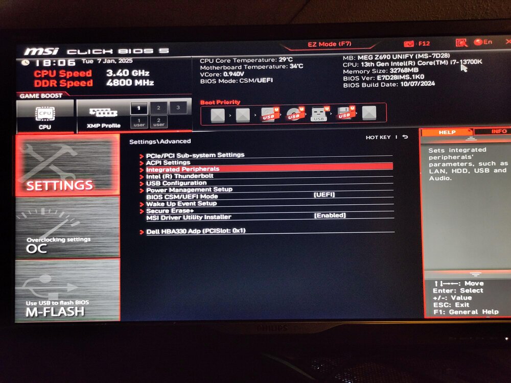

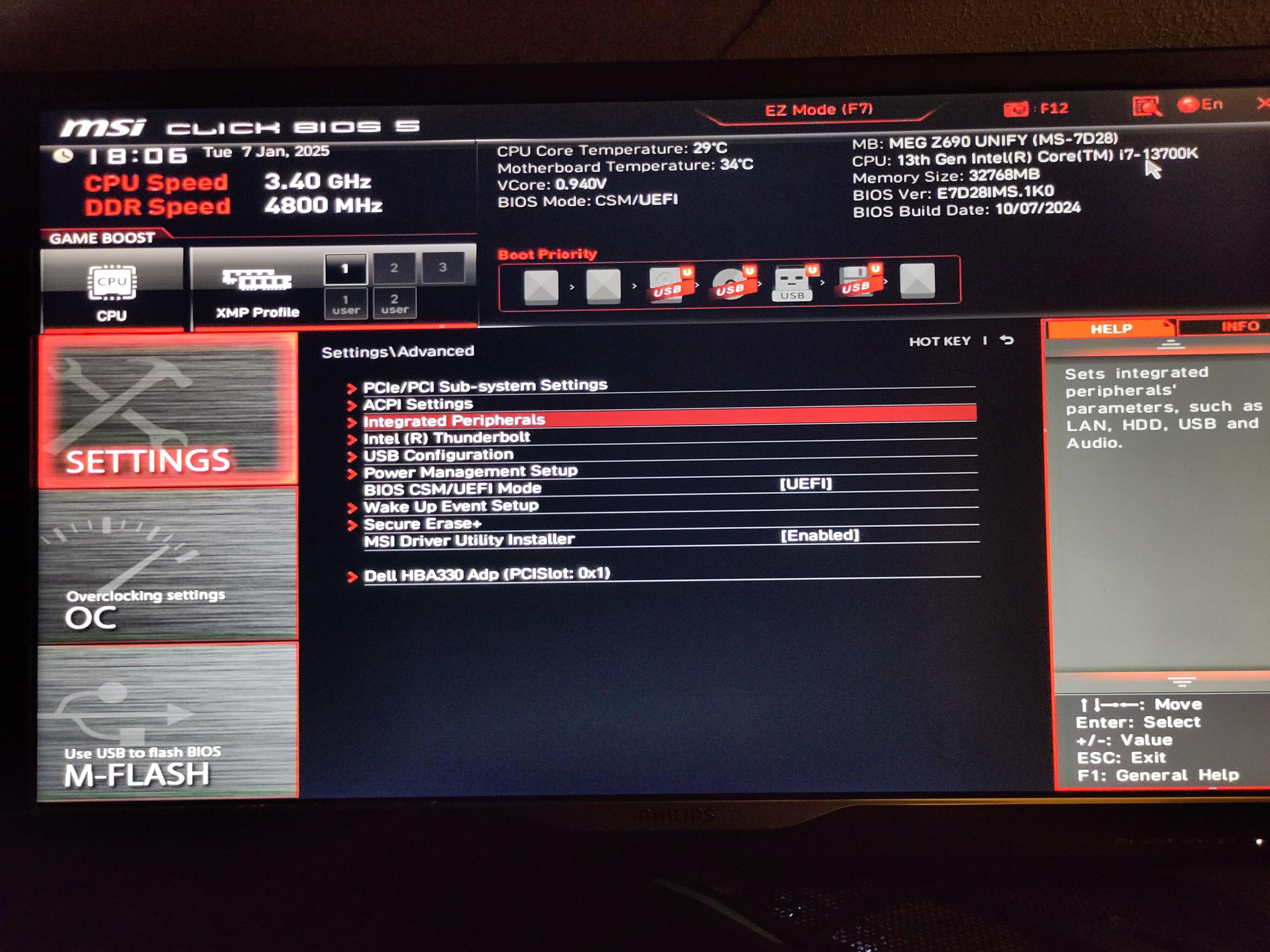

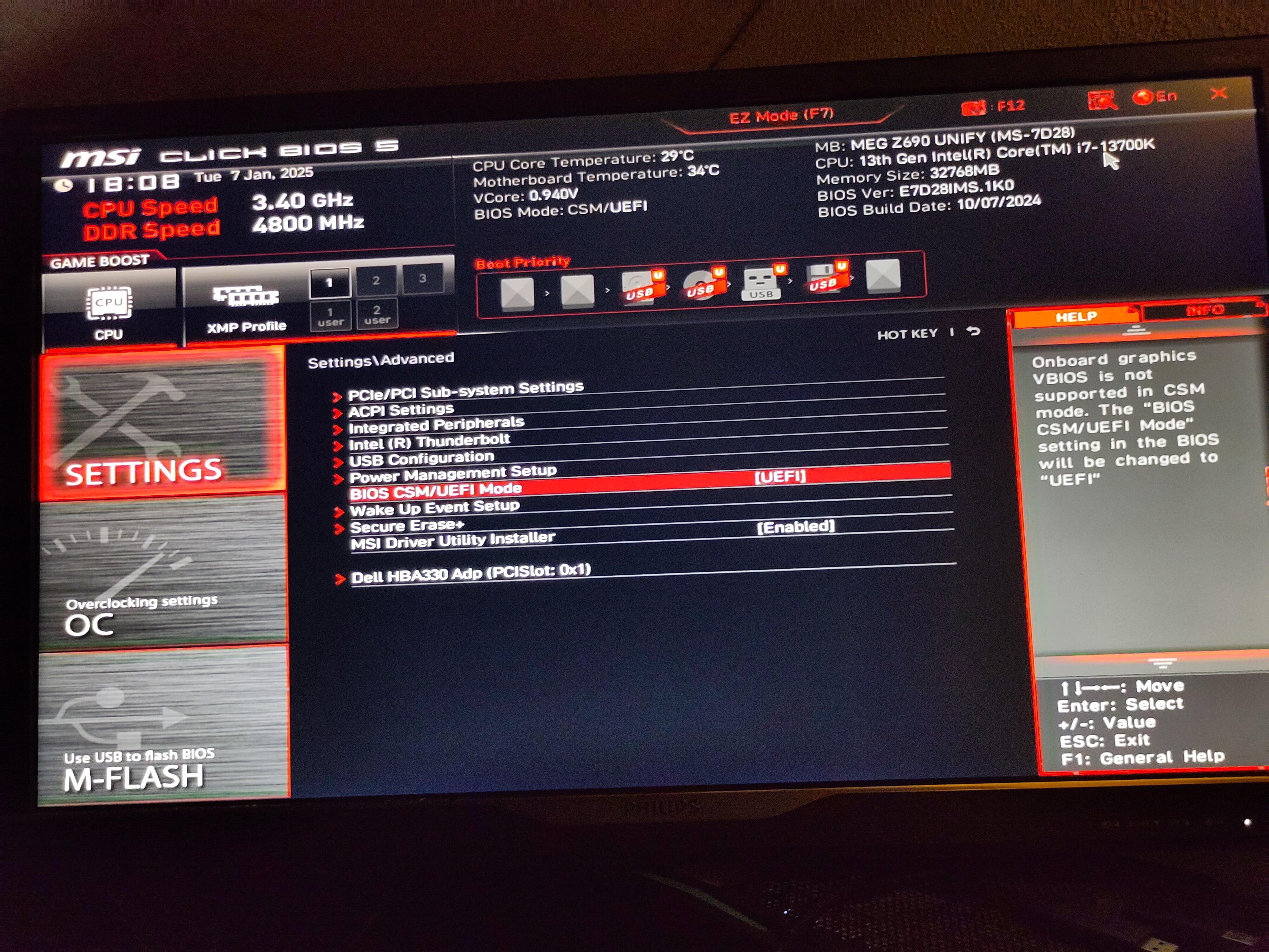

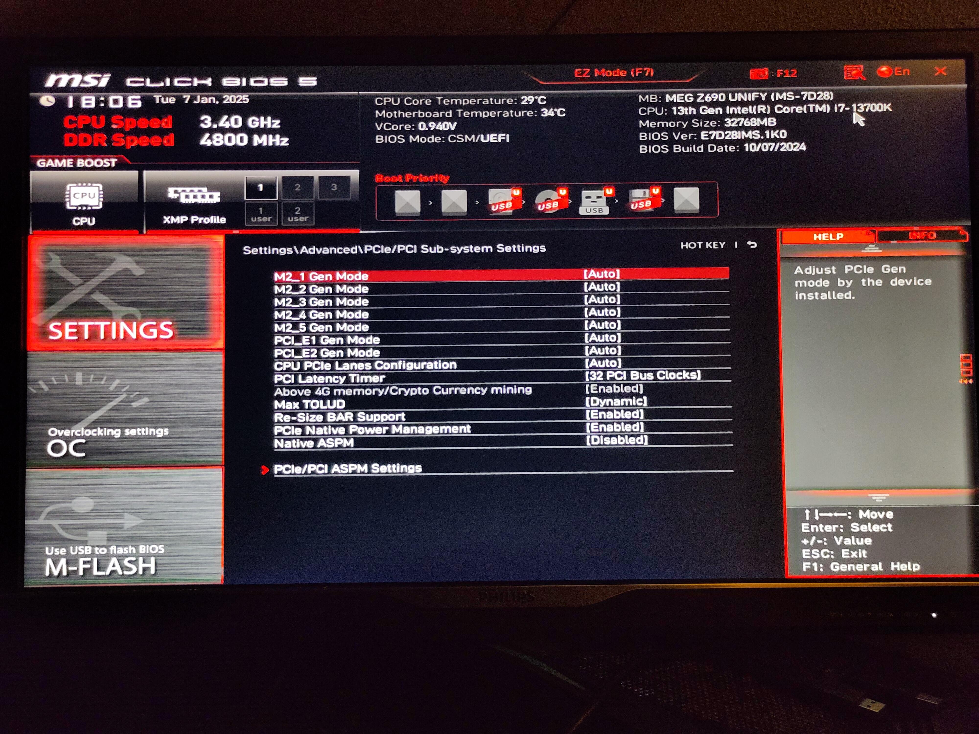

  24. Thank for your reply i checked the systemboard but cant find the setting,,, I added some screenshots of the setting. @SimonF*The systemboard in the video is btw from a other type
