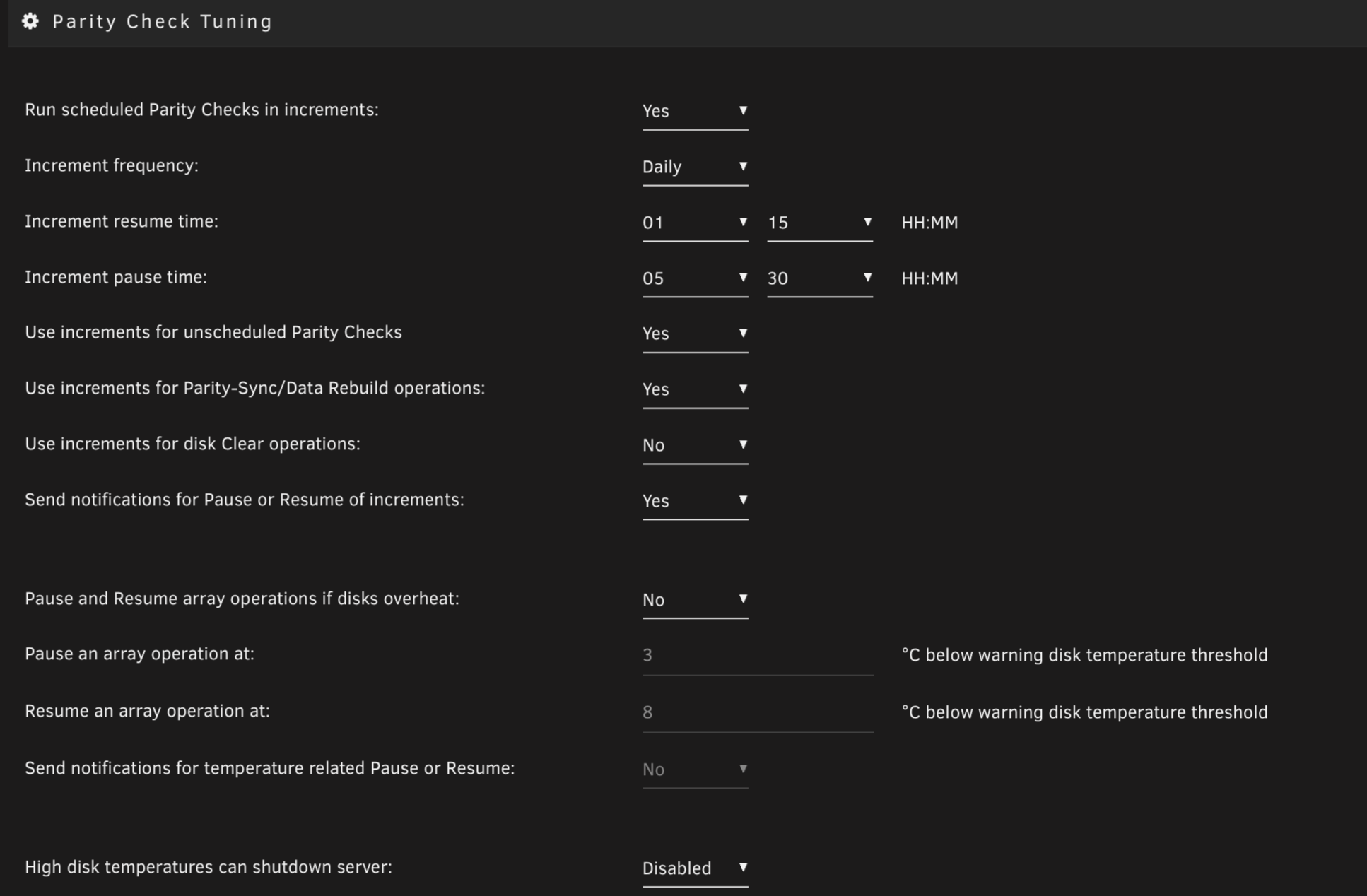

Hi, love the plugin, thank you.
I have an issue where if I have an unclean shutdown and and unscheduled parity check starts, it does not pause unless I pause it or until the designated time to pause it occurs.
For example, if I have an unclean shutdown at 18:00, the server will boot back up and the parity check will run until 05:30 when I have it pause, but parity checks should only be happening from 01:15-5:30 causing the parity check to run during prime time.
Any ideas how to solve it?

I am afraid that at the moment that is expected behaviour.    The normal expectation is that you want such checks to complete as soon as possible to get the array back to a consistent state.  If you do not want this then you are expected to do a manual pause so that the scheduled pause/resume of increments can kick in.   I cannot think of a robust way of the plugin doing anything different but am open to suggestions.
The plugin DOES detect that an unclean shutdown has occurred but at the moment this is only being used (in the next release of the plugin) as a condition meaning any running array operation cannot be restarted from its position previously reached when the array was stopped.

Thank you for letting me know it isn't anything on my side. I would like the option to immediately pause an unscheduled parity check and follow the schedule, but understand your reasoning for not having it.

You certainly can cancel the parity check if you wish, but be aware that if you have a drive failure while parity is out of sync, the rebuilt drive will have bit errors. Often times that results in data loss.

At the moment I am not prepared to implement an option that would auto-pause the parity check that happens after an unclean shutdown.
the implementation I am currently testing will auto-pause a restarted array operation that was paused at the time of a shutdown, but that will only happen after a clean shutdown.    As soon as an unclean shutdown is detected then the decision is to err on the side of safety.
if I get convinced that an auto-pause of the automated check after an unclean shutdown is a feature would be desirable then it could be added but it is not going to be in the next release I make.

The plugin does not seem to honor the tuning schedule. I have my parity check to pause at 4:30AM, but when I woke up today the parity check was still running.
I can see the following in the log at the time it was supposed to pause,
2021-01-02 04:30:01 5 unraid01 CROND exit status 126 from user root /usr/local/emhttp/plugins/parity.check.tuning/parity.check.tuning.php "pause" &> /dev/null

Strange - that implies execute permission is not present on files used internally by the plugin.  I have just checked and if I remove and then re-install the plugin I can see the permissions are not as expected.  Not sure why that is suddenly an issue but I should be able to easily fix it by explicitly setting them as part of the plugin install processing.
Just pushed an update that fixes the permissions issue.
Still not worked out what changed to mean this happened in the first place but the 'brute force' fix I have applied should mean it can not happen again in the future.
