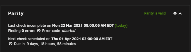

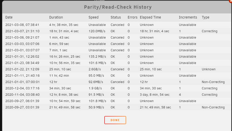

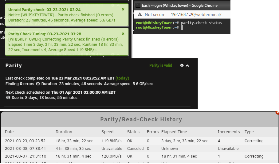

I remeber when I ran this plugin earlier (up to this month) that the "Last Check Incomplete" status would read "Error code:paused" and not "aborted."  Is my memory faulty?  Or do I have an error here?
Just to be sure, I checked the status here:
And I the parity check has stretched over two days so far as expected.  I figure it wil take one more night to complete.
My history doesnt show anything for the parity check that started a couple of days ago.
And this morning, before it is set to pause:
and:
And just after the pause, showing "aborted" agin, instead of "paused":
and:
Edited by whiskeyjr
I ‘think’ that the messages you are mentioning are from UnRaid, and not the plugin.   The plugin is not able to change many of the standard unRaid messages - merely try and supplement them.   The standard unRaid messages are not ‘increment’ aware which can sometimes be confusing.
nothing is written to the History file until the parity check completes (or is cancelled).   Also when the check finally completes the parity history entry is initially written by the standard unRaid code with just the details of the last increment.    The plugin will later alter this entry to be correct for the whole run, but there could be a delay of minutes before this happens.    You can tell if the information is written by unRaid or the plugin by whether there are values in the last 3 columns of the history as standard unRaid does not capture this information.
Having said all that it is always possible that there is still some small anomalies on messaging that could be tidied up.   It is something I am continually looking at refining for each release.   If you ever want me to check something out the progress.save file from the plugins and the history.log files from the plugins folder on the flash can give me something to work with.
