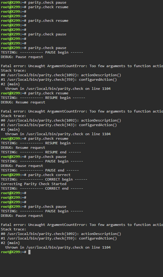

If execute in command line, I got below output
root@X299:~# parity.check resume
TESTING: ----------- RESUME begin ------
DEBUG: Resume request
Fatal error: Uncaught ArgumentCountError: Too few arguments to function actionDescription(), 0 passed in /usr/local/bin/parity.check on line 1092 and exactly 2 expected in /usr/local/bin/parity.check:1104
Stack trace:
#0 /usr/local/bin/parity.check(1092): actionDescription()
#1 /usr/local/bin/parity.check(343): configuredAction()
#2 {main}
  thrown in /usr/local/bin/parity.check on line 1104
root@X299:~#
root@X299:~# parity.check pause
TESTING: ----------- PAUSE begin ------
DEBUG: Pause request
Stack trace:
#1 /usr/local/bin/parity.check(359): configuredAction()
#2 {main}
root@X299:~#

Try again and troubleshoot, still no joy, but error only return during parity sync/check in progress.
Cause by haven't cache pool, so no mover status ?? Thanks your plugin and effort.
Edited by Vr2Io
I see the problem - I introduced a regression in the action Description function within the code.   I will fix and push out an update shortly.   It was very obvious as you used the CLI option.  I must add doing more comprehensive tests that way to my regular test plan :)
Thanks a lot, waiting for the update.

Update now available.
Hopefully no other regressions surface.   I did ensure this version successfully runs the CLI commands that were failing in your earlier report.
Please to not hesitate to report any other issues or even what you think might be just minor anomalies.

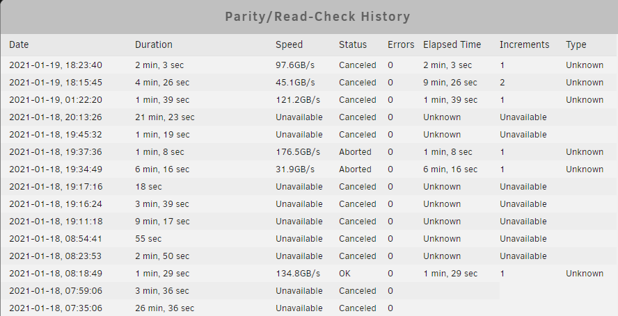

For about history record, would you review the speed figure if you have time, the figure may not useful. Seems figure will take during disk operation happen, i.e. pause operation ( pause then take the figure ) or resume ( resume then take figure without wait a steady time). So it varies a lot.
Thanks.
This SHOULD in principle be accurate.   The plugin takes into account pause/resume by working out the length of time that the process was actually running when calculating speed.   However the fact you queried it made me check the calculation and I see the speed calculation is currently always being based on the total number of sectors on the parity disk rather than the point reached.  This means at the moment it will be correct if the parity check completes but wrong if it does not.  I will fix this.
Another problem, a message ( not always there, seems no this if mount array in maintenance mode  ) was show at footnote, it mask other info., such as temperature, fan speed.
A missing $ on a variable name so I will fix this.  The effect should not be serious as it is where the plugin is trying to tell the difference between whether a check being run completed before an unclean shutdown occurred or was still in progress at the time.  The error means that the check will always (possibly incorrectly) be assumed to have been completed and recorded/reported that way.  Another thing to fix though.  What is surprising is that I did not get this flagged up in my system as I have the PHP warning level turned up on my test systems - but it is a rather obscure code path.
4 minutes ago, itimpi said:
This SHOULD in principle be accurate.   The plugin takes into account pause/resume by working out the length of time that the process was actually running when calculating speed.   However the fact you queried it made me check the calculation and I see the speed calculation is currently always being based on the total number of sectors on the parity disk rather than the point reached.  This means at the moment it will be correct if the parity check completes but artificially high if it does not.  I will fix this.
How about if calculate how many sector process per each pause period time, this suppose should be meaningful and straightforward.

When retrospectively analyzing the running of the parity check (as recorded in the file 'parity.check.progress') I was already tracking both the total size of the parity disk and the point reached by each increment.  Correcting the speed calculation was just a case of using $reachedSector instead of $totalSectors.
I will need to revisit this calculation when/if allowing for partial checks that do not necessarily start from the beginning to also take into account the start sector (currently assumed to be 0) but that is not required yet.   Not sure yet whether I want such partial checks recorded in the History - do you have a view on that?
