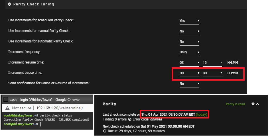

New issue today.
The parity check started when programmed, but did not pause at 0800 as expected.  Instead, it continued for an additional half-hour and paused at 0830.  Any ideas?

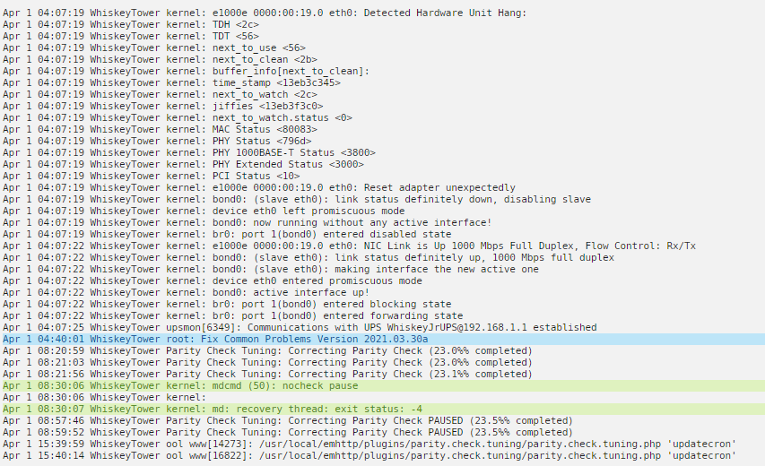

33 minutes ago, whiskeyjr said:
New issue today.
can you please post (or just look at) the contents of the .cron file in the plugins folder on the flash drive.    That should show the times that have been set for the plugin related tasks to run.    If the pause and resume tasks do not agree with the values you have showing in settings then making a nominal change and hitting apply should cause that file to be regenerated.
Having said that the message you are showing in the screen shot looks like a standard unRaid rather than one from the plugin so if you think the times in the .cron file look correct I would be interested in the syslog covering that period to see what shows up there.
Found this:

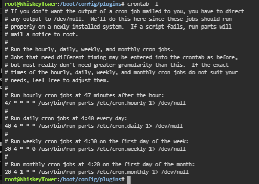

Does this help?
The file I am interested in knowing the contents of is the paritytuning.cron file in the plugin’s folder on the flash drive.  That will have the cron settings that are specific to the plugin.
Here you go:
7 hours ago, whiskeyjr said:
Here you go:
That shows that at the moment the pause IS scheduled for 8:30 at the cron level which explains why the pause happened at 8:30.
unRaid assumes any .cron file present in plugin’s folder contains entries to be added to those for the root user.  This file is regenerated if you make any change to the plugins settings so if you want a different time make a nominal change and hit Apply.   If you now examine the file you should see that the times for pause and resume match your current settings.
My suspicion is that the last time you changed the plugin settings was when there was a syntax error in the underlying script file that stopped this file from being regenerated to match the new settings.

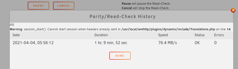

1 hour ago, Marino said:
I use this plugin since it was release. My Disks tend to overheat when not using it while parity check.
But now there is a Problem because it stopped because of the "heat" of the disks which is not true.
All of my disks are configured to 45°C (warning disk temperature threshold) and 55°C (critical disk temperature threshold)
I get the notice:
Parity Check Tuning 02-04-2021 11:00
[SERVER] Pause
Following drives overheated: parity (25°C) disk1 (26°C) disk2 (26°C) disk3 (26°C) disk4 (26°C) disk5 (27°C) disk6 (25°C) disk7 (24°C) disk9 (25°C) parity2 (27°C)
Non-Correcting ParityCheck (0,1%% completed)
The "hottest" disk has a temperature of 27°C (about 80° Fahrenheit). Every single disk in this array has a temperature warning.
The server is on 6.9.1.
I don't understand this warning, because it is not true, so why I get this?
kind ragards
Nils
Not sure why you should get this if on the latest release of the plugin :(
