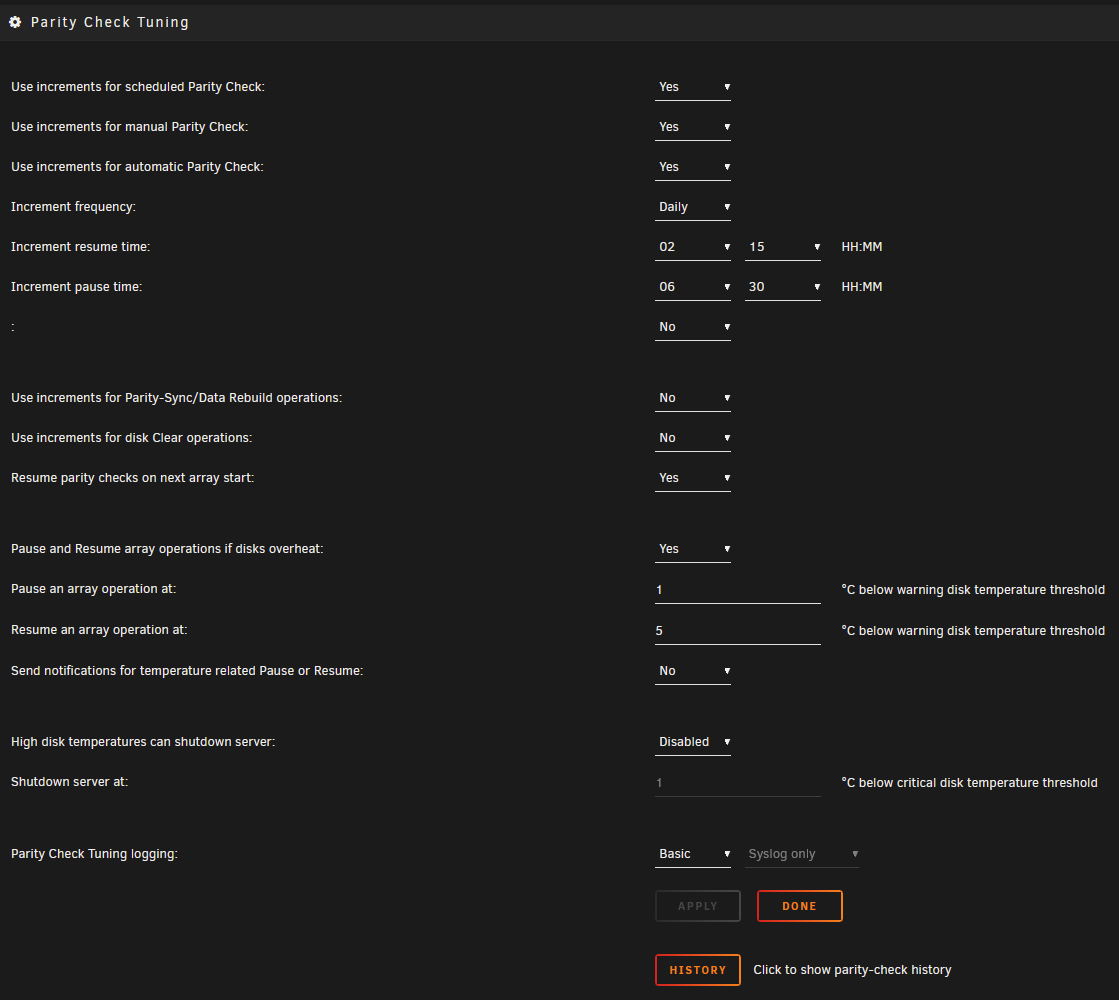

Can I add multiple cron times per pause, resume?
The reason I ask is being once paused and resumed, the resume continues too long where it would normally be paused on the 2nd and 3rd day.
I need to pause, resume, pause, resume to fully complete a check without disturbing primary working times.
Or an option to repeat until check is complete, while maintaining pause time(s).
Pause; 0 2 2 * *, 0 2 3 * *
Resume; 0 7 1 * *, 0 7 2 * *
Edited by sdballer
As you can see that the starting of the WebIU got hugely delayed by this package. The WebUI was only accessible after the automatic parity check got paused. Didn't happened to me before I installed this package.
Here are the syslog + screenshot of the setting:
Spoiler
  Reveal hidden contents

There is no way this plugin would have been the cause of a delay of the sort you describe.   The parity check was initiated automatically by Unraid (not by the plugin which never initiates a parity check) and the plugin took no action until it was time to Pause.
my guess is you had something else going on.   A preclear for instance can cause can cause an apparent ‘hang’ if the GUI is waiting for some disk related action to complete that tries to issue a ‘sync’ at the Linux level as the preclear operation stops the ‘sync’ from completing.
21 minutes ago, itimpi said:
You can set multiple pause/resume times by using the ‘Custom’ option as long as the entry conforms to a rule for a cron entry.   I use this during testing.   However I anticipated the Custom option to be used when you did not want an increment every day for some reason.
However I am not sure from your description why you need multiple times if you only want 1 increment per day.    You rely on the normal schedule for parity checks for when you want the check to start (in other words the plugin does not initiate the check) and then set the Resume time to be before the Pause time so that the Pause happens when you want to use the array for other purposes, and the Resume happens the next day (or late at night).   For instance on my ‘live’ server I have my Resume time set to 11:30 pm with the Pause set to 7:30 am.  That way I get 1 increment of 8 hours per day that runs overnight.
Perhaps you need to give more detail on when you have the check scheduled to be started and when you want checks to be paused and resumed.
When the array automatically starts a parity check, I pause and resume without enough duration to fully complete the check.
Therefore once the resume function starts, it will keep going into the second day during the time when I would want the system to pause. Basically the issue is the initial pause is only a few hours. So I need to check the parity over more than just 1 day, without disrupting high load times with users.
Oh ok. Thought your plugin was intercepting it. But if you said it wouldn't then I will look forward.
Still not clear what the problem is :(    You normally set the Pause time to be before the server load gets high, and then the resume time to be the time during the night after the load has gone down when you want it to resume.
Maybe what you need to provide is the pause and resume times you have set and when you actually want the increments to run.     It is also not clear to me if you are talking about an automatic parity check after an unclean shutdown or a scheduled one (and if scheduled when it is scheduled to run).
it might be worth providing a screen shot of the settings you have (or a copy of the ‘parity.check.tuning.cfg’ file from the plugins folder on the flash drive).    It might also be worth mentioning which UnRaid release you are running.

5 hours ago, Defuse said:
Under Parity Check Tuning in settings I am getting this warning.
Warning: session_start(): Cannot start session when headers already sent in /usr/local/emhttp/plugins/parity.check.tuning/parity.check.tuning.helpers.php on line 117
Although I can see why such a message might be output I am not seeing it on my system :)  Exactly which version of Unraid are you running?
EDIT:  Reverted the system to 6.9.1 (it was on 6.10.0 rc1) and now see the error you mention which will help with resolving.  I need to see if it also occurs on 6.9.2
It looks as if I might have broken something that affects the display of Settings->Scheduler page on 6.8.3 so that is definitely going to need fixing.  As I can reproduce your symptom I will make sure that is fixed as well.
Thanks for the response. If it helps I am running 6.9.2.
You should now find that the update I pushed out today does not display the warning message,    I checked this release out on 6.8.3, 6.9.2 and 6.10.0 rc2 and they all behaved so hopefully nobody will encounter another problem.
Yep, looks good now. Thank you for the quick fix!
