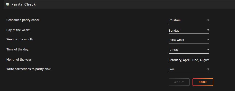

Hello,
My server recently crashed, and I decided to do a parity check manually, I paused the check at about 3% thinking that the Parity Check Tuning will resume the parity at the schedule time (at night) but it never did.
I wonder if the parity check tuning ONLY works with the scheduled time on the parity check settings?
Below are my settings for the normal parity check:
Is there any possibility that you can include the plugin to check manual parity check "start" or "pause", and then continue doing its work at the programmed time? This can be a good feature.
Thanks.

Have you enabled the option in the plug-in settings to apply pause/resume to manually started checks in addition to the automatically started ones?   The default setting is to not do so.
If you have and it is not happening then this is a bug that would need looking at.
My bad, it was set to NO.
Thank you for your time and all the help you bring to this forum!

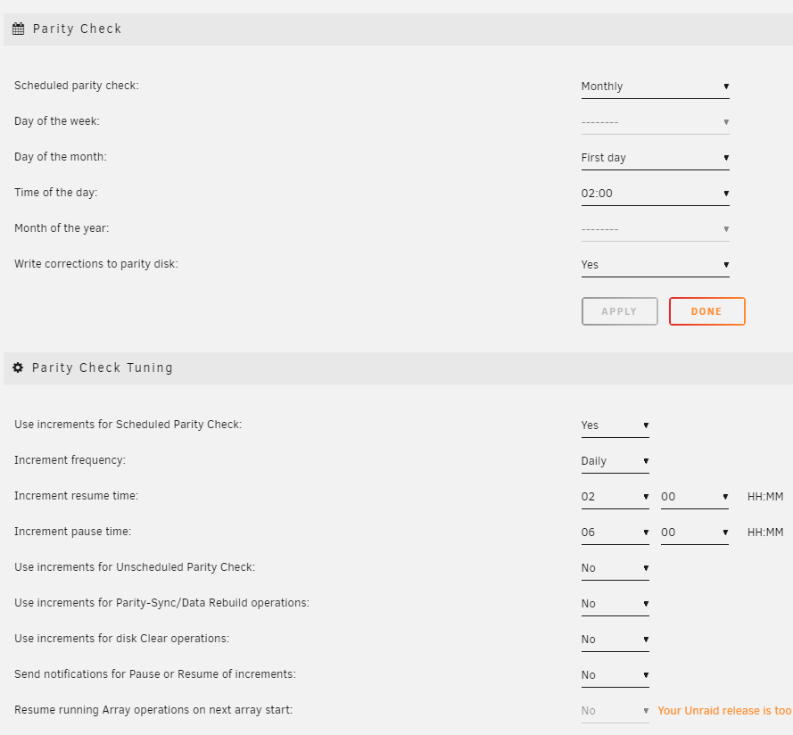

Reporting on some unexpected behavior.
Unraid version 6.8.3
Parity Check Tuning version 2021.01.19
See screenshot for my settings.
What happened
Parity check started early this morning as it was the 1st of the month. However, it's now 9am and the check is still going. I would've expected it to be paused.
This is the first time I've noticed this happening. Since my initial installation of the plugin, I haven't changed its settings. I've always had it set up this way and it's been fine.
Same symptoms here.
I can only get my parity check to pause if i set "Use Increments for Unscheduled Parity Check:" to yes. Despite it being a scheduled event, I'm not sure why it won't pause unless setting this option to yes. I'm on Stable unraid with the latest plugin version.
I will try and work out if there is a reason that checks may not be pausing.    If anyone is able to enable the “Testing” level of logging and can then let me have the syslog covering the period it will give me more to work with.   In addition the various ‘parity.tuning.*’ style files in the plugin’s folder on the flash drive might help.
It is possible I have already inadvertently fixed whatever is causing this behaviour as I have done a major re-factoring of the code internal to the plug-in as part of getting ready to release the first version of what I am calling the “Parity Problems Assistant” option.     This gives the ability to do partial parity checks over a user defined range to help those who get errors reported during parity checks.

Thanks for those files.    I can see from the .cron file that the cron job entry that should have been scheduled for scheduled pause/resume seems to not be present even though the .cfg file shows it is configured at the plugin settings.     This also shows why enabling unscheduled checks “appears” to sort of work as that is being picked up by a monitor task that runs once an hour.   I say “appears” as it would not run exactly at the time set in the settings for pause/resume as it would if the cron entries were correct.
That gives me enough information to make sure that the problem will not be present in my next update.
EDIT:  I have just done a test on my development 6.8.3 system and if you go into the plugin settings and make a change (can then change it back) and hit Apply you should get the correct entries in the parity.tuning.cron file.    If would like to know if that has worked for anyone currently getting unexpected behaviour.

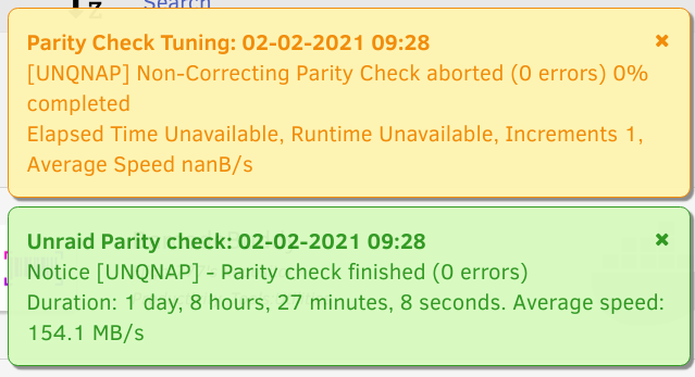

I'm puzzled by the notifications I found on my Dashboard this morning: a report that the parity check has concluded successfully, immediately followed by an error message from Parity Check Tuning that the parity check was aborted. (I am assuming that notifications are stacked newest uppermost.)
My guess is that Parity Check Tuning is assuming that if it is set to run in increments of (say) three hours, any cessation of the parity check short of that time is "an abort". If this is right, unless the whole parity run mod 3 isn't exactly zero we're always going to see this "abort" notice.
Can this be right? Please sanity check the conjecture from a relative newbie.
Chris
Chris
this is much more likely to be a coding in the plugin where it is incorrectly saying it is aborted when it is not!
it is only recently that the plug-in has even tried to generate a message at the end of the parity check.   The idea is that it will be more correct than the Jnraid generated one.    I am trying to stop both notifications coming out but if the plug-in one is misleading it may be better in the short term that they both come out.
I would be interested in some feedback in what the parity history is saying for that particular check.   I think there is a good chance it will actually be correct.

At least in my instance, the parity history looks like it finished the parity check, but also has an aborted message (when it paused). Strange.
