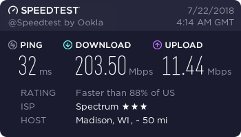

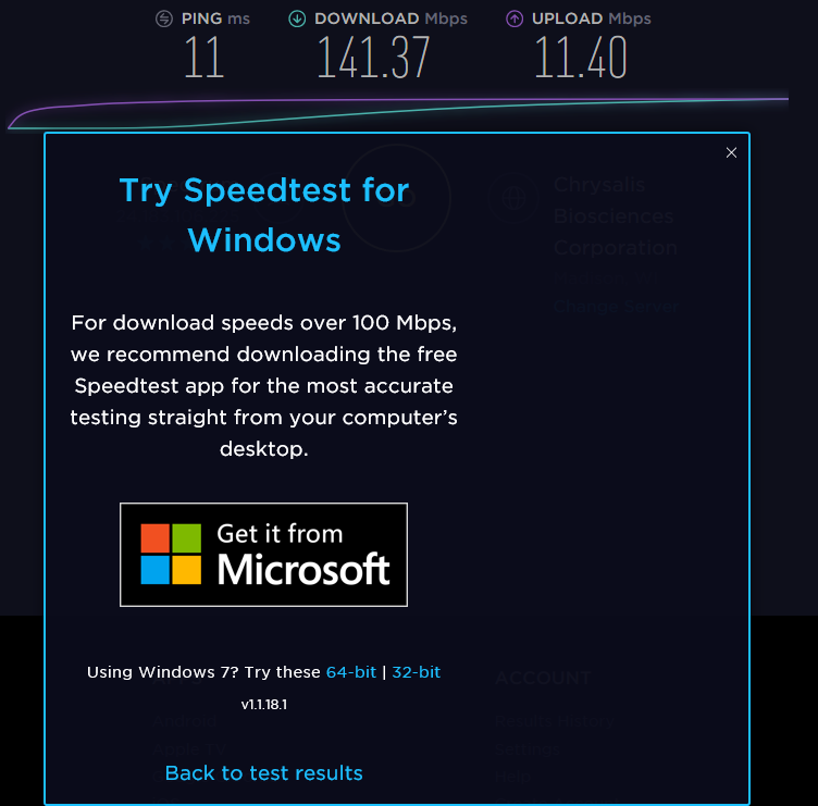

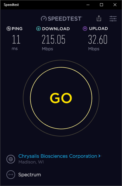

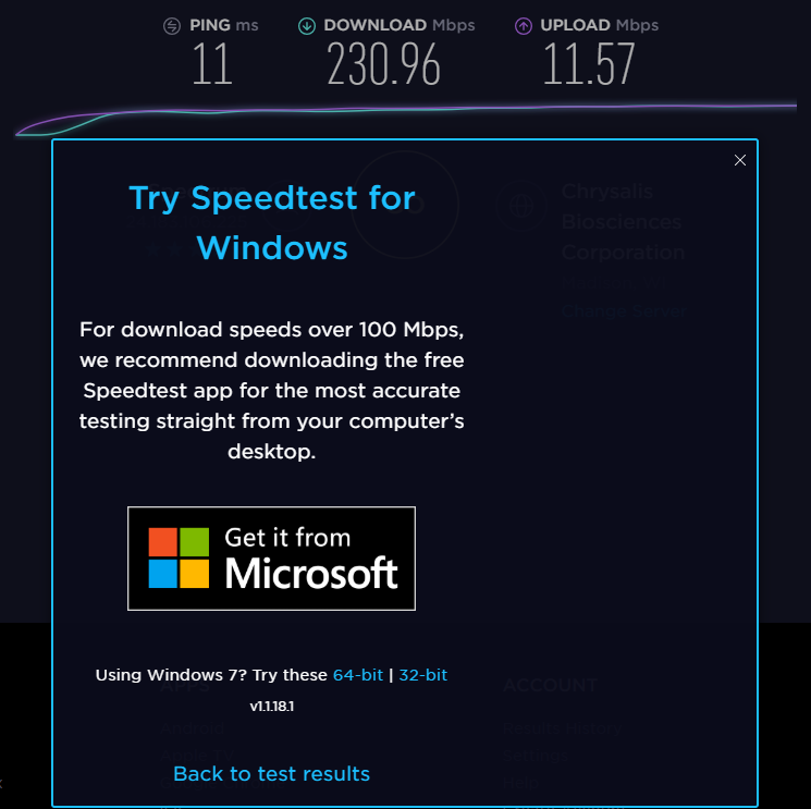

Regarding your Speedtest.net script, I love it, and it has already helped me to troubleshoot some issues with my ISP...
This report doesn't really fall under the heading of "Bug Report", since the script appears to be working very well...  I just wanted to let you know of a possible issue for some...
The results generated by your script, or running SpeedTest.net in either Chrome or Edge all show similar results for my speed, so I suspect they are all running similar versions of the testing script...  However when run in either Chrome or MS Edge it suggests that I download and install the Windows 10 UWP version of the SpeedTest App...  Once installed and run from there, it consistently gets much higher results that are much closer to the speeds told to me by my ISP...
Also for some reason the digiblur script is consistently reporting around 30ms-35ms ping instead of the 11ms ping everything else shows, when they all report they are connecting to the same server...  Minor, just not able to explain it...
Unfortunately my GoogleFu has come up short as to what exactly the difference is between them, and so I am not sure what if anything you can do to adjust the script to be more in line with the way the UWP app does it...
All tests were from the same machine, with digiblur's Script running from the UnRaid Host, and all other results from a Windows 10 VM on the same host...  It is mainly the Upload speed that changes in the app...
I am available for questions or testing if needed ?
digiblur's UnRaid Script ResultChrome ResultsMS Edge ResultsWindows 10 UWP App Results
Edited by Warrentheo

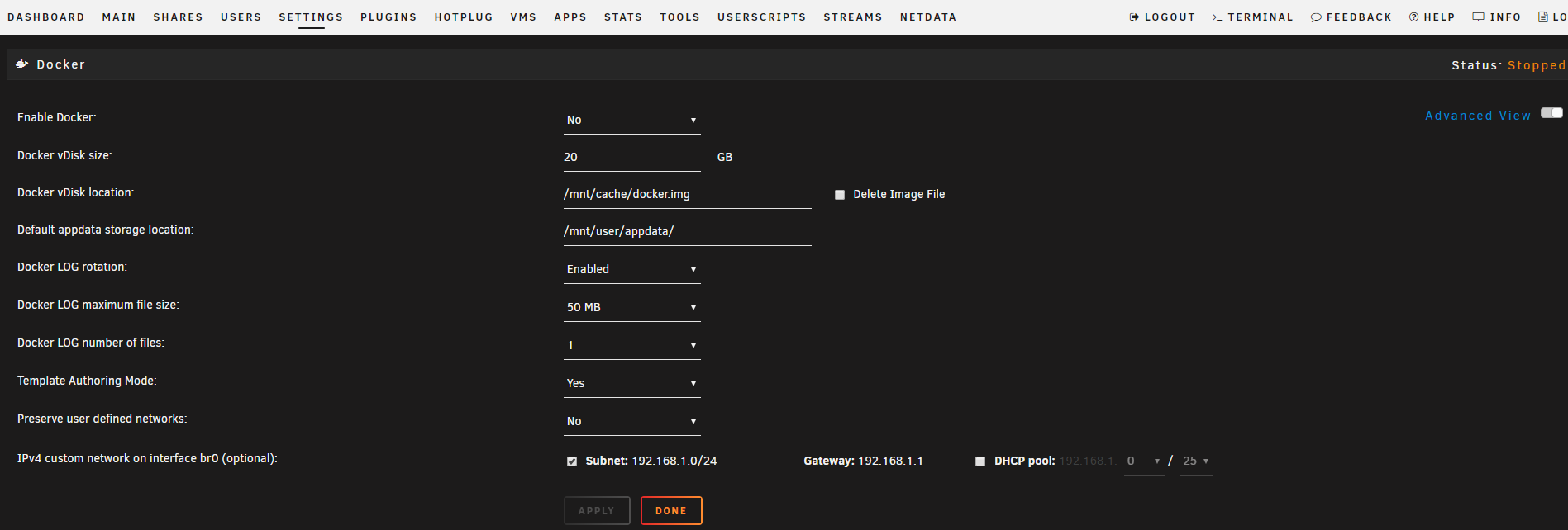

I don't know if any body else is having this issue but UNMS keeps growing the log size and filling up my Docker image. Is there any way to prevent this? I've gone through the app and removed the backups and downloaded firmware but it continues to keep growing. What is causing this?
@Squid
I checked those settings and everything is set correctly. Image is still at 77%.
Edited by nickro8303

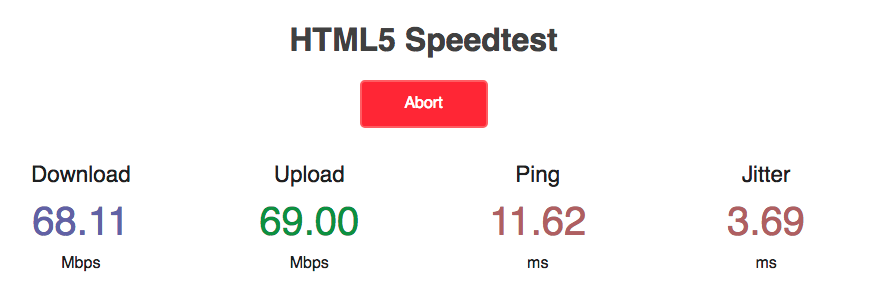

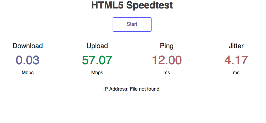

Anyone know how to feed the speedtest docker through the linuxserver/letsencrypt docker? I'd like to be able to have remote plex users run a speedtest to my server.
here's my nginx config:
location /speedtest {
                proxy_pass              http://10.X.X.X:6580;
                proxy_set_header        Host            $http_host;
                proxy_set_header        X-Forwarded-For $proxy_add_x_forwarded_for;
                proxy_set_header        X-Scheme        $scheme;
I'm getting "ERR_CONNECTION_REFUSED" in chrome with my puny attempt to pass it through.
Edit:
I was not connecting to my https port. DUrrr. It still doesn't work right.
Through nginx:
image.png.7927a010113e631ba43b6c12d05a0155.pngScreen Shot 2018-11-23 at 7.21.54 PM
Directly to the docker (IP Address field works correctly, I just missed it in the screenshot)
image.png.b02b4f0e3ebd9bc1ffbbb2b99eaa0bcb.pngScreen Shot 2018-11-23 at 7.23.17 PM
apologies if this is the wrong place to post.
Edited by ndaringer
