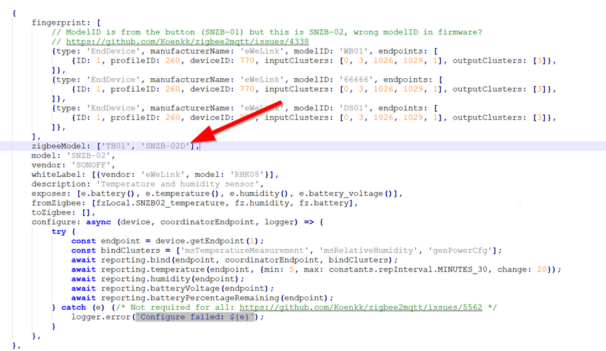

Hello everyone,
I've a question regarding Zigbee2MQTT.
As I searched in the network how to custom configure some parameters, I always found they should be inside the configuration.yml
There you should see something like this for your devices:
Unfortunately in my configuration.yml I can only see this:
Probably I'm looking at the wrong file pheraps... but where is the file where you can configure the whole things?
Thank you in advice! 🙂

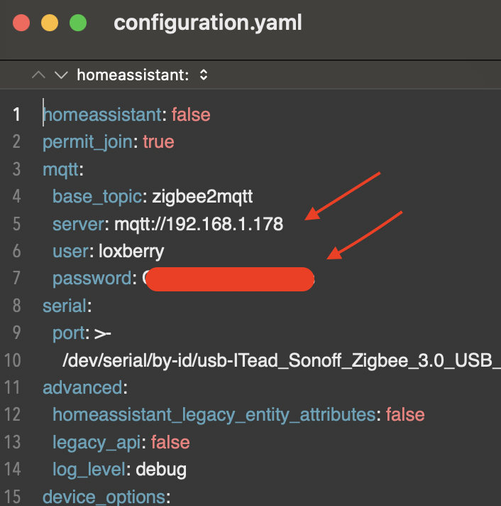

Hi guys,
I've got a strange problem.
My current setup works fine but I have to switch my MQTT-server.
Therefore I download the configuration.yaml and changed the IP and the password. Then I uploaded the file and set the right permissions.
But then the docker will start but I can't enter into the webinterface anymore
Any idea where my fault is?
Thank you.

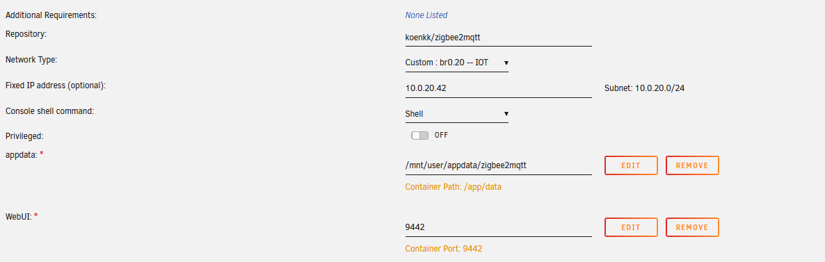

So I am running zigbee2mqtt on my IOT network and when I assign it a static IP there, the front end port mapping doesn't work.
If I leave it on br0, then it works fine.
Anyone have any thoughts on why?
