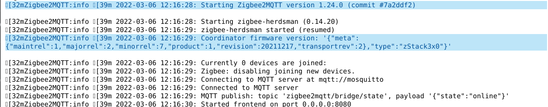

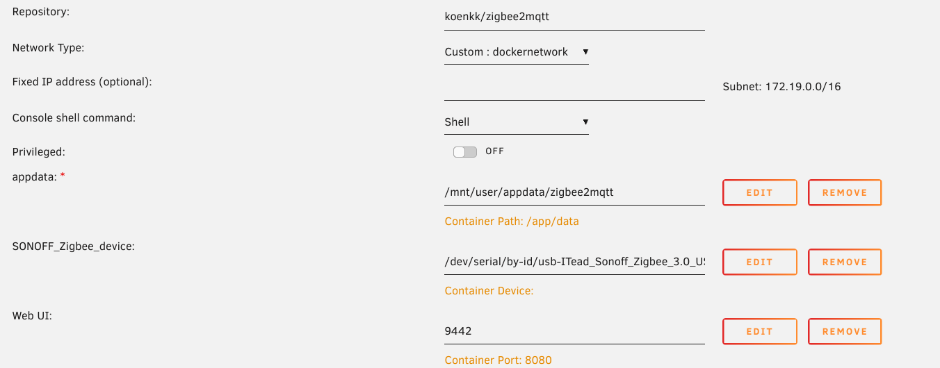

Hello
I am trying to set up zigbee2mqtt but having issues connecting to Web frondend. Both mosquitto broker and zigbee2mqtt has verified the connection.
Frontend have started on 0.0.0.0:8080 and I have forwarded port in docker configuration. I just can't figure out what I am missing....
What to do?
EDIT: uploaded screenshots
Edited by thostr

On 3/6/2022 at 5:43 AM, thostr said:
Hello
What to do?
Try adding this one your yaml.
frontend:
port: 9442
