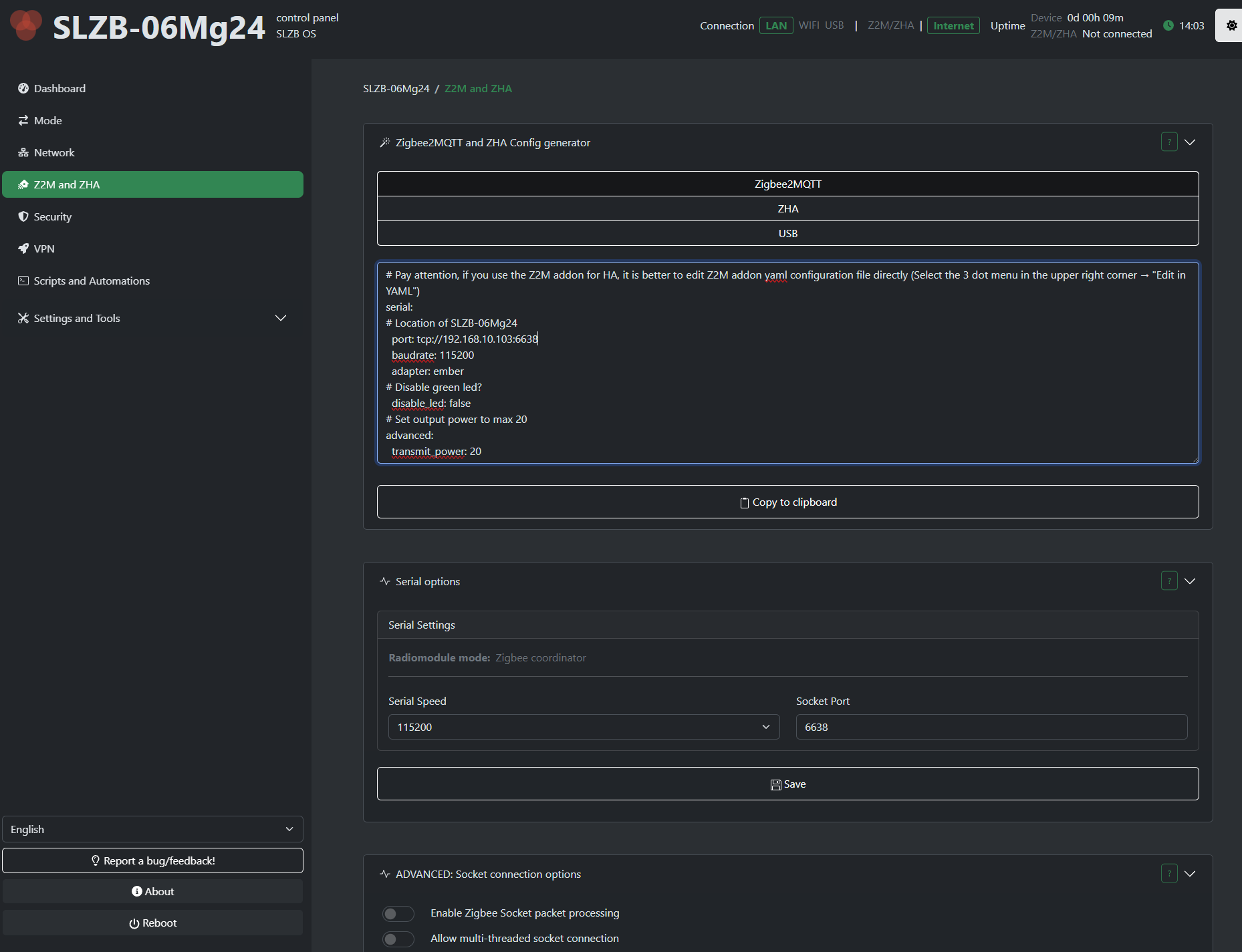

  6. Ahh got it working, there needs to be the MQTT server which gets the data, i thought it should be the Zigbee Adapter Then also user / pass had to be added. version: 4 homeassistant: enabled: false frontend: enabled: true mqtt: base_topic: zigbee2mqtt server: mqtt://192.168.10.102:1883 user: XXX password: XXX serial: # Location of SLZB-06Mg24 port: tcp://192.168.10.103:6638 baudrate: 115200 adapter: ember # Disable green led? disable_led: false # Set output power to max 20 advanced: transmit_power: 20 network_key: - 119 - 193 - 155 - 54 - 113 - 239 - 241 - 185 - 191 - 133 - 219 - 138 - 118 - 114 - 49 - 29 pan_id: 44735 ext_pan_id: - 0 - 105 - 120 - 49 - 88 - 159 - 172 - 36

  9. Did this do i need to change something also here? mqtt: base_topic: zigbee2mqtt server: mqtt://localhost version: 4 homeassistant: enabled: false frontend: enabled: true mqtt: base_topic: zigbee2mqtt server: mqtt://localhost serial: # Location of SLZB-06Mg24 port: tcp://192.168.10.103:6638 baudrate: 115200 adapter: ember # Disable green led? disable_led: false # Set output power to max 20 advanced: transmit_power: 20 network_key: - 119 - 193 - 155 - 54 - 113 - 239 - 241 - 185 - 191 - 133 - 219 - 138 - 118 - 114 - 49 - 29 pan_id: 44735 ext_pan_id: - 0 - 105 - 120 - 49 - 88 - 159 - 172 - 36 Getting this in LOG and not starting yet: Using '/app/data' as data directory Starting Zigbee2MQTT without watchdog. [2025-03-28 14:24:45] info: z2m: Logging to console, file (filename: log.log) [2025-03-28 14:24:45] info: z2m: Starting Zigbee2MQTT version 2.1.3 (commit #ba337bd329aeb4ca17735c0cf09b31293c8cff06) [2025-03-28 14:24:45] info: z2m: Starting zigbee-herdsman (3.2.7) [2025-03-28 14:24:45] info: zh:ember: Using default stack config. [2025-03-28 14:24:45] info: zh:ember: ======== Ember Adapter Starting ======== [2025-03-28 14:24:45] info: zh:ember:ezsp: ======== EZSP starting ======== [2025-03-28 14:24:45] info: zh:ember:uart:ash: ======== ASH Adapter reset ======== [2025-03-28 14:24:45] info: zh:ember:uart:ash: Socket ready [2025-03-28 14:24:45] info: zh:ember:uart:ash: ======== ASH starting ======== [2025-03-28 14:24:47] info: zh:ember:uart:ash: ======== ASH connected ======== [2025-03-28 14:24:47] info: zh:ember:uart:ash: ======== ASH started ======== [2025-03-28 14:24:47] info: zh:ember:ezsp: ======== EZSP started ======== [2025-03-28 14:24:47] info: zh:ember: Adapter EZSP protocol version (14) lower than Host. Switched. [2025-03-28 14:24:47] info: zh:ember: Adapter version info: {"ezsp":14,"revision":"8.0.2 [GA]","build":397,"major":8,"minor":0,"patch":2,"special":0,"type":170} [2025-03-28 14:24:47] info: zh:ember: [STACK STATUS] Network up. [2025-03-28 14:24:48] info: zh:ember: [INIT TC] Adapter network matches config. [2025-03-28 14:24:48] info: zh:ember: [CONCENTRATOR] Started source route discovery. 1246ms until next broadcast. [2025-03-28 14:24:48] info: z2m: zigbee-herdsman started (resumed) [2025-03-28 14:24:48] info: z2m: Coordinator firmware version: '{"meta":{"build":397,"ezsp":14,"major":8,"minor":0,"patch":2,"revision":"8.0.2 [GA]","special":0,"type":170},"type":"EmberZNet"}' [2025-03-28 14:24:48] info: z2m: Currently 0 devices are joined. [2025-03-28 14:24:48] info: z2m: Connecting to MQTT server at mqtt://localhost [2025-03-28 14:24:48] error: z2m: MQTT failed to connect, exiting... () [2025-03-28 14:24:48] info: z2m: Stopping zigbee-herdsman... [2025-03-28 14:24:48] info: zh:controller: Wrote coordinator backup to '/app/data/coordinator_backup.json' [2025-03-28 14:24:48] info: zh:ember:uart:ash: ASH COUNTERS since last clear: [2025-03-28 14:24:48] info: zh:ember:uart:ash: Total frames: RX=47, TX=92 [2025-03-28 14:24:48] info: zh:ember:uart:ash: Cancelled : RX=0, TX=0 [2025-03-28 14:24:48] info: zh:ember:uart:ash: DATA frames : RX=46, TX=44 [2025-03-28 14:24:48] info: zh:ember:uart:ash: DATA bytes : RX=638, TX=481 [2025-03-28 14:24:48] info: zh:ember:uart:ash: Retry frames: RX=0, TX=0 [2025-03-28 14:24:48] info: zh:ember:uart:ash: ACK frames : RX=0, TX=47 [2025-03-28 14:24:48] info: zh:ember:uart:ash: NAK frames : RX=0, TX=0 [2025-03-28 14:24:48] info: zh:ember:uart:ash: nRdy frames : RX=0, TX=0 [2025-03-28 14:24:48] info: zh:ember:uart:ash: CRC errors : RX=0 [2025-03-28 14:24:48] info: zh:ember:uart:ash: Comm errors : RX=0 [2025-03-28 14:24:48] info: zh:ember:uart:ash: Length < minimum: RX=0 [2025-03-28 14:24:48] info: zh:ember:uart:ash: Length > maximum: RX=0 [2025-03-28 14:24:48] info: zh:ember:uart:ash: Bad controls : RX=0 [2025-03-28 14:24:48] info: zh:ember:uart:ash: Bad lengths : RX=0 [2025-03-28 14:24:48] info: zh:ember:uart:ash: Bad ACK numbers : RX=0 [2025-03-28 14:24:48] info: zh:ember:uart:ash: Out of buffers : RX=0 [2025-03-28 14:24:48] info: zh:ember:uart:ash: Retry dupes : RX=0 [2025-03-28 14:24:48] info: zh:ember:uart:ash: Out of sequence : RX=0 [2025-03-28 14:24:48] info: zh:ember:uart:ash: ACK timeouts : RX=0 [2025-03-28 14:24:48] info: zh:ember:uart:ash: ======== ASH stopped ======== [2025-03-28 14:24:48] info: zh:ember:ezsp: ======== EZSP stopped ======== [2025-03-28 14:24:48] info: zh:ember: ======== Ember Adapter Stopped ======== [2025-03-28 14:24:48] info: z2m: Stopped zigbee-herdsman ** Press ANY KEY to close this window **
  10. I left all as default. sorry for Noob questions, doing it 1st time Ahh so not "inside docker" it self, but in here : \\UNRAIDTOWER\appdata\zigbee2mqtt\configuration.yaml This is the configuration.yaml content version: 4 homeassistant: enabled: false frontend: enabled: true mqtt: base_topic: zigbee2mqtt server: mqtt://localhost advanced: network_key: - 119 - 193 - 155 - 54 - 113 - 239 - 241 - 185 - 191 - 133 - 219 - 138 - 118 - 114 - 49 - 29 pan_id: 44735 ext_pan_id: - 0 - 105 - 120 - 49 - 88 - 159 - 172 - 36 This is what I found in WebUI, where should i put it configuration.yaml? In the top? or doesn't matter? # Pay attention, if you use the Z2M addon for HA, it is better to edit Z2M addon yaml configuration file directly (Select the 3 dot menu in the upper right corner → "Edit in YAML") serial: # Location of SLZB-06Mg24 port: tcp://192.168.10.103:6638 baudrate: 115200 adapter: ember # Disable green led? disable_led: false # Set output power to max 20 advanced: transmit_power: 20
  11. any guide somewhere how / where is the config in docker? thanks
  12. Hi, Seems like i'm having similar issue as above, but i'm using "SLZB-06Mg24" which is an "network server" not a USB device. https://www.zigbee2mqtt.io/guide/adapters/emberznet.html I should add: "adapter: ember" But not sure where / how to enter the config file Starting Zigbee2MQTT without watchdog. [2025-03-27 13:23:41] info: z2m: Logging to console, file (filename: log.log) [2025-03-27 13:23:41] info: z2m: Starting Zigbee2MQTT version 2.1.3 (commit #ba337bd329aeb4ca17735c0cf09b31293c8cff06) [2025-03-27 13:23:41] info: z2m: Starting zigbee-herdsman (3.2.7) [2025-03-27 13:23:42] error: z2m: Error while starting zigbee-herdsman [2025-03-27 13:23:42] error: z2m: Failed to start zigbee-herdsman [2025-03-27 13:23:42] error: z2m: Check https://www.zigbee2mqtt.io/guide/installation/20_zigbee2mqtt-fails-to-start_crashes-runtime.html for possible solutions [2025-03-27 13:23:42] error: z2m: Exiting... [2025-03-27 13:23:42] error: z2m: Error: USB adapter discovery error (No valid USB adapter found). Specify valid 'adapter' and 'port' in your configuration. at discoverAdapter (/app/node_modules/.pnpm/[email protected]/node_modules/zigbee-herdsman/src/adapter/adapterDiscovery.ts:523:15) at processTicksAndRejections (node:internal/process/task_queues:105:5) at Function.create (/app/node_modules/.pnpm/[email protected]/node_modules/zigbee-herdsman/src/adapter/adapter.ts:68:33) at Controller.start (/app/node_modules/.pnpm/[email protected]/node_modules/zigbee-herdsman/src/controller/controller.ts:132:24) at Zigbee.start (/app/lib/zigbee.ts:69:27) at Controller.start (/app/lib/controller.ts:142:13) at start (/app/index.js:161:5) [2025-03-27 13:23:42] error: z2m: If this happens after updating to Zigbee2MQTT 2.0.0, see https://github.com/Koenkk/zigbee2mqtt/discussions/24364 Using '/app/data' as data directory Starting Zigbee2MQTT without watchdog. [2025-03-27 15:59:12] info: z2m: Logging to console, file (filename: log.log) [2025-03-27 15:59:12] info: z2m: Starting Zigbee2MQTT version 2.1.3 (commit #ba337bd329aeb4ca17735c0cf09b31293c8cff06) [2025-03-27 15:59:12] info: z2m: Starting zigbee-herdsman (3.2.7) [2025-03-27 15:59:13] error: z2m: Error while starting zigbee-herdsman [2025-03-27 15:59:13] error: z2m: Failed to start zigbee-herdsman [2025-03-27 15:59:13] error: z2m: Check https://www.zigbee2mqtt.io/guide/installation/20_zigbee2mqtt-fails-to-start_crashes-runtime.html for possible solutions [2025-03-27 15:59:13] error: z2m: Exiting... [2025-03-27 15:59:13] error: z2m: Error: USB adapter discovery error (No valid USB adapter found). Specify valid 'adapter' and 'port' in your configuration. at discoverAdapter (/app/node_modules/.pnpm/[email protected]/node_modules/zigbee-herdsman/src/adapter/adapterDiscovery.ts:523:15) at processTicksAndRejections (node:internal/process/task_queues:105:5) at Function.create (/app/node_modules/.pnpm/[email protected]/node_modules/zigbee-herdsman/src/adapter/adapter.ts:68:33) at Controller.start (/app/node_modules/.pnpm/[email protected]/node_modules/zigbee-herdsman/src/controller/controller.ts:132:24) at Zigbee.start (/app/lib/zigbee.ts:69:27) at Controller.start (/app/lib/controller.ts:142:13) at start (/app/index.js:161:5) [2025-03-27 15:59:13] error: z2m: If this happens after updating to Zigbee2MQTT 2.0.0, see https://github.com/Koenkk/zigbee2mqtt/discussions/24364 ** Press ANY KEY to close this window **

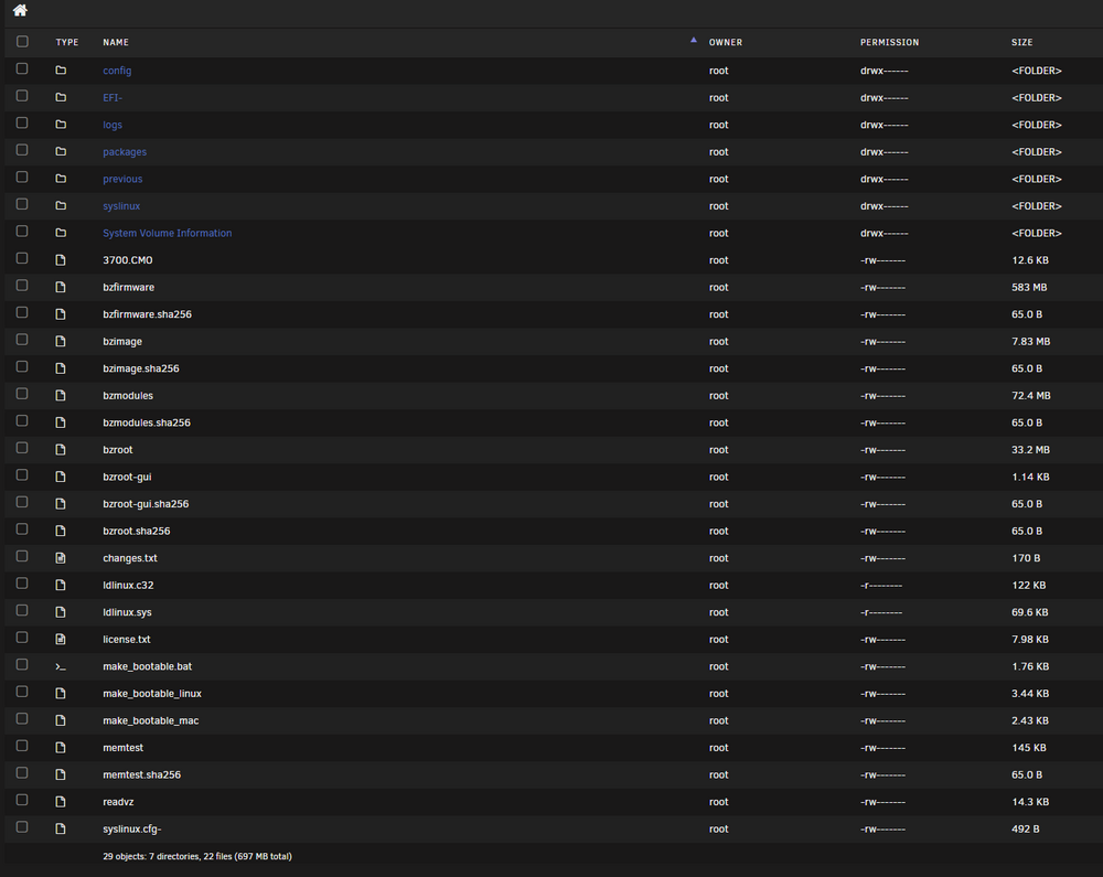

  13. thanks for tip, I've removed "previous" and it went fine. Let's see what next update brings, but I would need to find some 8GB USB drive to be ready for size upgrade. Just need to check about the "license key" details, how to attach it to new drive.
  14. cleaned some logs ~100mb, now i have around 320mb free space only big is "previous" folder
  15. If I recall right I do not use it for anything else then unraid OS, is there some "cleanup" tool or such? As no clue what can be removed
