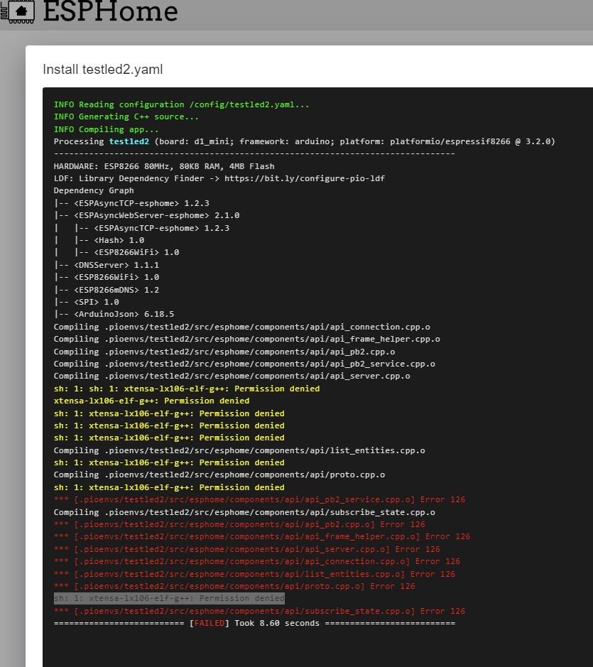

i am getting the following with latest unraid, latest home assistant and latest esphome
Edited by heisenberg
if anyone has any ideas on this.
tried reinstalling esp home and no go.
